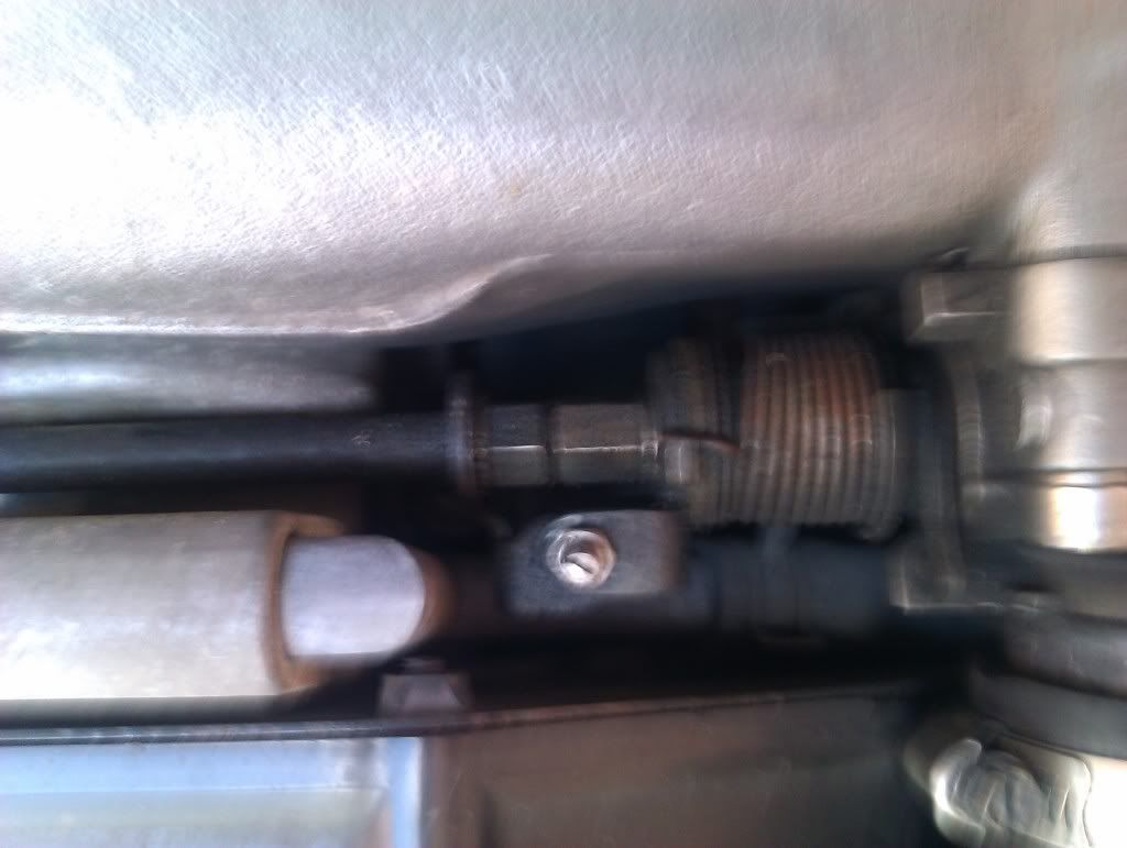

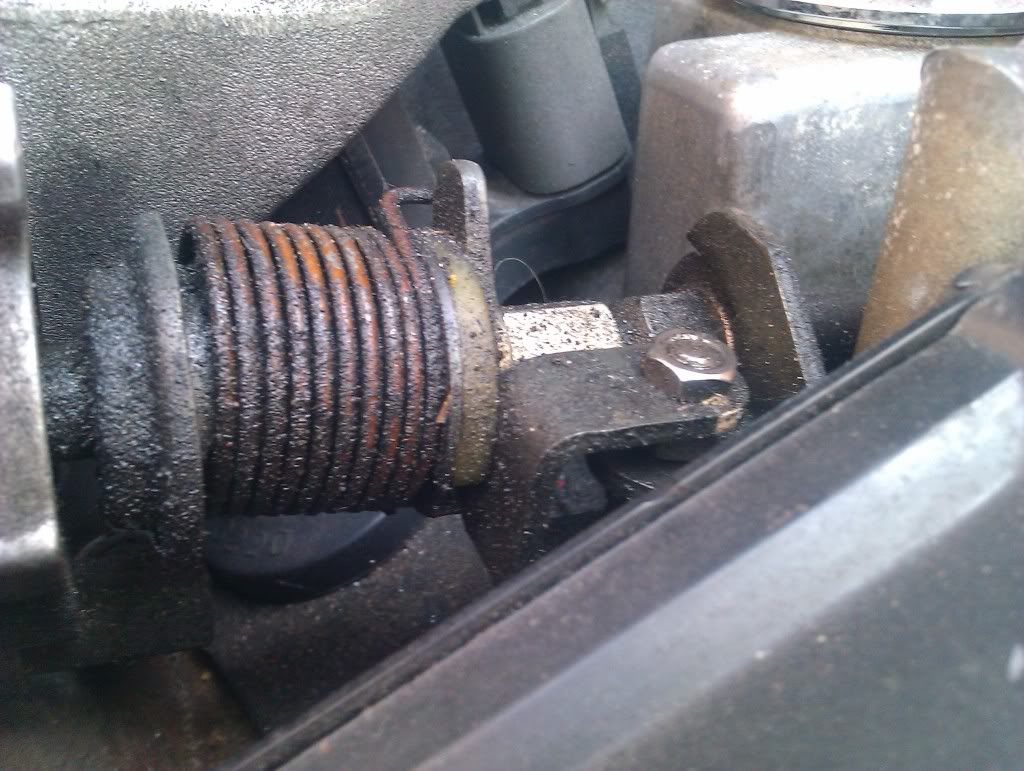

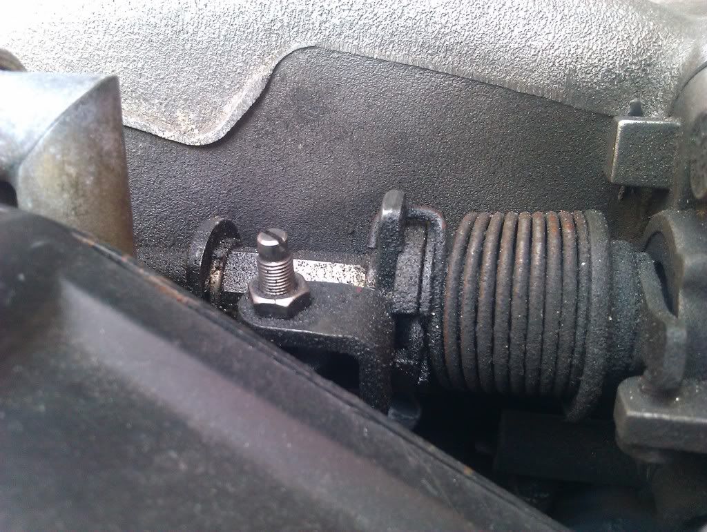

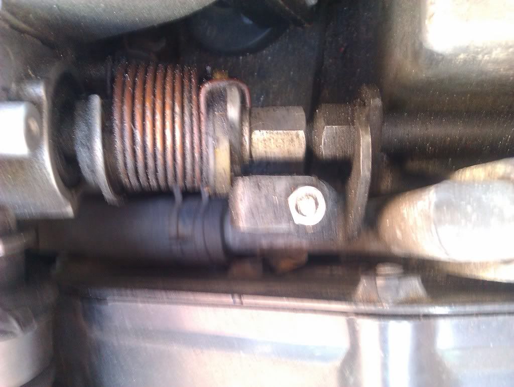

couple of weeks/months ago i was having some problems with my idle and with the car stuttering at low speeds. after a trip to zedworld Jeff sorted it right out stating that my throttle was misaligned so one bank was getting more fuel than the other. well couple of weeks later the same problem seems to have returned, the revs are all over the place at idle and it is starting to stutter occasionally again.
so i decided to take some photo's, not sure if this is what they looked like after the trip to zedworld or if they've somehow adjusted themselves again. but how the hell do i know what they should be and how to adjust it.

You have to take the intake pipes off so that you can see the butterflys inside the throttle body, then you can judge whether they are both in the same position and open at the same time/when you open the throttle. If they don't you can adjust it using those screws in your pictures
