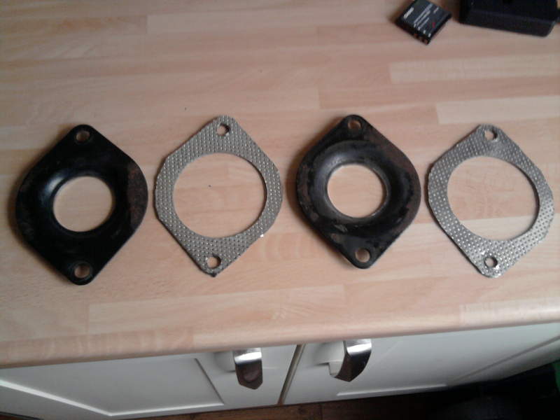

the plates sit on top of the shock between shock and arch . i dropped mine a while back but tomorrow im going to be lifting it up about 7mm on the front with 2 extra plates on both sides . these had to be modified because they will not sit one on top of the other due to their shape . ive also got longer studs for my shocks to allow for this .
did you buy or fabricate these yourself? i suppose its no different to what 4x4 guys do to jack up the body lol
i got extra spacers and had the centres bored out about 10mm extra and used cat exhaust gasket to place between the spacers to give a good solid plate
where did you get them from? anyone else got anything to add to help?
here you go mate . pic showing shock plate and spacers made from cat exhaust gasket . the gasket is available from most decent car spares shops . i got a piece measuring about 18 inches x 12 inches for about a fiver . easily big enough to make 6 spacers . used tin snips and a cup cutter . beware of the edges as its like razor blades when you cut it
ah cheers for that man, only need to deal with the clearance issues etc now....
