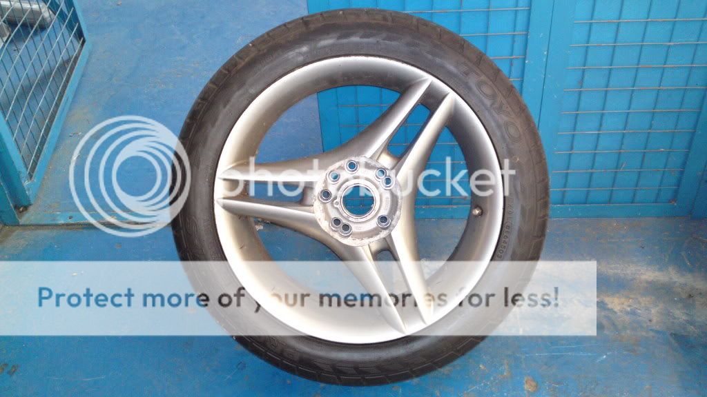

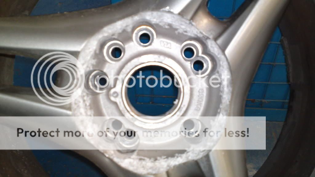

4 stud drilled to 5 stud
Came across these wheels from a mates garage and I was seriously scared when I took off the centre caps:death:

I aint mate. I would not put these on my hubs cos you could never be 100%sure of when the ally thread wall is going to crumble....
These alloys are going straight down the scappy to be weighed in once i get those fresh toyo's off!
Talk about over reaction. This type of arrangement is very common and there's nothing wrong with it at all.

Just my opinion mate! And would anyone really want these nasty three spokers anyway???
seeing them in the flesh im with kinugawa turbo, the pics do not do the savage work justice, definately some back yard work done here, even the centre cap section is totally distorted in shape, (hard to see in the pics)

To right coolq! Would you run 500bhp through these, I know i wouldn't.....

mate, i wouldnt run them on my push bike LOL , some people on here loose perspective sometimes and just go on a rant. seeing them in the flesh its like W T F.......

I too fail to see whats wrong with them, many of the wolfrace wheels and tsw are available in multi fitment with sometimes more holes than that

its hard to tell from the pics, he shared them as viewing pleasure of some of the disgusting work people do, but we shouldnt start a who cares who doesnt war, simply the wheels are awful and drilled DIY. look very risky in real life which i cant stress enough.
for the sake of 3-4 hundred quid, a new set of wheel will always be better, yes some wheels do come in 4/5 stud fitment, but these arent those, these are ' oh shit ive got 4 stud wheels and my car's 5 stud........ hmmmm i know let me drill some more holes into them jobbies':innocent:
