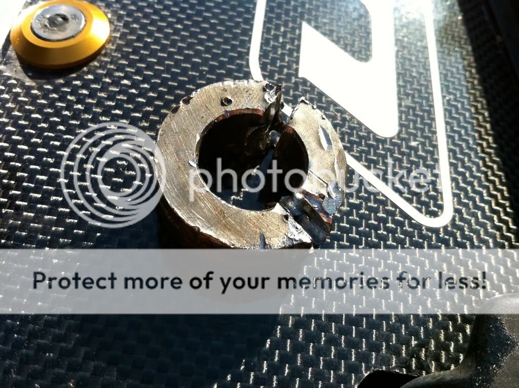

You WILL need to put a bearing in or adapter as it's called and it looks like this only the one I suggest you put in should be in slightly better condition. Call mike feeney at mjp and order one.
thats the auto spigot bearing i was on about, i call it that as then people know what im on about lol

the spigot bearing is a small copper type washer, not sure on the exact name of the auto equivalent, but its a mahoosive looking thing and a pain in the ass to get out, but you will need the auto version if your putting a auto box on matey.

isent the one he needs for the auto standard in the crank? then if it was going to be used for a amnual engine they simply put the spigot bush into the crank???
it is standard mate, in the auto engine :lol: The manual one will need changing.
