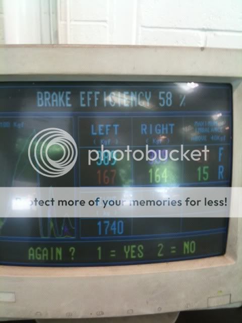

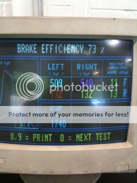

LOL! I actually just carried out a before & after test the other day when I upgraded to my brembos!
Before:
After:
brakes were cold at both tests & not bedded in for the after results but gives you some idea of braking force increase! :)
Before:
After:
Apparently your car weighs 1740kgs. I hope that isn't true - if my car weighs that much I'm selling it.. Thought they were supposed to be 1560kgs or thereabouts? :offtopic:
