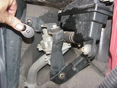

I dont think its electrical. Behind the passenger side of the dash, you have the Ac unit, could have air trapped or needs regassing.
You did say it only made the noise when driving?
The reason i mentioned gurgling, although i should have been a bit clearer with the description, you can get water trapped in the aiv tanks
drvr~AIV~in~situ.jpg9
Try and see if you can record the sound and post it up, especially if you think its electrical, apart from alarm system as suggested it could be a new one to file in the faq section
