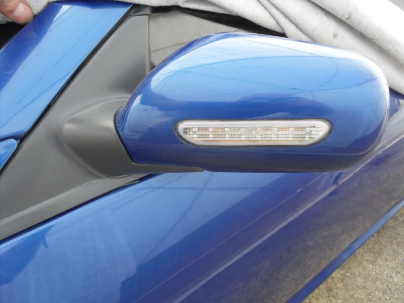

One pic? oooh you tease:lol::lol: would like a closer look at the wing mirror indicators :yes:

OK just for you Graham , lol

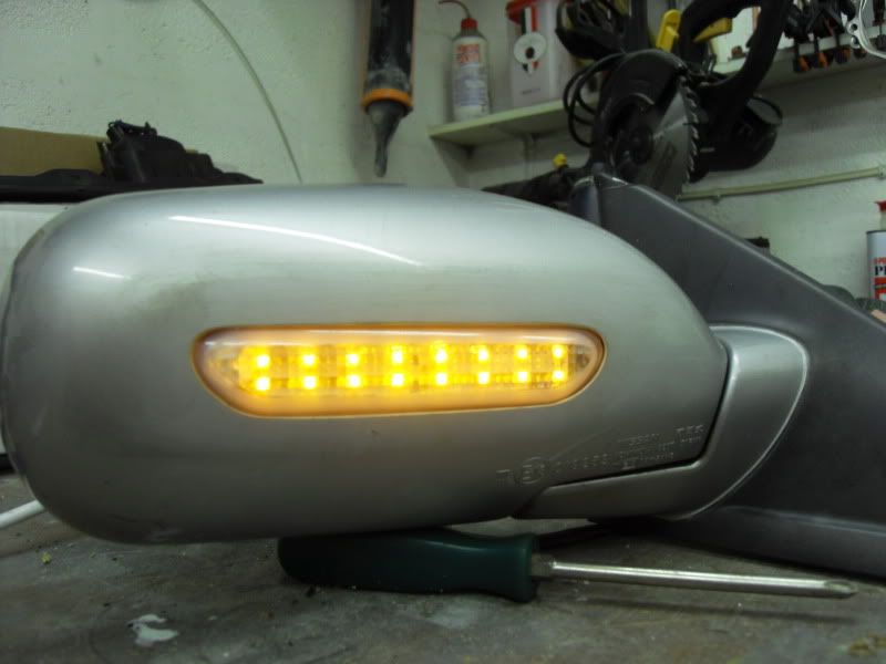

They,re just a pair of the ones that you,re suposed to stick on the outside of the mirror which looks 5hit so i cut a hole and used a hot melt glue gun to stick them on the inside and now they,re painted i,ve sealed them with a bit of sikaflex . :wink:

Got something like that to do on mine, but they wrap around the corner of the mirror housing. Yours look good.

Lovely mate, really nice and i like the little touch of doing the mirror base the same colour as the back plate, looks neater than trying to mask around the bugger lol
