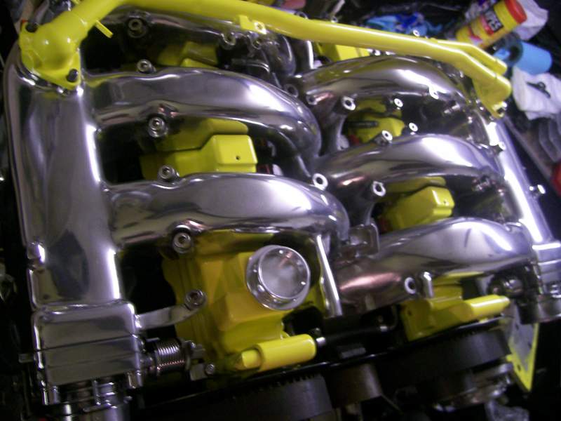

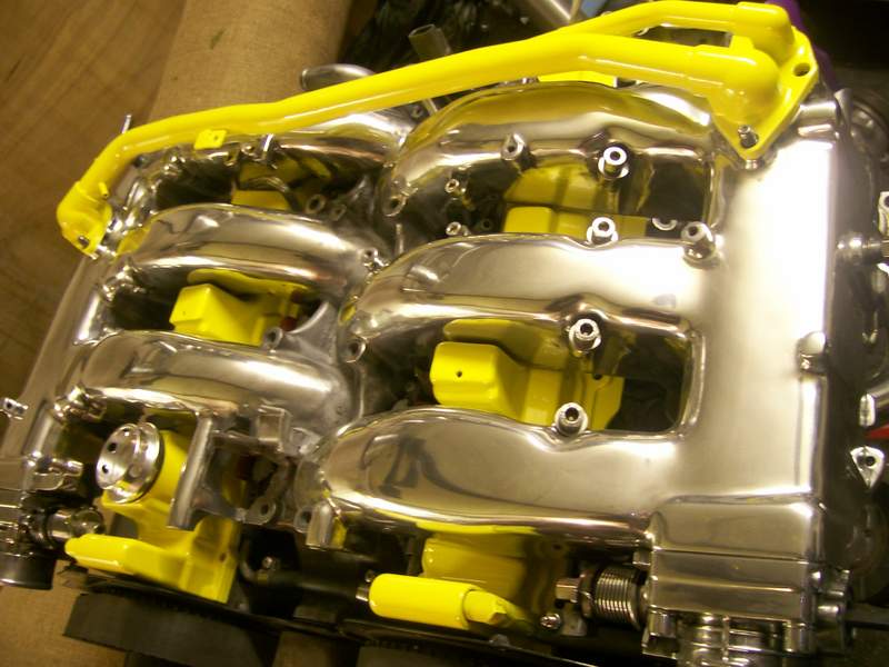

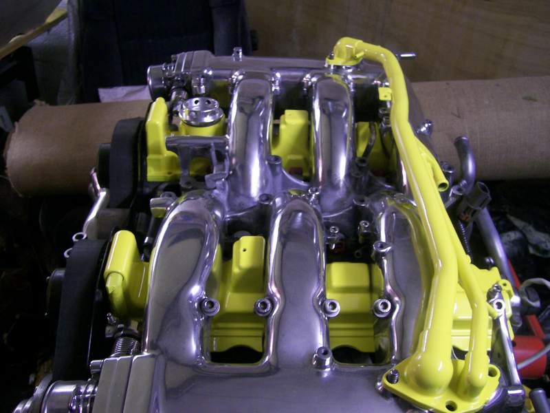

And painted:

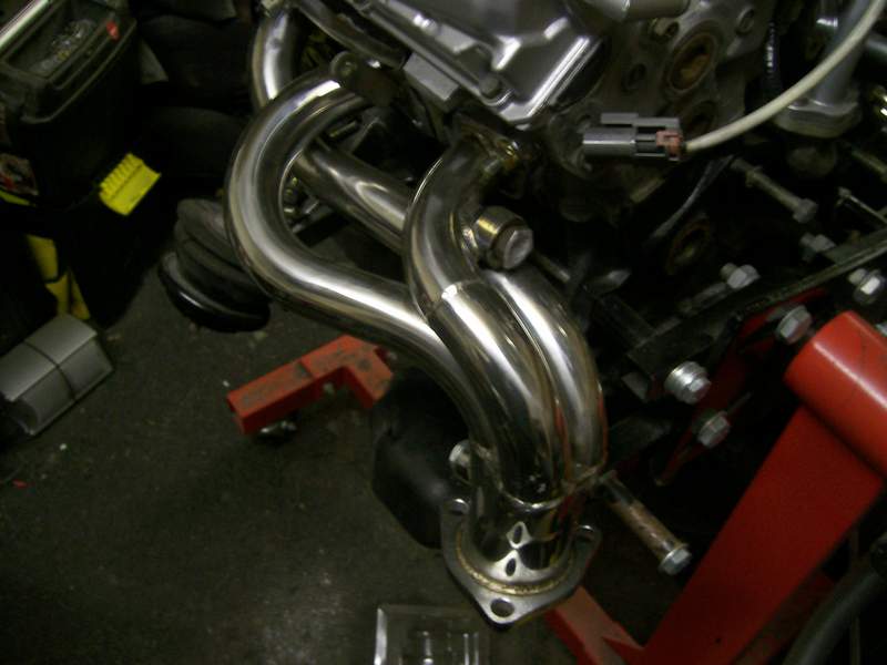

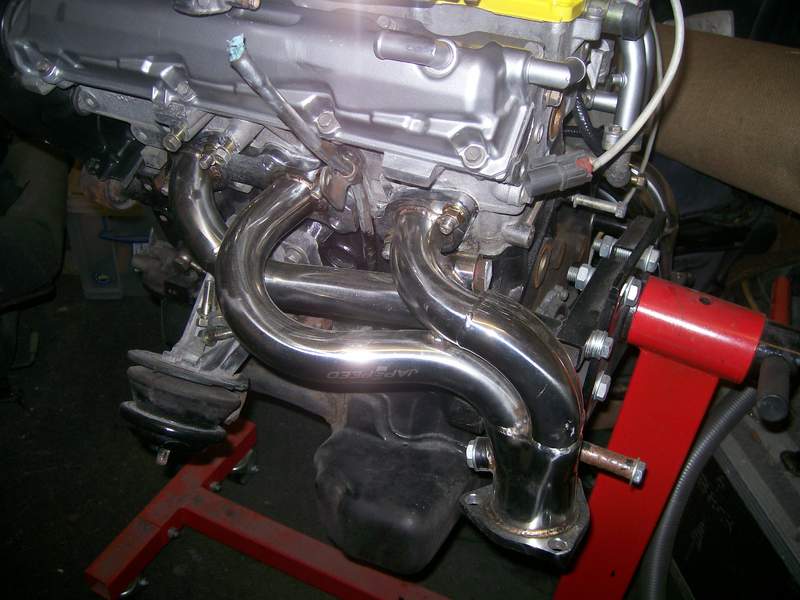

And got my japspeed manifolds fitted, although still have to get the drivers side O2 sensor hole moved:yes:

Looks fantastic Graham! :bow:
Did you polish the plenum yourself, or send it off? it looks awesome!
Cheers guys, i polished the plenum myself. It will get another quick final buff when i bolt it all back together, everything is just laid on for the minute to see how it will look. When im happy it will all be bolted, using polished allen bolts for everything visible.
My plenum is off at the mo for a water bypass, would love to polish it whilst its off but looks like a mega mission! How long did it take you and what did you use?
Took about 30-40 hours over a period of a few weeks. Being a lazy git, i used everything machine based i could, to make it quicker or less tedius from a power file to an orbital sander using different grades, then onto wheels, course to polishing mops.
