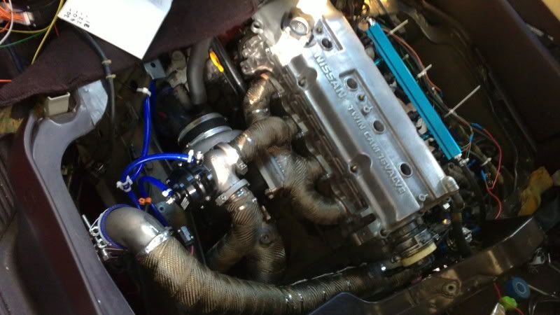

Don't laugh but i have a Nissan Largo, i would like to know if there is anything on the market to convert a Z Manual gearbox into a cable or rod control one.
The reason i ask is because the Largo runs the same 300Z auto gearbox. The problem i have is too much power for an auto gearbox and no way of controlling it. I have done the first KA24DE Turbo conversion in the UK and although it might be able to handle the 500+ Hp it will not control very well with the massive amount of Torque.
If i could bolt on a Manual G Box and figure out how to run cable's to the gearstick that would be great, it's not that hard to fit a clutch pedal and master cylinder etc but my engine is under the seats and the gearbox is behind that.
Any idea's fella's ? I know i don't actually own a Z but i have worked on many and we all come under the Nissan umbrella.

Not in the same line, but some cars like alfa romeos (alfasud, 75 iirc) have the gearboxes mounted at the back despite being front engined, obvious they offer "remote" control of the gearbox.
Also anything with the engine in the wrong end, 911, beetle (same thing really ;) ) must have some system of cables, leavers etc.
Obviously not the same type of car etc but there might be some inspiration as to how to adapt a 300zx manual gearbox etc.
Might be able to chop the gear stick off in the box itself and attach linkage to that maybe ?
Hutch
Hutch
Its not actually in the top of the gearbox anyway, its on a linkage with control rods.
http://www.300zx.co.uk/cgi-bin/manual.cgi?list=mt&dir=&config=&refresh=&direction=forward&scale=0&cycle=off&slide=11&design=default&total=37
Online manual might help? The problem is the gearbox is at the back then the movement of the linkage is going to be back to front I suppose!

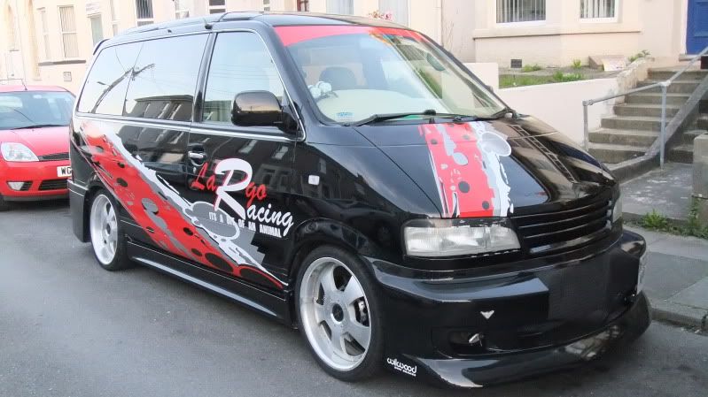

Btw, I have to say for a largo that looks epic! What sort of power is it producing?
First mapping session we saw over 350 Hp @ .8 Bar, It kept maxing out the old style rollers we were using and smoking up the tyre's.I will be running 1.8 Bar When completely mapped up. Hopefully get to surrey really soon for Ryan @ 2 Bar Tuning to get it finished before Japfest. Have track time booked, If not then i will just tweak it up to 1 Bar and have a little bit of safe fun.
Hutch
I have no mechanical knowledge so I can't help I'm afraid, but I just wanted to say your Largo looks AWESOME!!!
JDM yo!
Isn't the Largo on the same chassis as the Serena ?
If so, maybe you can use (part of) the Z32 gearbox and linkage/pedals/etc of a Serena with manual transmission ?
Might be possible i guess, thankyou. Will look into that.
Hutch
+2 and just beacause you dont have a zed do not let that stop you from joining in on the forum :)
I'm looking into the serena setup, believe they are close to the largo engine configuration and they are on a cable setup. Have to be able to convert a inline gearbox.
Hutch
Found a Manual controller, for use on the RE4R01A / RE4R03A Gearbox. Basic wiring and a gated control unit, should do the trick nicely. These will fit the Z gearbox too if some one wanted to get there car mapped or just wanted to change gear when they want, not when the Auto box decides etc.
Hutch

Sorry not allowed to release info about this without permission of the guardians bud, fitted it to mine and it works a treat for mapping. 3rd gear holds a treat. If you, like me had issues with it dropping a gear during a power trial might need to clear this with your admin. my largo is currently running 380/ 405 Whp @ 1.1 bar or 16 Psi.
