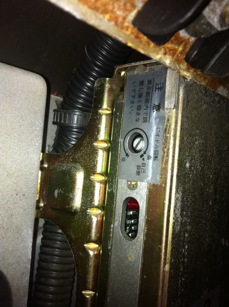

as I havent had any response regarding anyone who has a conzult local to me i thought id get helo doing it through the ecu,
heres a pics of what i Have.
is it easier to remove the A.Transmission ECU?
wish it was in english lol
you just turn it to one side for a few secs then back the other way. turn on your ignition and it should flash the lights on the dash ?
Turn the ignition switch on
Turn it fully clockwise. Wait a few seconds, then turn fully counter clock-wise.
Read the codes from the flashing LED on the side of the ECU or the check engine light on dash.
Long flash is first digit, short flash is 2nd digit.
