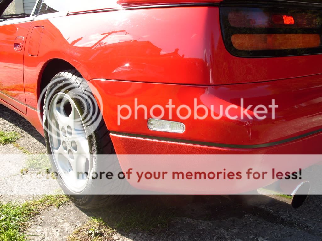

i am having some of these installed on my uk bumper but am unsure of there exact location, does anyone have a picture to show there placement? Cheers, Dan
The jap bumpers have a recess so the lights are flush, that won't be the case if you add some without substantial reworking.
If you want them, get a J spec bumper, otherwise go with Mr Isherwood ;)
Ok guys thanks, I will give it some serious thought and have a word with the guy that is painting my car, does anyone have a picture though in the mean tie to show there positioning?
They are 40mm up from the black swag line thats to the centre of the markers and 340 mm from the edge of wheel arch again to the centre of markers That is for LWB. For SWB it is 280mm in from the wheel arch.

Difference in LWB and SWB
Just fit a Jap rear bumper with them in as standard. Readily available for next to nothing.
