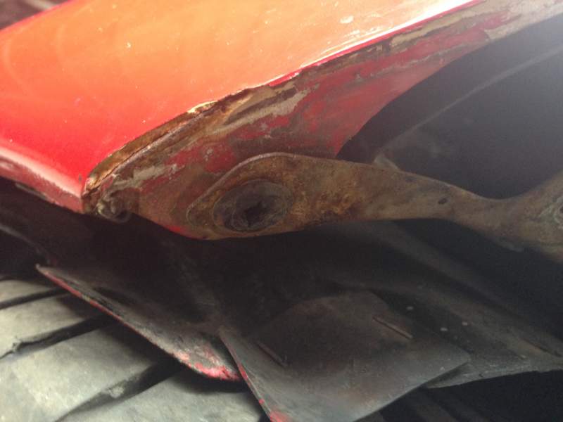

I need to fix the damaged studs on my wings, before putting the bumper back on, and I'm going to put riv-nuts in, once i've drilled out the broken studs, but can anyone post a picture of how the bumper point attaches nearest to the front wheel. The one with the bracket that goes inwards towards the engine please?
See pic below
[ATTACH=CONFIG]81913
Edited by bigh
I've obviously got too much money.......I bought new brackets, mind you the old brackets had near disintegrated.
So that grommet at the outer edge, is that were the bumper should attach?
