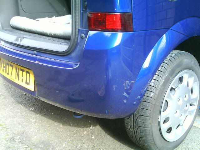

heres a little walk through i did years ago for home diy use if this helps , using 2k by the way >

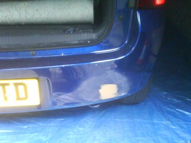

repair area

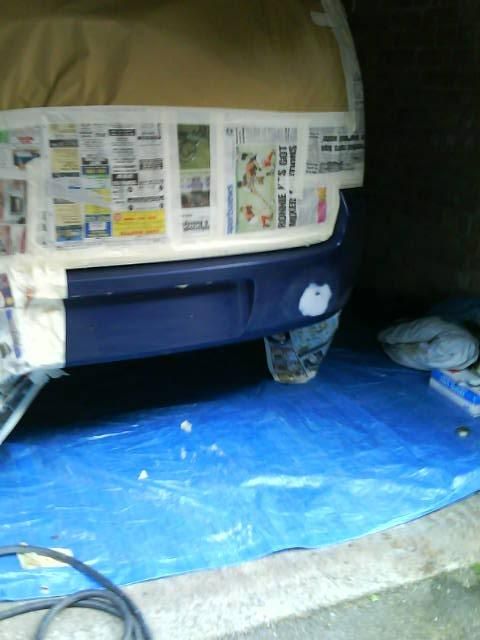

primed and blocked down the grades

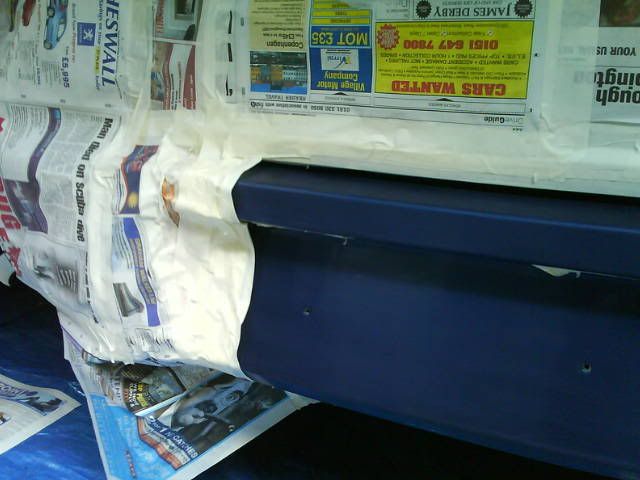

blowing this into the bumper up2 this line then it will be buffed in , so be carefull to not get any base coat ( the blue near it as you can only buff clear coat in !!

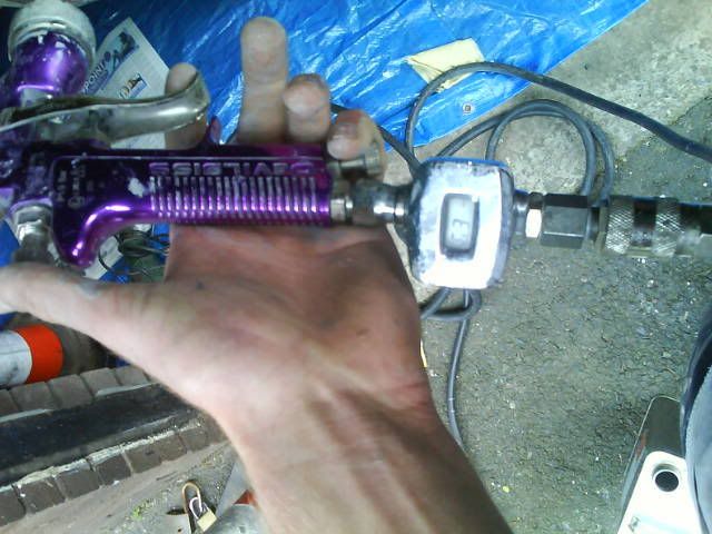

i always spray at 2 bar but everyone is different ,

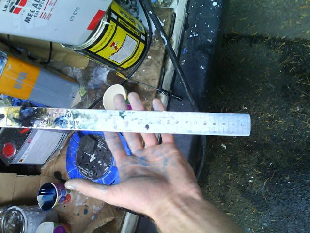

first coat of base coat ( mix is 2 ;1 with thinners )
and continue putting coats on untill covered , better going lite to avoid paint crazing
then when dry tack rag again for the final time ,
and clearcoat
mix 2;1 with a mixing stick

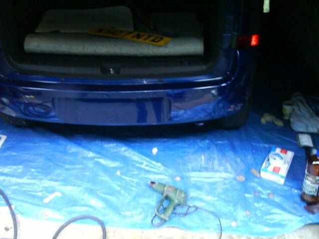

finished
then flat and polish ofcourse and you will need to do plently of it outside as there is plenty of dust in the air ..

So how much past the base coat do you laquer to seal ?
Presumably a similar technique is used to repair peeled laquer too ?
Sorry to but-in on the thread Marty, but questions may also be useful for you to know too ;)
not sure what you asking , but u can just paint the whole lot but on things were there is hard edges and inconspicous areas tyouy can buff it in , but it needs to be far away enough from the repair area so that you dont getany colour base coat near the line . then flick your laquer into that lifted masking area . dont just hammer loads of paint over the blow in line or it wont buff in . FLICK IT :)
Yeah, I didn't explain it well ... I'll try a different way of asking :)
Whats the technique for blending the base and clearcoat in areas without a hard panel line ?
