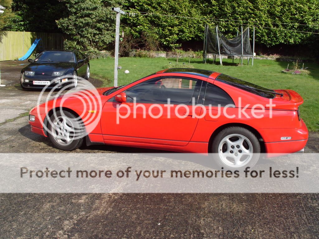

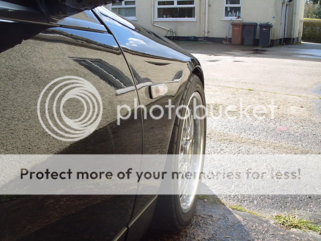

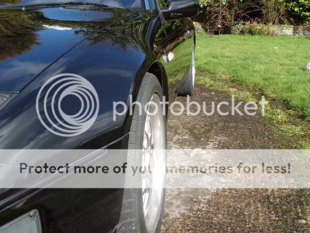

There has been a few questions about wheel spacers so took a few pics of mine.I have 25mm front spacers with 18" wheels 245x40 tyres. Under extream conditions ie very bumpy country roads they do scuff the inner plastic guards a little but on normal roads they are great.The stance looks great I think so here's the pics plus a few others just for the hell of it.

Yep, Im afraid saying "this is what a Z looks like with 25mm spacers" is meaningless.
25mm spacers will have a completely different effect depending on the wheel width and offset fitted to them.
If I fitted them to my own Z for example, they would potrude right out the arches by 25mm and the car would not be driveable, becuase I have wheels with an ideal width and offset already.
Wether a spacer should/could be used, and what size all depends on how the wheels current offset and width matches up to the cars ideal measurement for flushness, and wether there are clearance issues to deal with.

gary at that height do you get any fouling / rubbing of the tyre and rear arch ?
im like you and at 51 need a bit of comfort with damper rates ..havnt set them yet for the ride height as i need to be carefull i dont rip the wide arch conversion of or smash the F/G if the wheel rebounds into them ......
there is no best offset overall, it depends on the width of the wheel and tyre too, i like an agressive stance so i would say a 9.5j et25 with a 245 would be nice on the rear but you'd need to roll the inner lip and an 8.5j et10 with a 225 on the front. im currently running a 9.5j et35 with a 25mm spacer on the rear with a 265 tyre but i have flared rear arches and a 8.5j et35 with a 25mm spacer on the front with a 235 tyre, no real archwork needed but it does rub on the arch liners on lock.

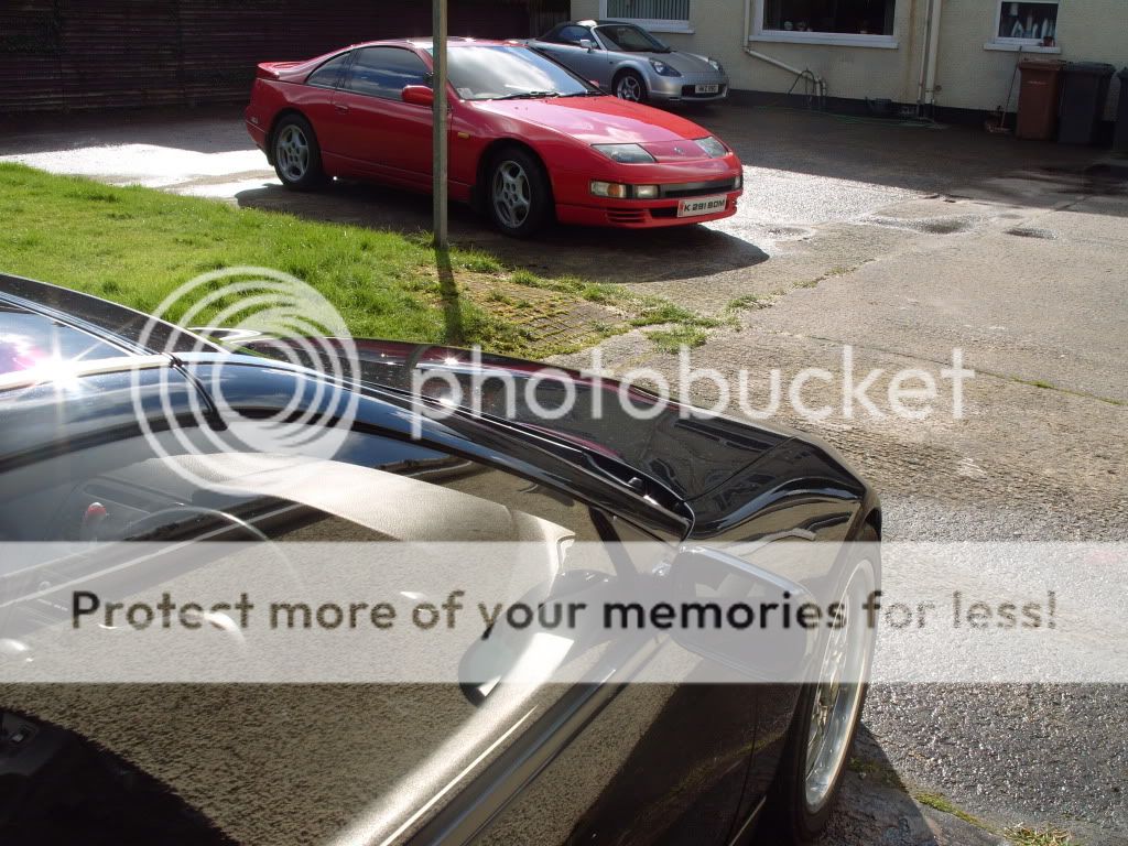

Under normal driving conditions there is no fouling but on very bumpy country roads and it has to be very bumpy it does sometimes skuff the inner plastic front arches. Not shure if the ride height has been lowered at the front but I do know it sits lower at the front compared to my SWB which has newly fitted standered Nissan shocks, this has probably left you more confused than before:lol:Here is a pic of the two zeds nose to nose.
Hi Gary,
Looking much better there.
What you may find is that the tyre is rubbing in on the head of one of the fixing screws for the liner (the two uppermost ones). If the scew heads are shiny then those are you culprits.
There are two ways you can create a little more space here.
1. grind off about 1mm from the head of the screw leaving enough depth for a crew driver (worth copper greasing the thread at this stage to ease removal at a later date).
2. Bend back the locating lug under the arch that the screw goes into paying careful attention to cracking the paint. Have some clear lacquer and a small paint brush at the ready! (You shouldn't need it really unless you go mental with the mole grips!!)
