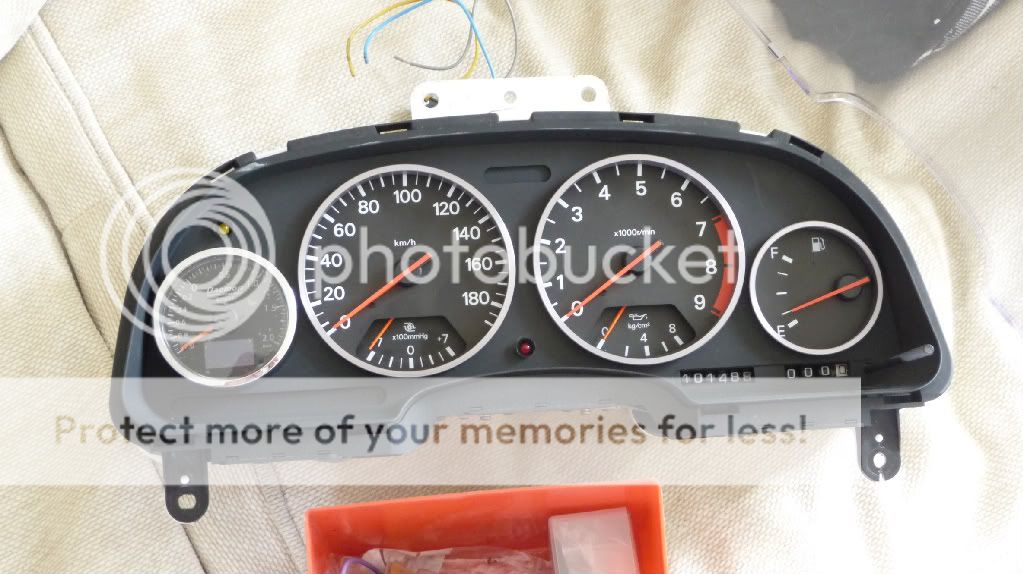

Well, that time of the year seems to be hear again and I have got my tinkering mojo back so I thought i'd put up some updates on a few new projects.
the first one is to replace the rubbish temp gauge without having lots of extra pod stuck all over the place.
So - rip the old one out!!!
This very easy and there are only a few screws holding it it. Most aftermarket 60mm gauges will fit in the hole quite neatly.
I have managed to source a gauge that gives me water temp, exhaust temp and boost all in one. Not cheap at £180 but it is 3 gauges in one.
I have managed to match it to my the standard dash colours and even the orientation of the needle at rest is a perfect match.
The lense cover will be removed also so it will look the same as the other dials (non reflective).
It's all about the detail and for me - less is more!!

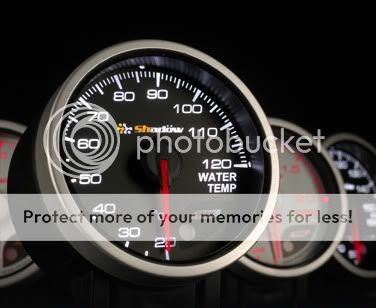

Looks good though, i want to get a water temp gauge for mine, but cant seem to find one from the people who do my gauges (Auto gauge LED one, to match what i have already)
Try shadow pro on ebay or google. This will match the standard dash better than most. i did a lot of searching on this!!!
oooh they look sexy. but i want it in the triple A pillar, (or i might change to the triple dash pod that zcenter sell) but want the gauge showing it in LED numbers rather than a needle to match the ones i already have.

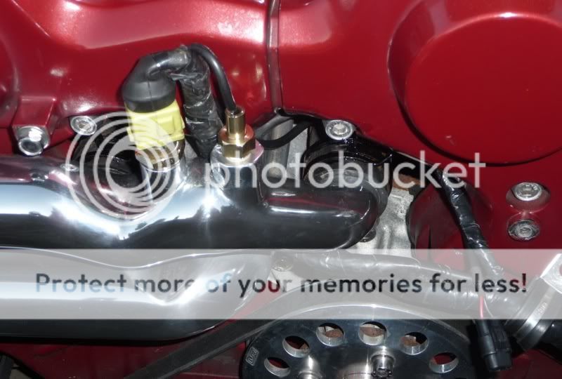

Finally got the sender in!!!!!!
What a pain in the arse!!
After going to loads of machine shops and getting nowhere.
I called on my old friends at speedflow and they said just send us the sender as it could be one of two tread types that one has 26 threads per inch and the other has 27 or something like that. The upshot would be that if you get it wrong it will screw in once but wouldn't be re-usable!!
So, I sent it off and she measured it and sent me back two blue anodised adapters - one big and one small. The problem with just using the adapter is that the sensor would sit too high and not be in the coolant. So, it would have to be adapted...
I then took these to a local engineering shop who cut down my water pipe, drilled it out, de-annodised the adapter and welded it on...... all because I wanted it to look factory. I then smoothed an polished the hexagonal top round to blent back in.
Less is more!! or in this case...less is a right pain in the arse to achieve!!
Now just need to get the new wire from the engine bay into the cabin - not sure if I have anymore room!! Oh well, that's what sundays are for!
What do you think?
I wouldn't have noticed the welded on/smoothed out nut if you hadn't mentioned it...
very, very smart mate, I love attention to detail :) :thumbup1:
