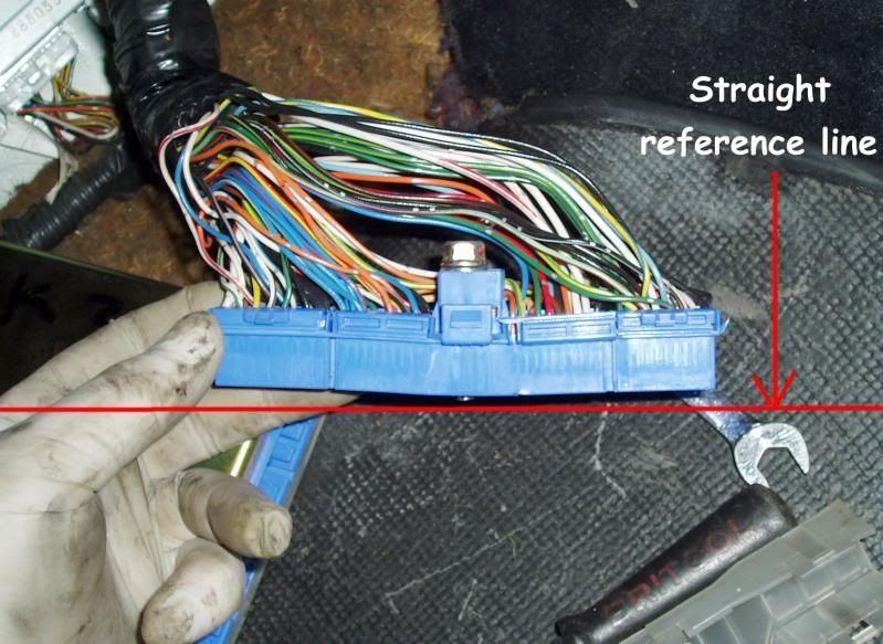

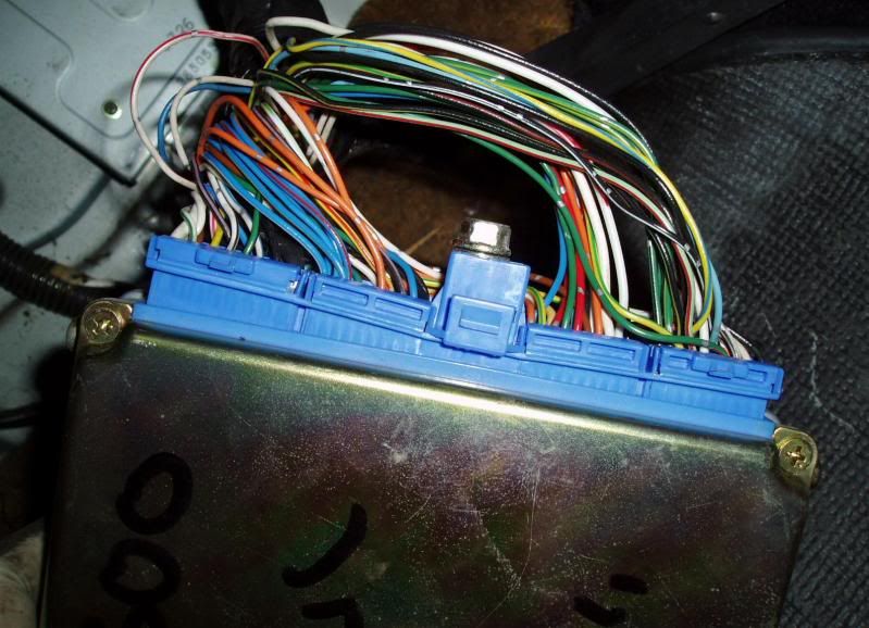

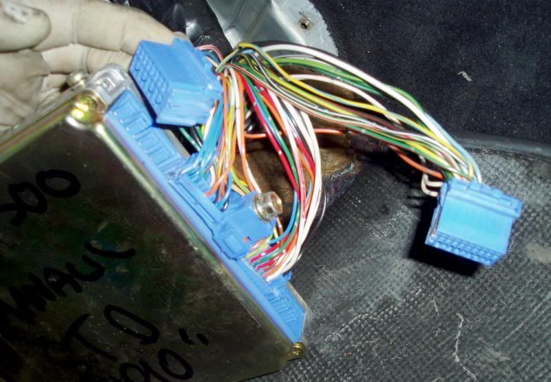

1) Ecu plug damaged from bad fitting.
Unfortunately as it was so badly mishapen the only way to get it to fit was to split the connector into the three parts so it would connect correctly, later the whole plug will need replacing.
