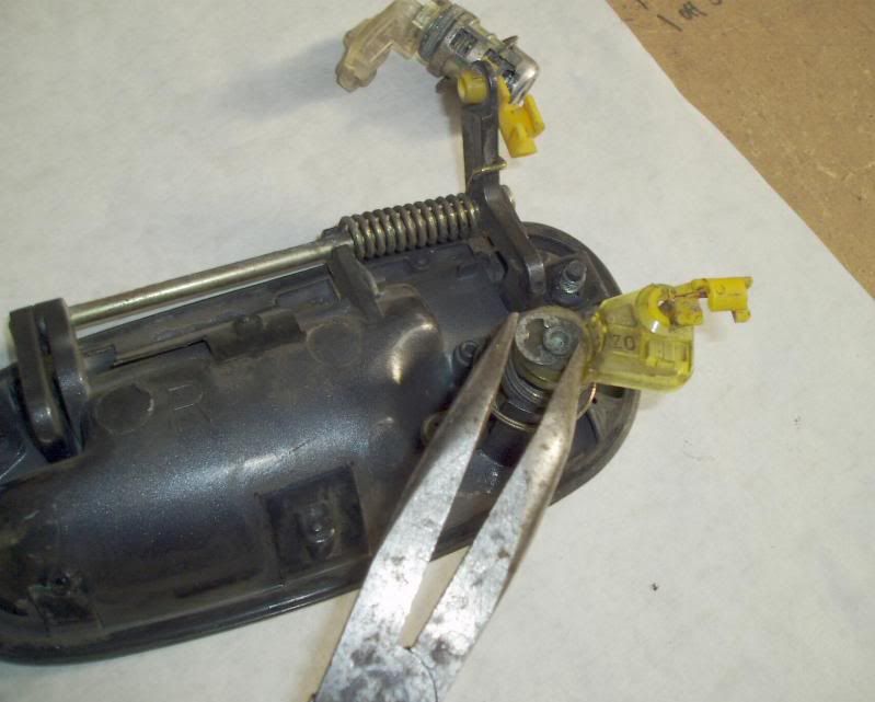

The picture below is what you will see, the yellow plastic quadrant broken away from the lock barrel, release the door handle and remove the handle to your table.

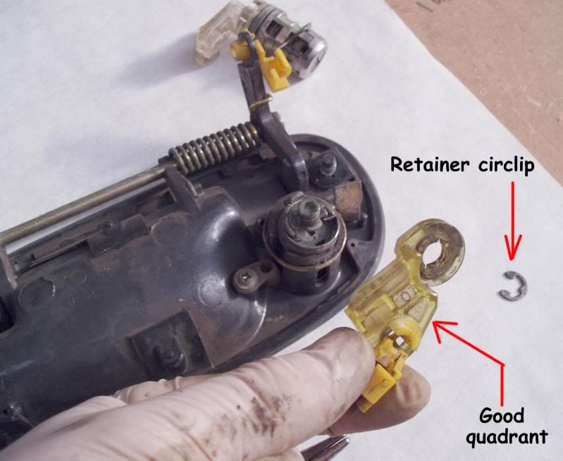

So with the handle on the table its clear to see where the quadrant has broken away from, the circlip needs to be removed.
Now if you have been lucky enough to find a god used quadrant you can fit it in place and refit the circlip, and refit to the car.

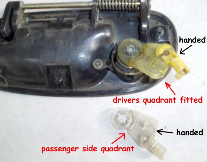

However its likely you will have little luck finding a good used one or at least it will take some time, but take a look at the quadrants below, the yellow one been the drivers door one and the white one been the passenger door one.
The two quadrants are handed and initially look like they will not interchange, however looks can be deceptive.

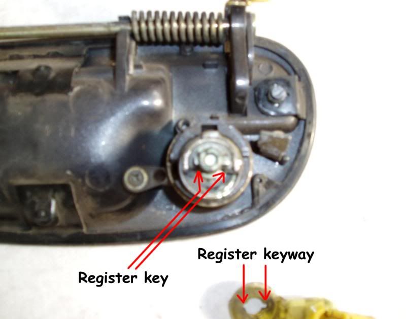

First note the barrel register keys and the plastic key ways in the quadrant, the passenger one is the wrong way around of course at this point and hence will not fit.

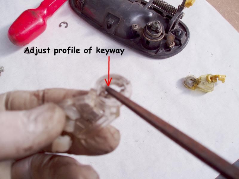

However with a small needle file or similar you can open up the key way slightly so it matches the layout of the register keys on the barrel.

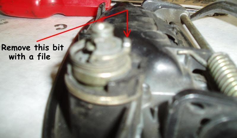

The barrel also has a small metal stop that will need removing with a file, not too hard but go careful made out of monkey metal and is soft.

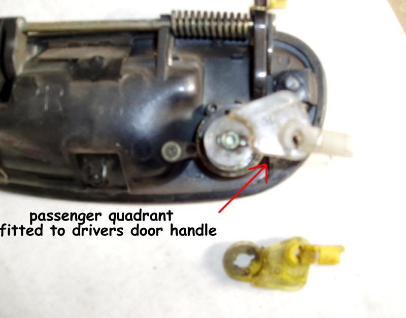

Will a little effort the passenger quadrant now fits the drivers side lock, there is a slight difference in position but its so small it has no effect on the locking action.

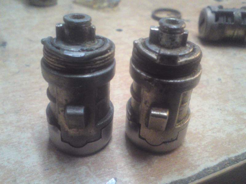

But I wanted it perfect and briefly thought today that the removal of this 'stop' had come back to bite me on the bum, look at this pic below where the one on the left as this piece of metal removed.

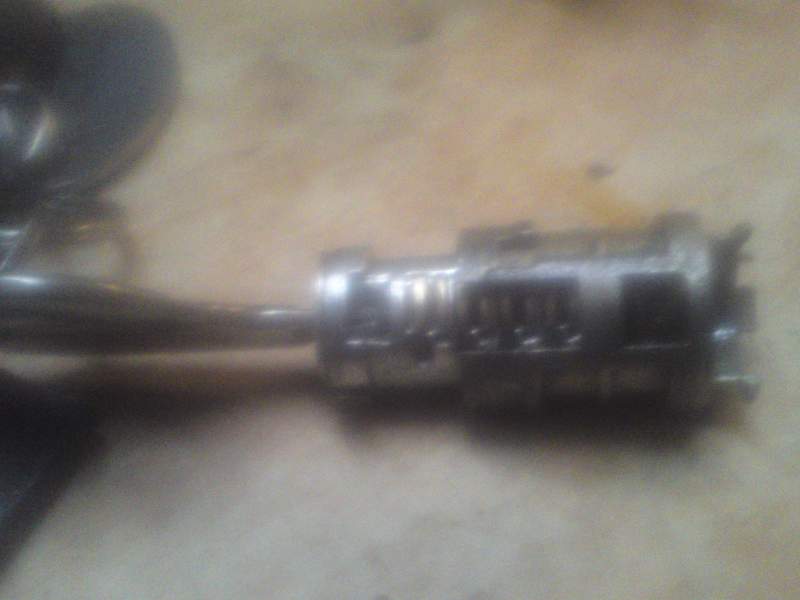

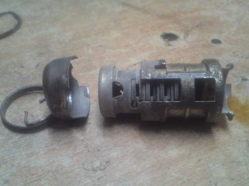

Looking more closely at the barrel I took the spring off the end which returns the key to vertical position and then the key slot cap was teased off as it's crimped in a couple of places - you can see this crimp in the above pic, after these are removed the cylinder itself slides out and I could swap over the barrel housing, crucially to one with a metal stop.
I then had a problem as the key would not turn in the 'new' or different housing which puzzled me for a while but it turns out I just needed to take a fraction off the pins that lift once the key is removed, key in and the pins retract in ie making it flush.
The pic below is not the best but you can see how shiny I have the part on the left having run it on my wire wheel, what happens now is what you want, with the key in the cylinder, the housing on the right spins with ease especially with some grease/oil.
Just replace the spring and crimp back down the metal cap and job done, I have my aluminium quadrants now fitted and the travel with the key is again as intended.
