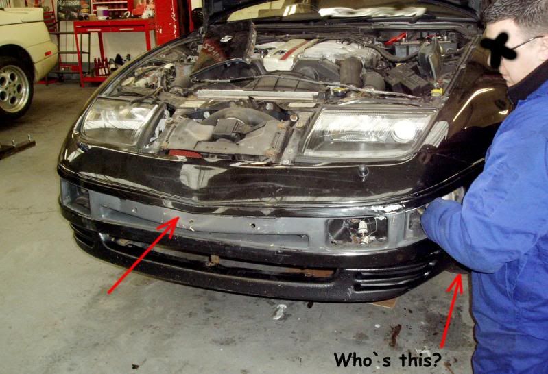

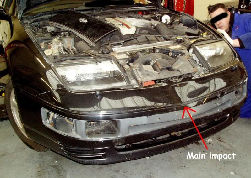

Accident damage can be difficult to call sometimes and dismantling to check behind panels is sometimes inevitable but when you look at the front bumper in the firsts picture you could be forgiven for thinking the damage would be mainly bumper related.

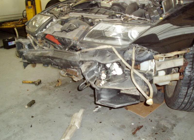

However from previous experience it seemed prudent to remove the damaged panels to look closer, and as suspected the amount of damage behind the bumper was extensive.

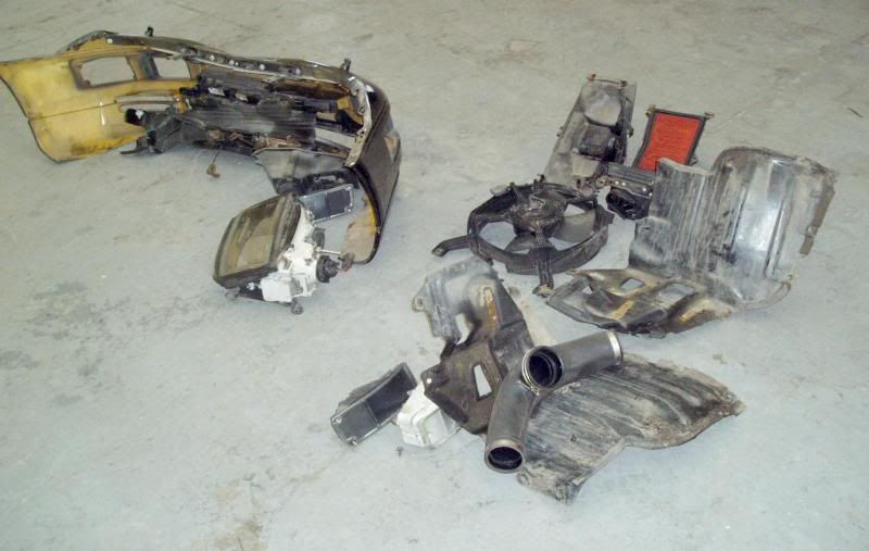

So much undoing and removing of parts Jamie ended up with a small pile of bits.

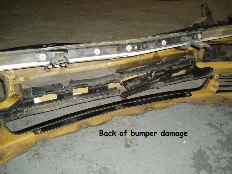

Rear damage to the bumper.

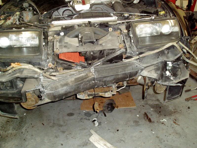

All is revealed, even the afm and air box has been damaged

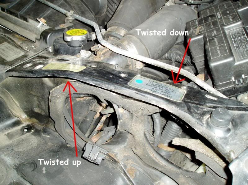

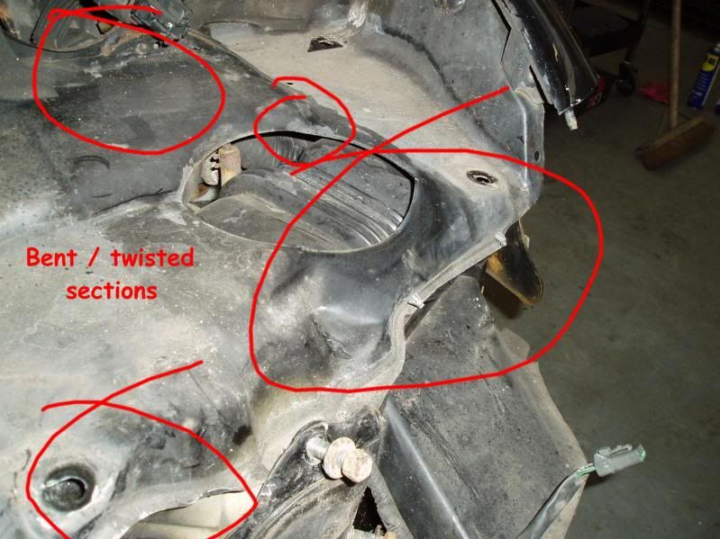

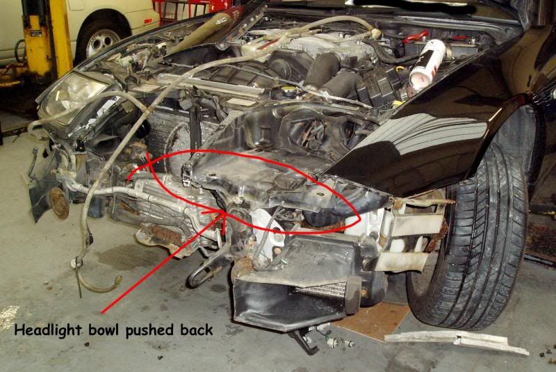

The impact has rippled though the headlight bowl and disturbed the bottom section with some area's bent down and some bent up.
The impact had gone further still twisting the near side slam panel, the entire headlight bowl and upright has moved back and up.

Pretty similar to my damage when i hit the deer in 2010, but not as much. I dressed the distorted headlight pan back to profile using templates from the opposite side, and luckily my slam panel was fine.
Great write up Jeff, but why has Jamie got his eyes blacked out?!?
Al.
only people who have no clue about salvage vehicles would think that its just a bumper ive seen cars for sale that mates have said it looks nothing, its not the comsetic panels that are the probs, its everything behind that is gonna be the costly time consuming bit
there are so many things behind, a bumper these days are simply comsetic
Al.
To save his blushes as the top distmantler.....you should see him with an angle grinder!!!

Thanks for that Jeff - it just shows what could easily be hidden by just replacing the bumper!!
