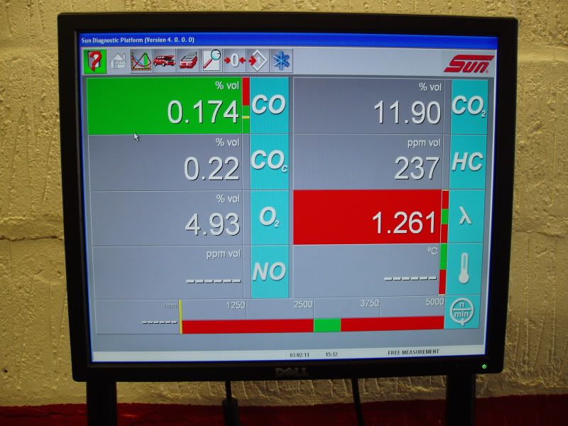

This excessive fuel use is certainly getting frustrating, as coolq mentioned all of the "normal" issues that can cause this have been covered, the last we checked the tick over fueling was ok but at 2k revs it went horrendously rich at almost 12.5 on the Co bearing in mind this without any load, we suspected the chip and tested it for one of ours FOC and that brought it down by a big margin and also reduced the horrid smell / odour the exhausts give off, kind of sickly throat stinging. Seen this previously with bad camshaft/valve timing but again all of this has been checked...very bizzare.
The pic below is the last one we ended up with ignore the red sector decat and 02 sensors not connected, the previous chip had it running wildly high, sadly lost link for pic of this.
So why the apparent excessive fuel now??? just thinking about the car itself now coolq, brakes dragging, diff issues?? strange one for sure.
