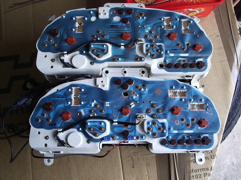

Just come to fit my new UK dials and found the plugs different!
UK is the lower pic,
I presume these are off a later series than mine?-Question is can all the gauges be swapped to the Jap housing and work correctly or am I fooked!:hang:
Yes from a later series with the air bag, you can swap the dials out to your jap spec, you could just do the speedo and odometer, as you have el dials covering the bar rather than psi for the boost gauge. Having said that, you dont want to be re- glueing the dial faces so swap the lot :thumbup1:

Right Graham, If I swap the lot to the Jap housing(so the plugs match up) they will work o.k.?-no wiring issues ?-just need to confirm as I'm doing it now.............Oh and it will still read in miles...........
You will be fine mate, done it myself a few times on different dashes. It will read in mile if you also change the odometer, the UK one has blue cogs, the jap grey. The odometer gets its signal from the speedo board, which if you are using the UK MPH clock, will read right.
