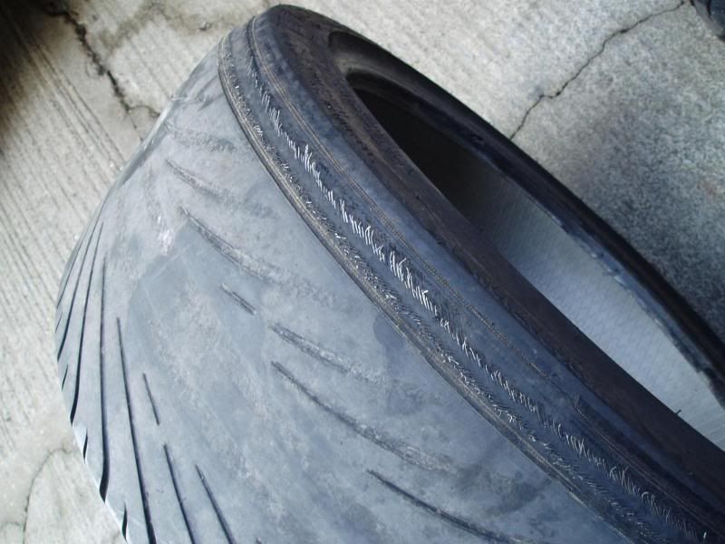

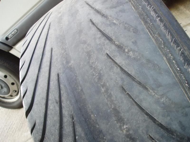

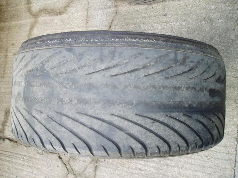

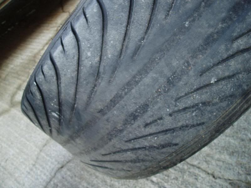

Rear end instability and general poor traction was a passing comment when this particular zed was dropped for an MOT, tyre condition was discussed and the owner was happy with the tyres and that the tread level was good and thought maybe some wear in the suspension was to blame.
Later when on the ramp the cause of the poor traction was clear, the tread on the rear tyres was almost completely gone, except for the outside edge, the bit visible when glancing from above, giving the impression all was ok.
Of most worry was one tyre had exposed metal cords that had started to part from the rubber, a potential blow out waiting to happen, the owner was shocked and somewhat embarrassed gave immediate ok to fit new tyres, a check of the suspension and steering parts cleared them of any faults, the inner edge wear been due to lowered suspension combined with over pressure.
The importance of clear and accurate tyre checks cannot be stressed enough, with zeds been so low its so easy to make this mistake.
Jeff TT

Jeez those boots are bad !! in my experience a lot of cars with hicas joints worn scrub the tyres on the inside like that on the rear,in can be be lowering also though.
