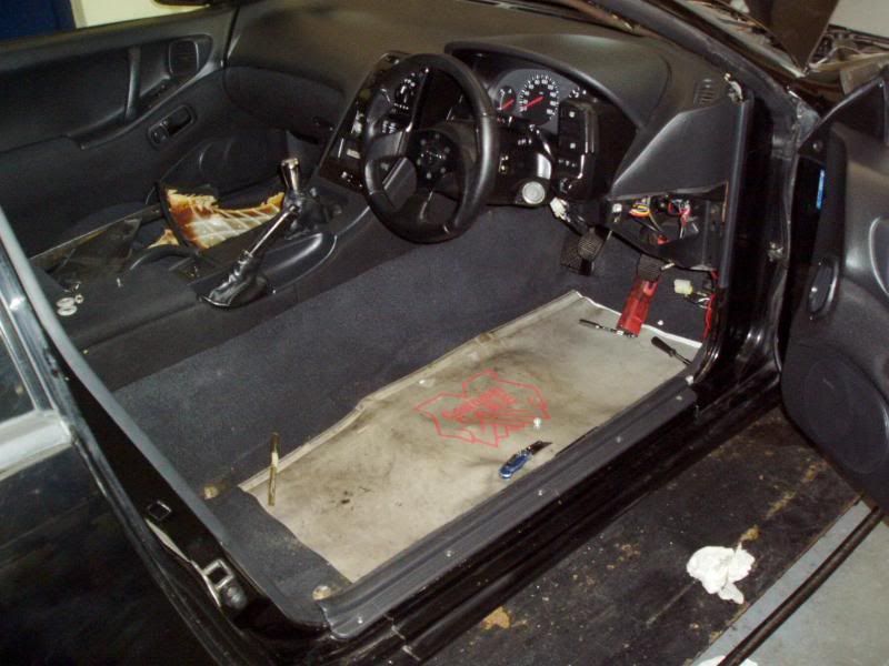

So as per the Nissan style getting to the problem is the biggest part of the battle, removing the seat, knee pad, heater ducting and fuse box access panel is just the start.

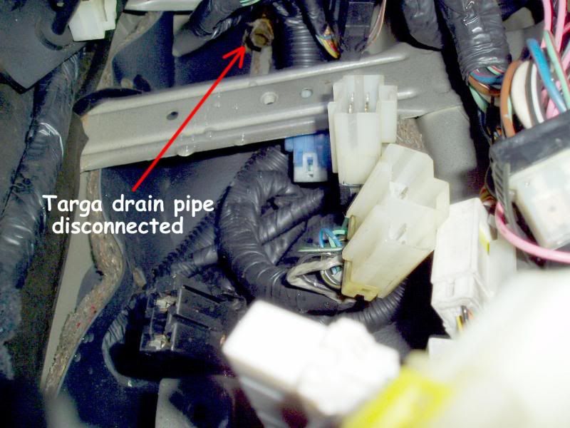

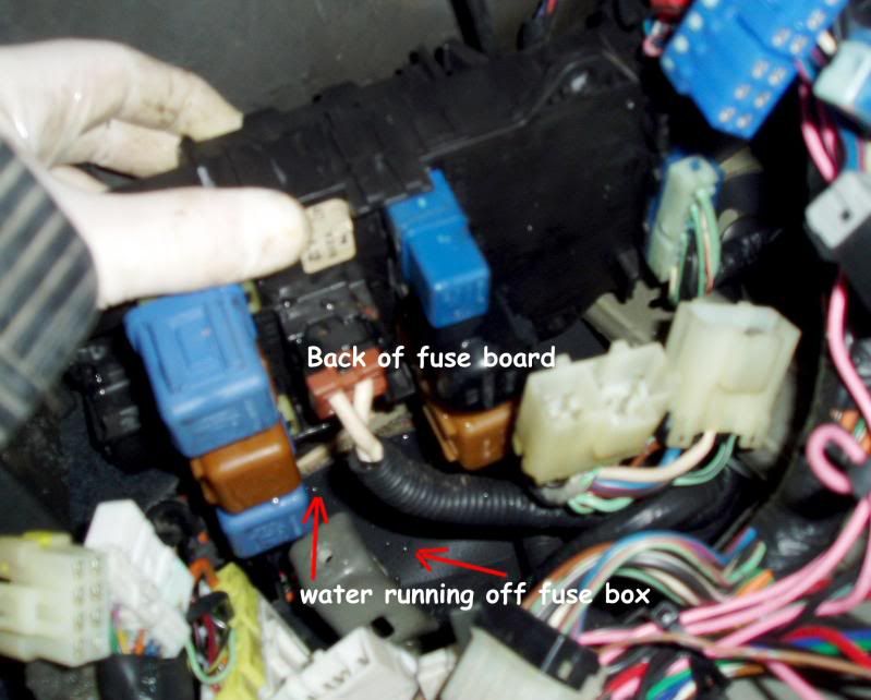

So the targa pipe was tested by dripping water down the targa channel and it quickly showed itself in the foot well inner section and across the fuse box.
So the fuse box needs to be removed but before that you need to remove the accelerator pedal 2 x 10mm bolts (long) and tie it out of the way, now undo the bonnet release handle 2x 10mm bolts (short)
The fuse box is held in with three 10mm bolts but often there is only two actually fitted, before you do this however there are several connectors that need unplugging, now as the fuse box is undone and turned around there are two further connectors on the rear, now it should be able to be pulled free

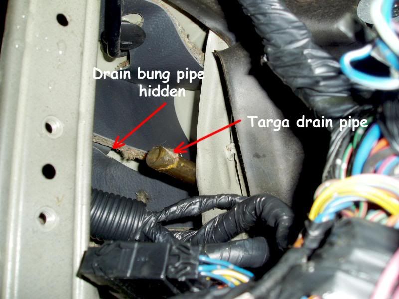

With the fuse box removed the targa drain is visible, and clearly disconnected from the exit bung, this of course means any water that runs down the targa drain pipe ends up in the fuse box and the foot well carpet.

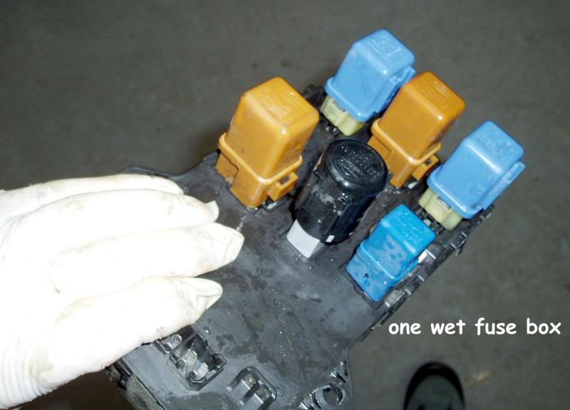

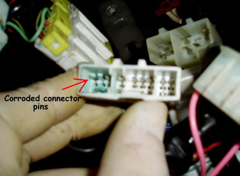

Here we can now see how the moisture has started to effect essential electrical connectors, leaving this any longer will mean odd electrical issues and maybe even breakdown.
Back to the fuse box and in need of a hairdryer session, the unit was drenched.

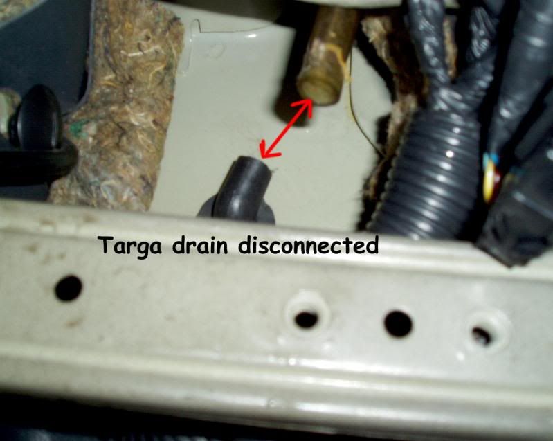

So now with the insulation pealed back we can see the drain bung and the pipe and how they not as they should be!!

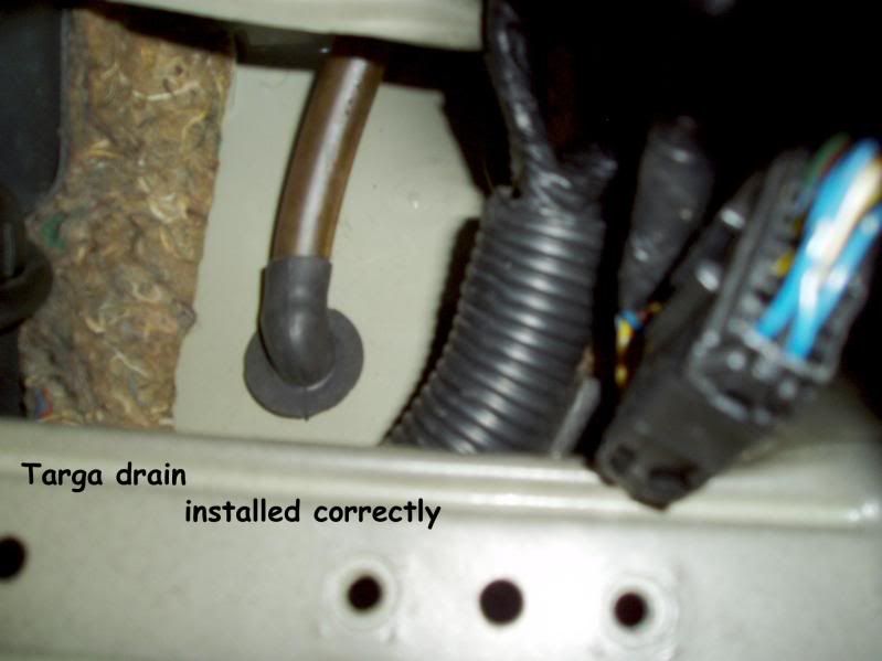

Now with a few moves all is well again, the drain pipe was pulled down a few inches to ensure it stays connected.

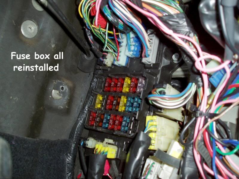

So with the fuse box dryed out the connection cleaned and the box section dryed and sprayed with WD40 all was reassembled and tested.
The odd thing with these drain pipes is they are glued into the drain bung and its seems odd why they come off, I think the pipes are shrinking back and pulling then off, sadly not really easy to check on a whim.
