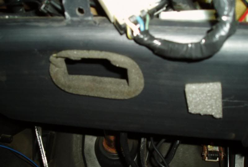

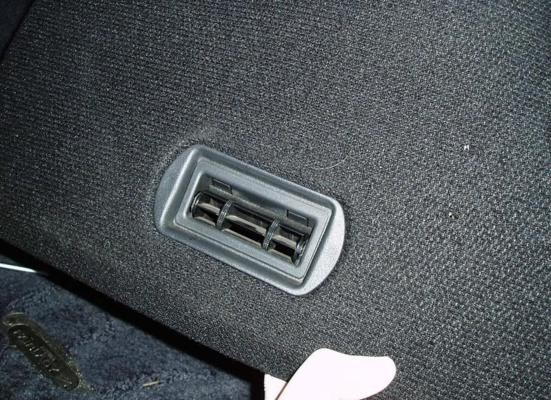

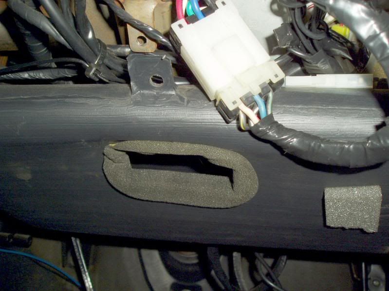

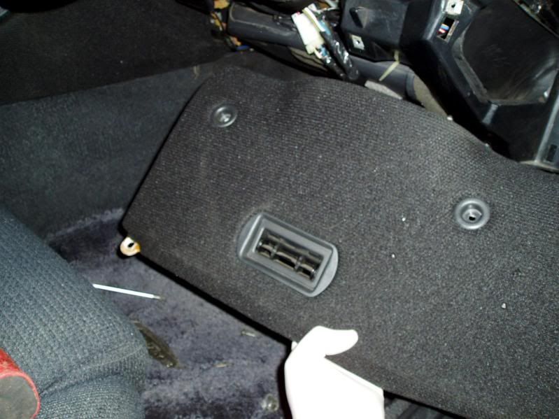

I mentioned some time ago about an optional knee vent that was fitted to later zeds that can be retrofitted real easily. Had the opportunity to get some pics form an M reg and as you can see the vent is fitted in to the drivers side knee pad where you will have a knock out blank plate, the heater duct underneath has the corresponding cut out are and with the addition of a little foam the seal is made when the knee pad is refitted, the vent has direction fins to direct the area to your legs or to your other area that maybe cold!! will add the part number for the vent tomorrow, from memory they are around £15 from Nissan.
