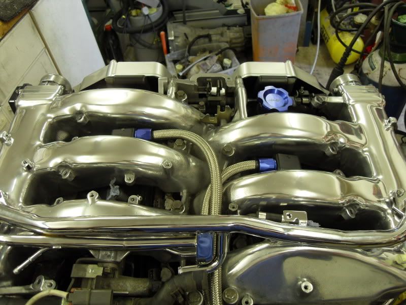

I'm on the search for piping (preferably blue) to re-route my PCV system but I'm not sure what diameter of pipe is needed :/ Anyone have a good source for it and T-piece style connectors?

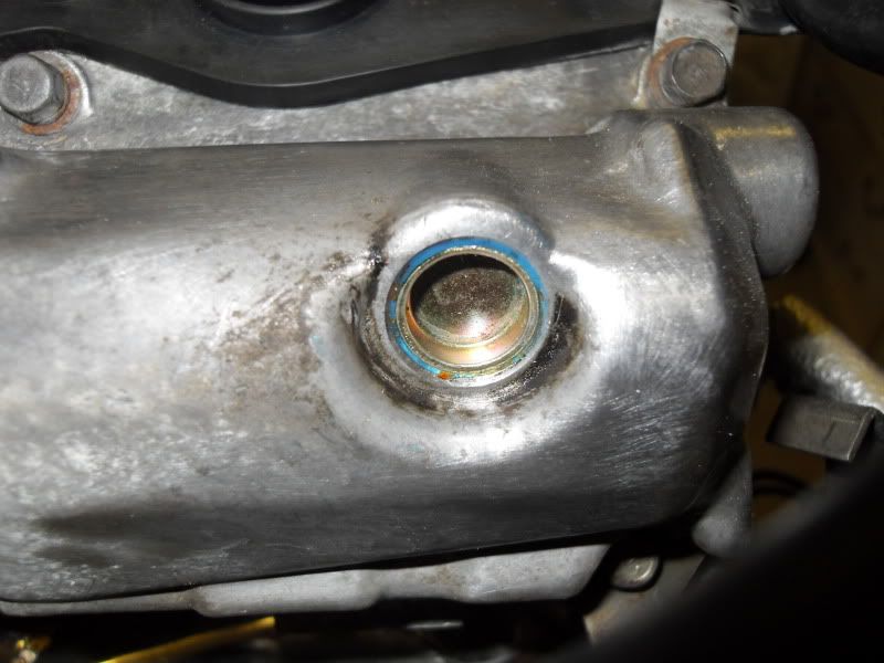

I used 15mm core plugs to seal the original rocker cover outlets and a mate made me a couple of joiners to connect the new breather pipes to the PCV valves.
The same mate drilled and tapped the rocker covers .

Thanks for that boldy but I'm going down the same route as Silverbullet did with his. I'm going to link the front 2 breathers together and vent them and then vent the rear passenger breathers as well. Just no idea where to get a hold of some pipe the correct bore to re-route.
