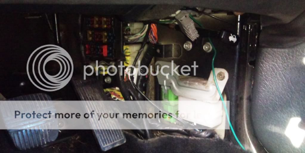

ok, got the fuse box out, (looks like its been out before) wonder if ill ever get it back in again????
2011-02-08151543.jpg?t=1297178274
What am i looking for now? is the circit breaker the round black thing? if so what do i do next? cheers
ok, so ive had a look inside the breaker, and there is contact and continuity between the terminals. any ideas now?
Try running a ground and live from the battery directly to the seat. Im not sure if the circuit breaker works open or closed circuit. Might be worth trying to get hold of another one from a member or JeffTT. The power goes from the battery to the fuseable link in the engine bay, then onto the circuit breaker. If the fuse is fine then its the breaker. HTH
cheers for the help, there is power to the circuit breaker, but not to the seat plug, but theres still no power there even if i bridge the breaker?? im going to have to assume theres nothing wrong with the seats themselves because they both failed at the sdame time and theres no power to them. ill have to get a new breaker i guess, but i cant see how it would work :-(
Get hold of another and if it doesnt sort the problem, then do a bypass direct to the battery, i have a feeling that the breaker will be open circuit to feed the seat, once the breaker has gone its closed circuit, hence the continuity reading, i could be wrong, but it might work the opposite way to a household type breaker.
