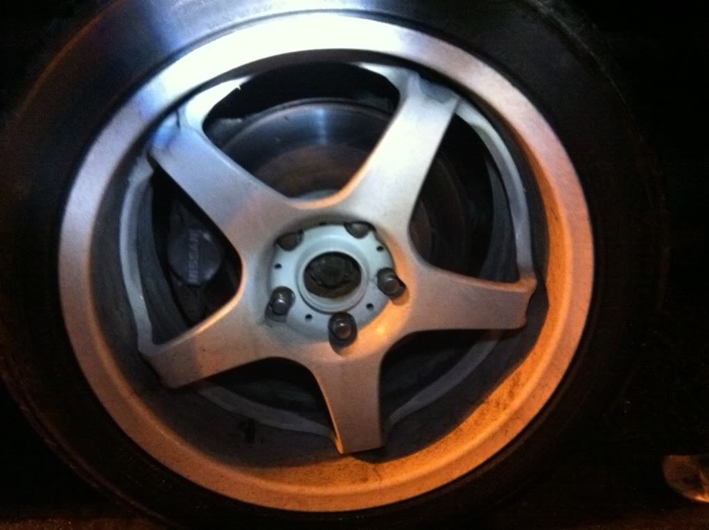

is it the original wrench? are the covers still over the nuts?
they look the original jack/wrench as they fit perfectly into the boot slot, no idea if the wheels on it are any good or not, will go take a pic in a min
i had the problem with my old alloys. the nut "hole" in the wheel was too small a diameter so had to use a thinner walled socket to undo the nuts.
from ya photo it looks like ya original nuts have been replaced by the more modern Nissan chrome closed 22mm nut. I did that too!
the actual trouble is, theres a dome on the top of the nut and the nut itself is so far down its almost inside the wheel, on the upside i guess i wont come out to find it up up bricks and the wheels nicked
