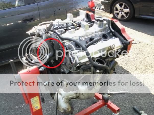

it's the 2 pipes i've circled in red that you need to join, that keeps the water/coolant in the engine but doesn't get to the leaky matrix....

i cant see anything back there, but the two which go into metal pipes, then one right beside then brake fluid that goes into the bulkhead. im crap at this stuff. anyone got a pic of the correct two?
those are the ones from the metal pipes that i ment before, will get on it now. appreciated.

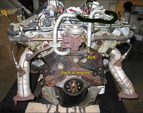

This is what you are after, excuse the crude paint shop lol

sorted now, thanks people
perfect Groover. massive help.
