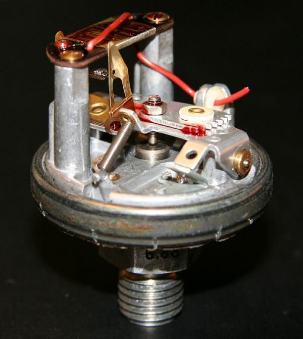

I purchased a Tridon oil pressure sensor (Australia) the seller on ebay gave a 100% fitment guarantee. I bought the part and it didn't fit. It didn't even look like it would fit. There was only one electrical contact (should be two) I contacted them immediately because I had just booked a mechanic for a list of jobs on my Zed.
After several days they are suggesting this
https://www.sparesbox.com.au/part/fuelmiser-oil-pressure-switch-cps141
So what does everyone do about the stock oil pressure sensor failing.
Replace it with a genuine Nissan one and it will work again for 10 years.
Jeff
I thought the genuine Nissans was known to be a problem. Also expensive. But OK,;I'll look into that
