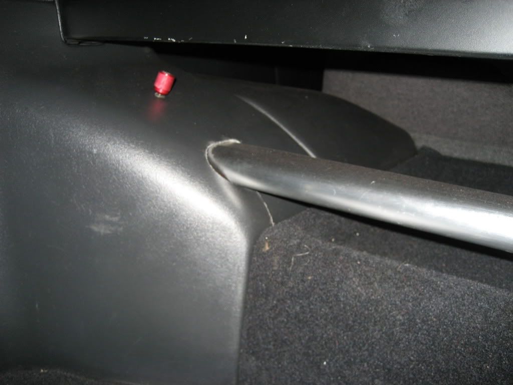

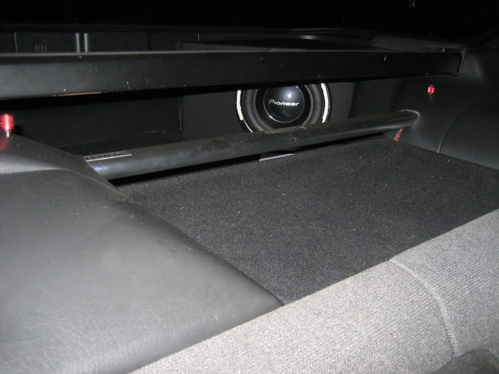

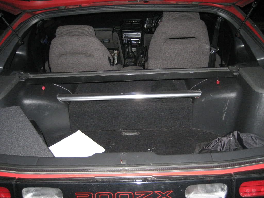

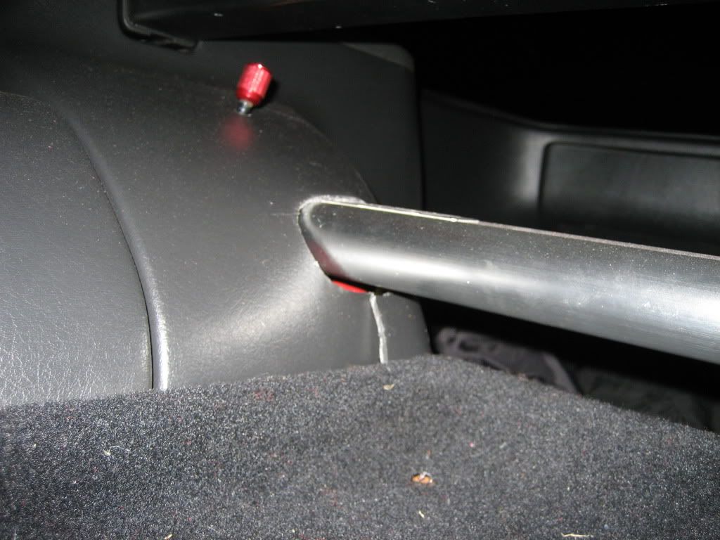

i've got a carbing in my rear, i'll do a pic in a bit.
involved more cutting than andys
a 3 piece like andys just needs 2 round holes, a carbing like mine involves a oval slot and a cutall the way from the slot to the bottom of the pannel

thanks ian, i have a 3 piece one. want to do as little cutting as possible.
