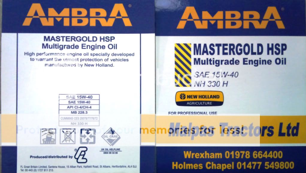

is this oil any good?
hey there, ive got access to a fair bit of this oil fairly cheap, would it be any good in the zed? cheers guys
Never heard of it! Don't you want to be using 10w40?
I wouldn't -looks like Mineral Oil.
That's what I was thinking......
....and 15w is going to be far too thick to get round the engine when cold - now that we're heading into winter you want an oil that circulates quickly from a cold start. Nissan recommends a "10w" for the job; although a "5w" is better but not necessarily needed in the UK as it doesn't get that cold!!
