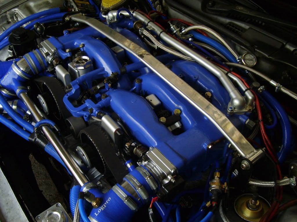

Done the wire tuck today and chopped up the loom in order to hide the cables
under the plennum also fitted the new water pipes too.
Heres a few pics :
8mm id silicone pipe is what you need,it doesnt have to be reinforced either as the normal stuff will cope.id use the Stock nissan pipe clips too,they are sprung for a reason.as the pipe expands and contracts the clip will retain tension on the pipe whereas a jubilee wont.I know people that have used jubilees ok but id imagine after the pipe had shrunk they could work loose.i prefer the clips and think Nissan used them for a good reason imho.
After your recomendation i stuck with the standard clips rather than the jubilee type !
Makes sense !
