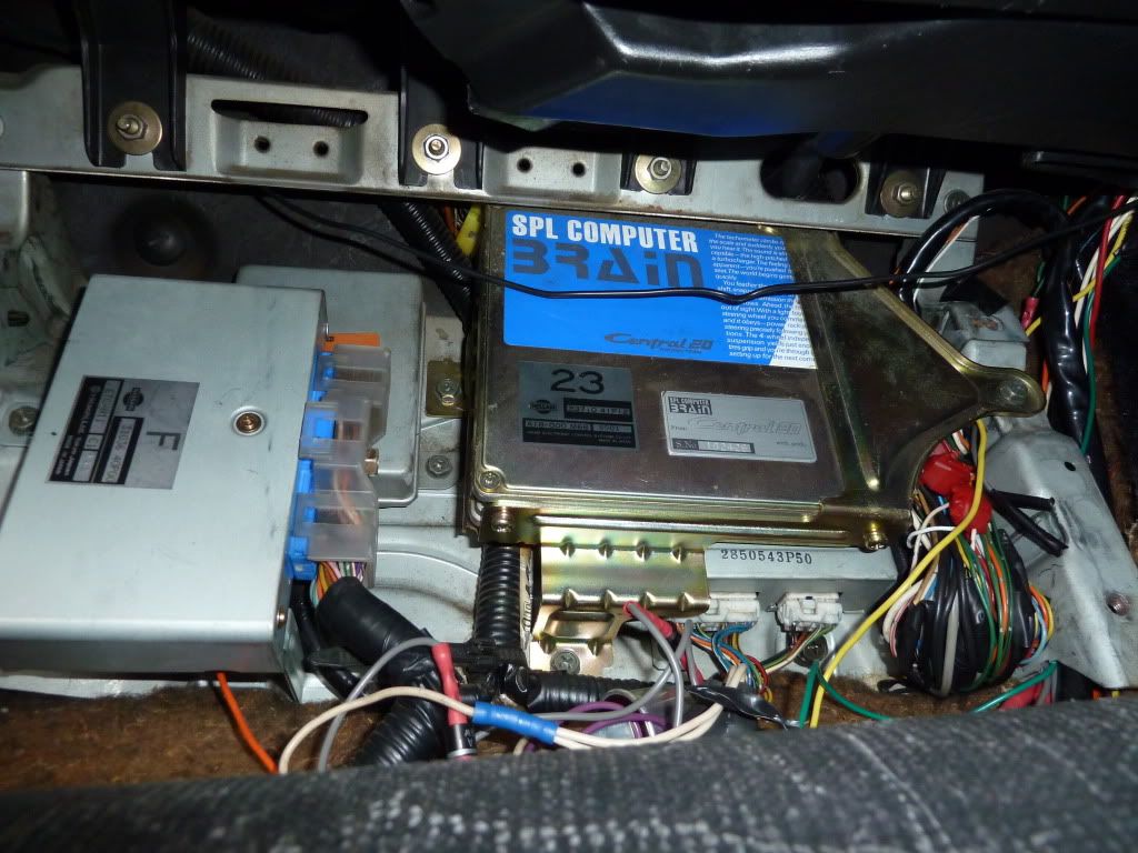

I would check under the carpet on the passenger side where the ecu's are to make sure they are dry weird stuff can happen if they get wet.
I took the floor panel up to reset the ecu and check any fault codes and this is what I found!?
Vodkashots mentioned a set screw on the left hand side?? I think I have a problem this appears to be an aftermarket component. Any advice?
one screw on the left hand side, would of thought that would still have it, i have a Greddy ECU in mine and it still has the screw on the side and the fault code indicator.
The setscrew port was covered by a metallic sticky label that read – do not remove. I removed it and set the ecu to diagnostic mode and got the 55 code. I am wondering whether to risk a test drive – busy roads round here Friday afternoon! If you don’t hear any more from me that’s not good news.
