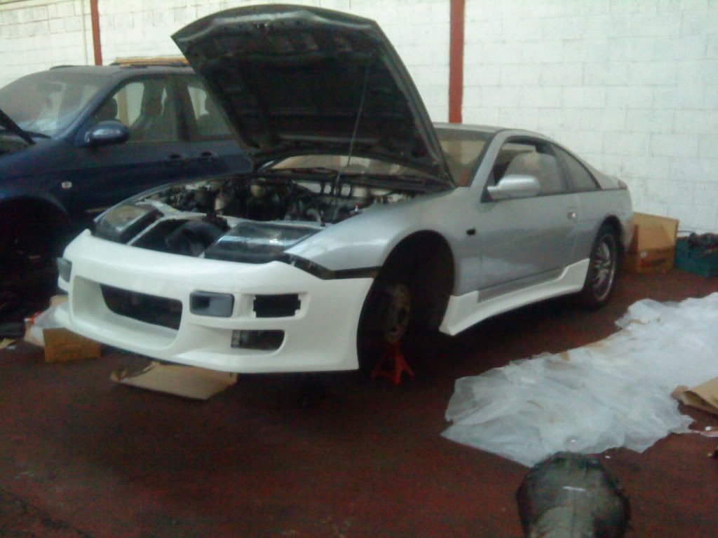

99spec front bumper
Been trying to figure out why my 99spec front wont fit on my new zed, I've tried for the life of me to get a snug fit up at the wings. I've modded the inter-cooler ducts and even removed the polystyrene that was on the nudge bar, and removed the front fog lights, but i just cant seem to get it to sit flush with the wings for some reason?
I didn't have this problem with my black zed when i put it on that. and apart from a under tray that its not catching on, that's the only difference.
Am i missing something here?

On the bumper issue, do you have these ? http://www.courtesyparts.com/jdm-front-bumper-bracket-p-228667.html
They're different to the 89 spec ones and I think this is why you can't pull it round to the wings properly.

Nope didn't have them, had the bar that attaches to the front of the bumper with the nose panel pins in, and the two side bits that i already had taken off the 99spec before i sent it to car.mad, I've looked at every possible situation to think why i cant bring the wings up, and the only thing i can point it too is that bar that holds the fogs in, the fog surrounds have some pretty thick plastic on it. so I'm just going to grind it back a bit as its only 2 bolts to remove. and see if that helps.
Yeah was thinking of trimming around the edges of the fog housing not going to close to the rear, but just enough to take that "bulge" out around the edges.
right so its need cutting regardless then. could you shop your pic with it on where it needs to be cut?

There is a thick edge around this bit, i think its this its catching on. ill have the bumper back off tomorrow and double check, then trim that part down, and see, strange how i didn't have this problem with the UK bar. and no Car.Mad i do not thing it was to do with the mold casting process, just my bar being gay on me.

that look as if they have been trimmed a bit !
Yeah mine were trimmed, but something is pushing the front out away from the nose and lights. so its not quite marrying up with the wings. and you cant push it any further in. there is definitely something stopping it moving into position.
From what I can gather from Z1 and Courtesy Nissan, the 99spec has slightly different intercooler ducts as the originals cause fitting problems.
from z1's website;"When fitting on a Twin Turbo Z32 it is possible to use the existing stock intercooler air ducts, although they do not fit perfectly. We do offer the '99 JDM intercooler ducts for the stock SMICs made by Nissan specifically for this fascia as an option below."
So mate, sounds like your on the right track with trimming your ducts.
Take off the intercooler ducts! That's what stopped mine and after that it slotted right into place! Also getting the foglights to sit in nicely is a bit of a tricky business but 10 minutes of fidgeting should see you right.. wait till you try bolting it up through the indicator holes lol! Fun times to be had! To be fair my wing was a bit mangled which made my experience much worse than it needed to be

When i put it on my black TT, i didnt touch the intercooler ducts. but when i tried to fit it to my JDM TT, i did, now for some reason, it refuses to sit flush with the wings, which is strange as i didnt have the same problem fitting it too the UK spec car, which i hadnt touched the intercool ducts, they were flexible enough to allow me to give it a bit of a push and do the bolts up.
