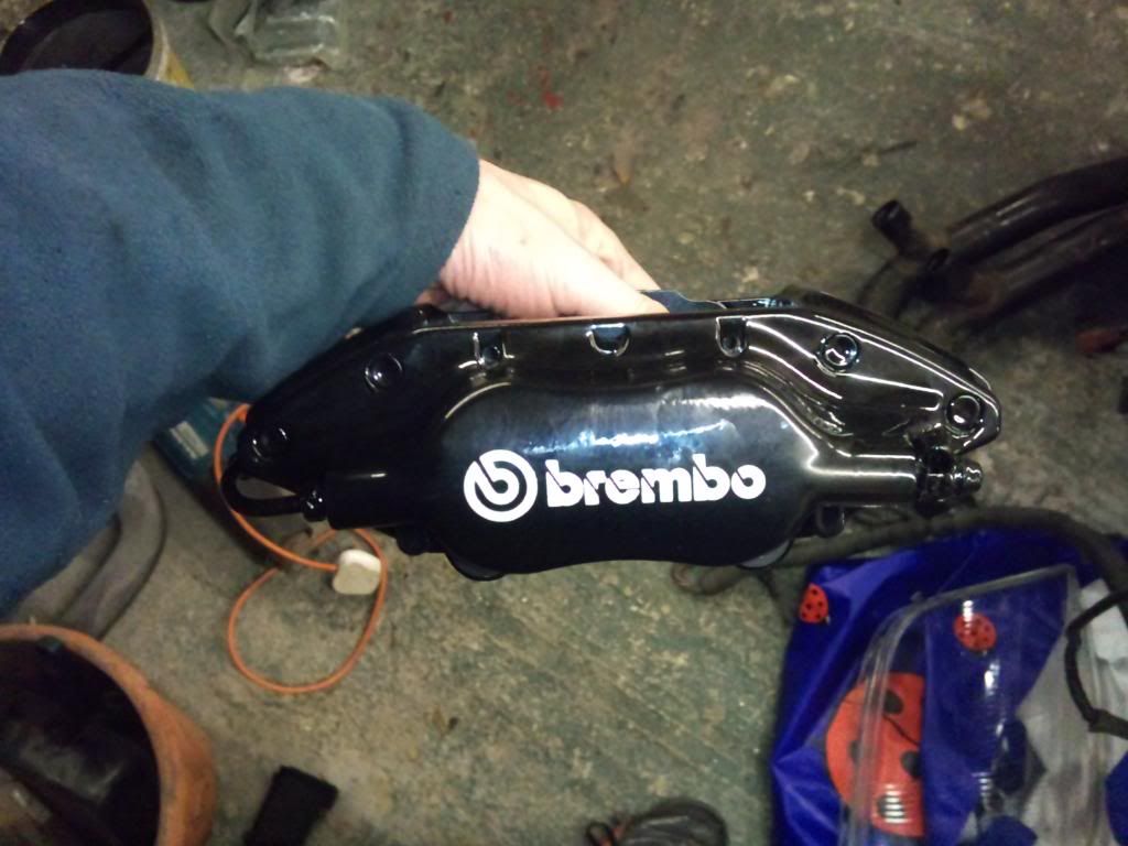

just started my big brake conversion today as well, picked up a brand new set of brembo 4 pots on sunday and im going to be fitting some 345mm discs so should be sweet, ill make a prototype bracket tomorrow to see if they squeeze under my 17's but initial offering up looks positive, ive got access to a few set of these calipers so if anyone is interested i could be persuaded to make up a few sets if anyone is interested (as long as this is allowed by club rules)

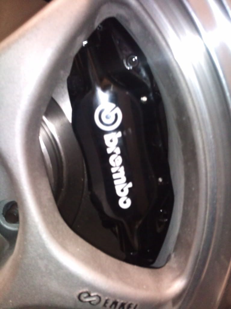

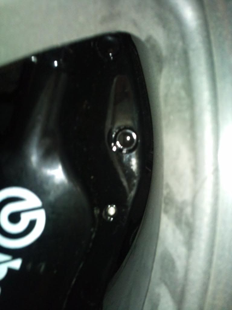

im nearly there with the brakes now though, made up a trial adaptor to fit my brand new brembos and the largest disks i dared to squeeze under my 17's
lookes a bit like this
not alot of clearance between the rim and caliper as you can see

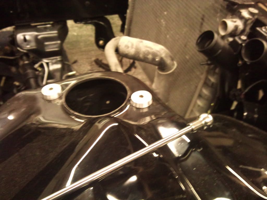

also cleaned up one of the side mounts, the only thing left to do here is the washer pump.

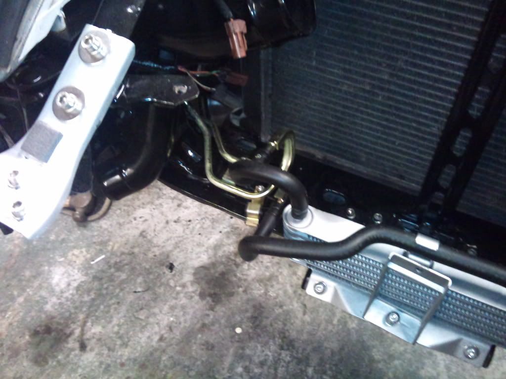

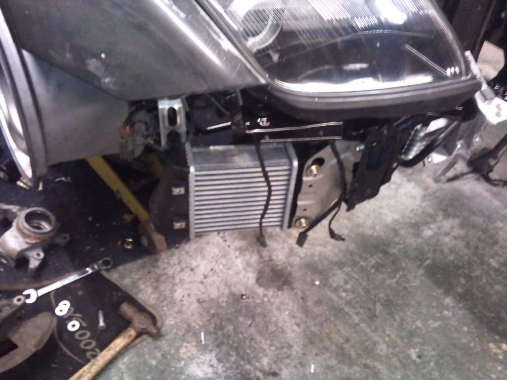

here is a quick shot of the cross member, most bits done, just need to sort out the pas return pipe. the radiator looks a bit grim but my new japspeed one turned up today so ill post up some pics once i fit it tomorrow.
finally a very blurry pic of the counter sunk strut top bolts, they are usually studs but i think thats going to look a bit crap so im adapting my tein pillow ball top mounts
tomorrow ill trial fit the rad and take some pics of my newly reconditioned front hubs

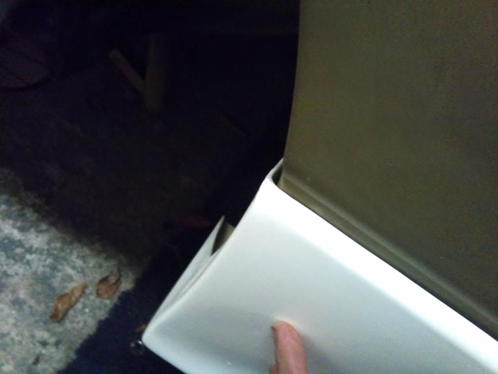

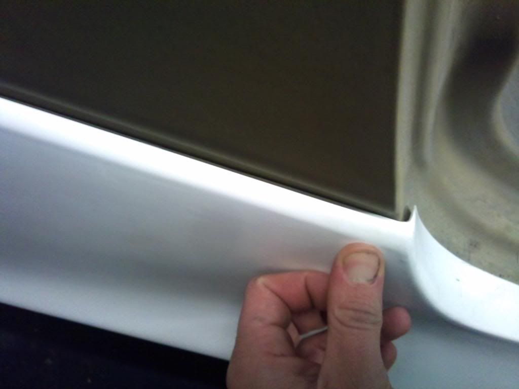

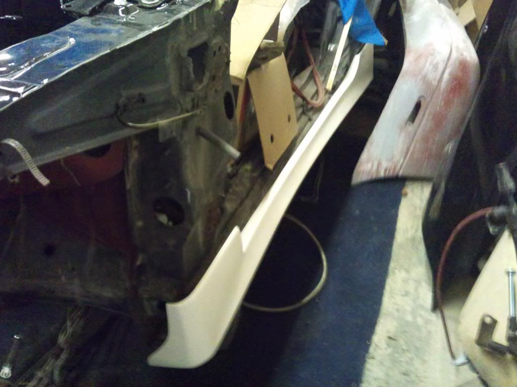

and a few more random pics i may have missed, generally of carmads excellent new skirts

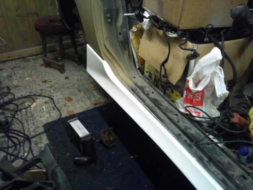

looking good, thanks for the pics. i actully sanded the skirts back to the size you gave lol..
they are a little thicker on the ends when i pull them out of the mould so im happy with that :biggrin
