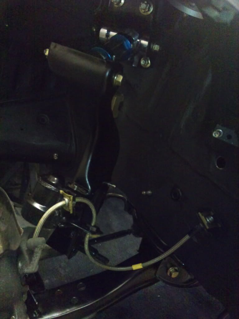

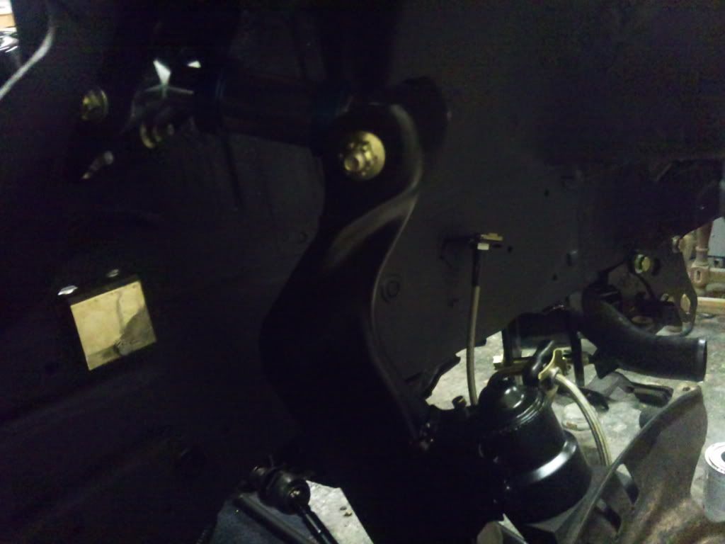

the front hubs still need to come apart so i can shot blast them and repaint the splash guards and bearing units. brake hose and clips etc have all been cleaned up though. will be a shame to drive it
Front tow hook with new bolts

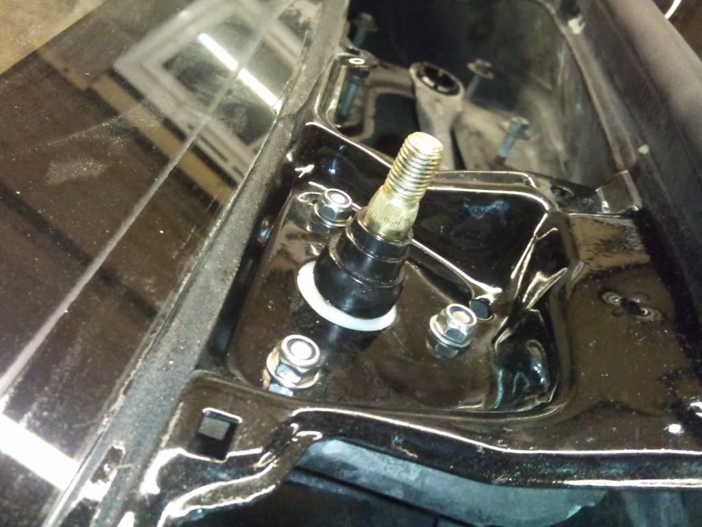

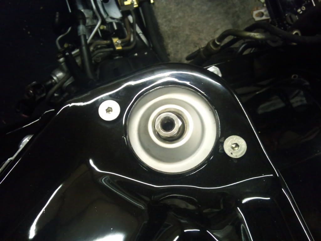

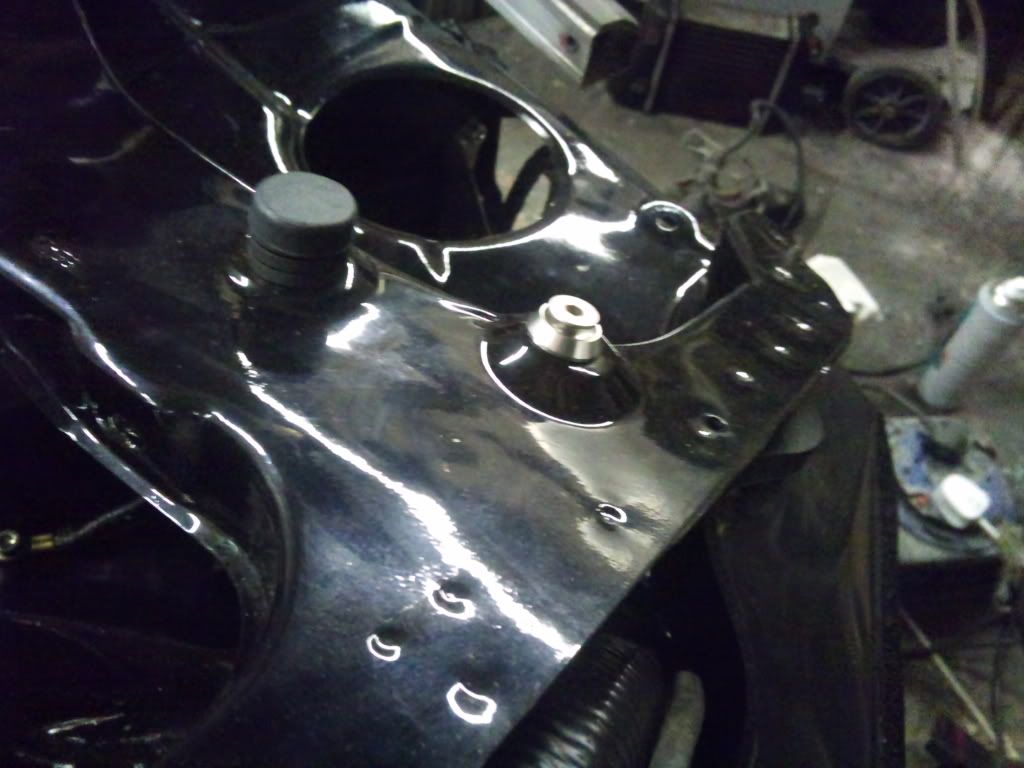

strut tops cleaned up. im modifying the pillow ball mounts to take screws instead of the studs for a cleaner look, they will sit in countersunk washers.

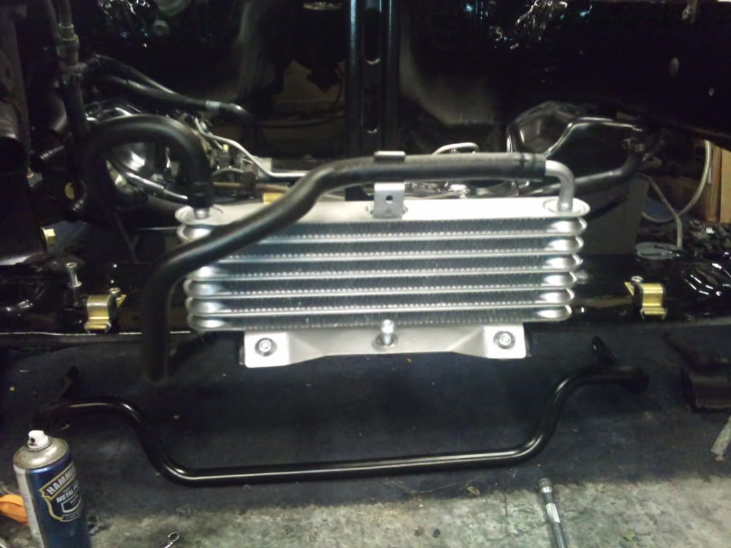

oil cooler cleaned up, took me ages to straighten all the fins

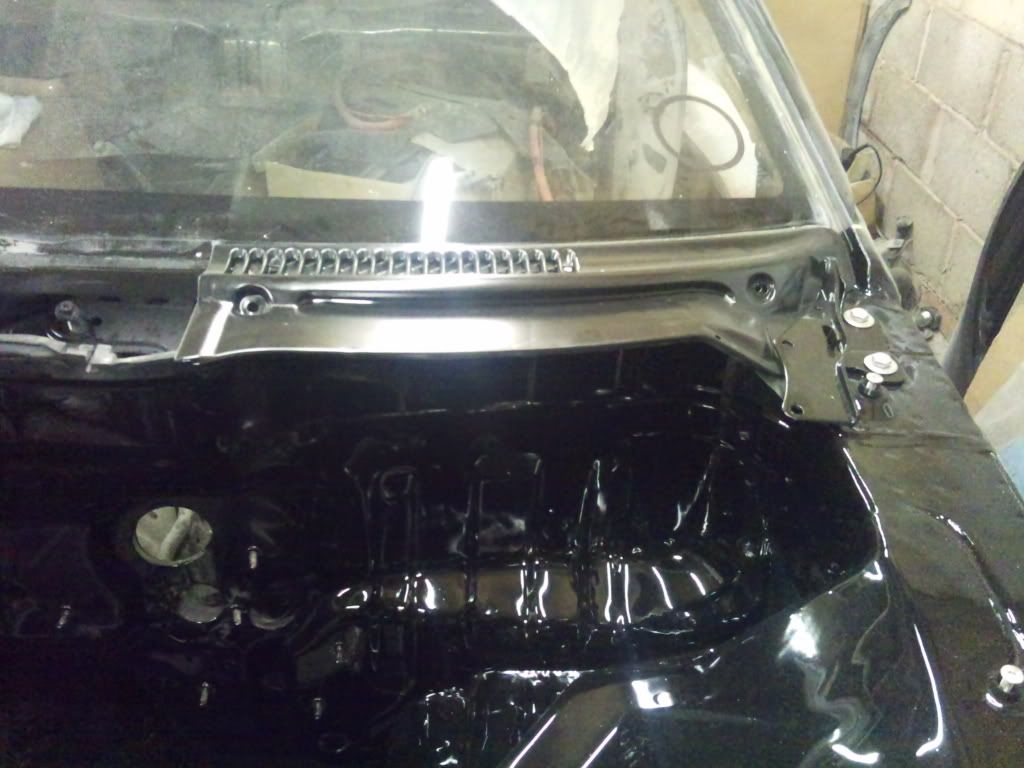

repainted the passanger scuttle but not to happy with it, i have a bit of a run and its a bit too glossy

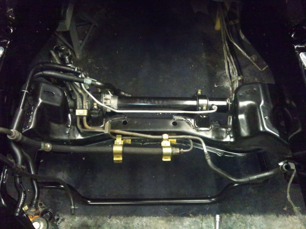

front cross member installed, still need to tart up a few of the pipes but wanted to get the layout correct.

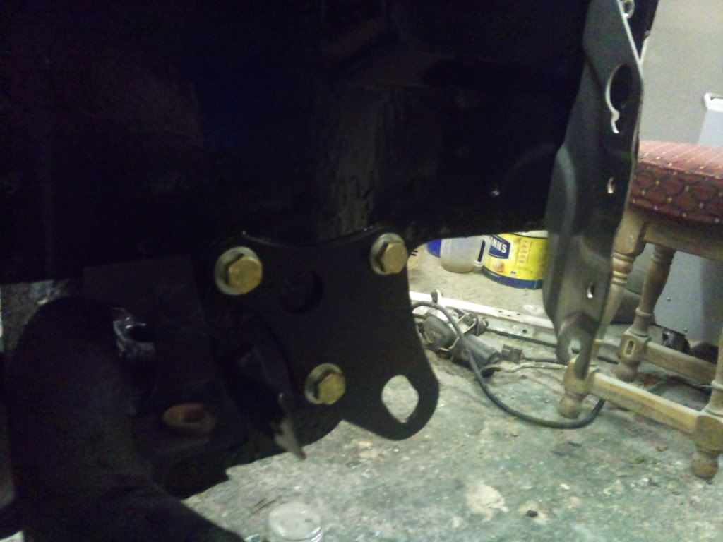

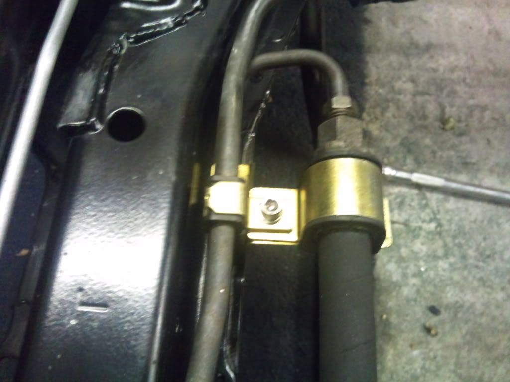

Had all the clips and brackets replated, they have come up quite nice

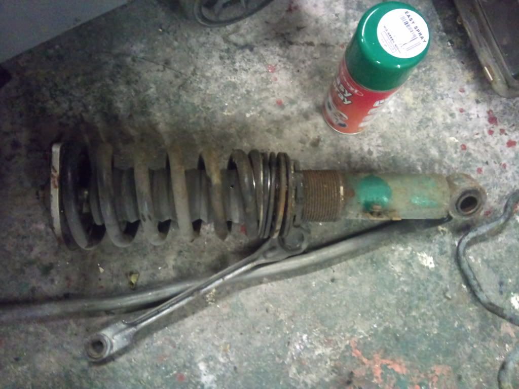

finally started on the coilovers too, this is how they started. typical tein they rust like hell. you can see the paint i found which is just about a perfect match for tein green

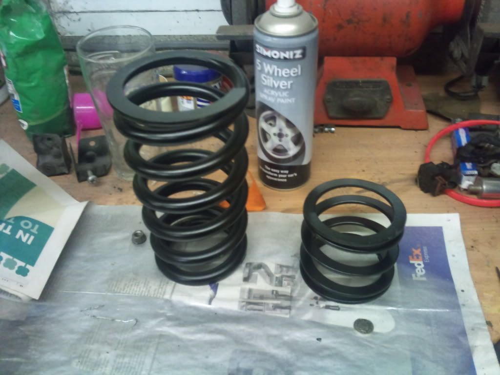

here are the springs after shot blasting and some satin 2k enamal

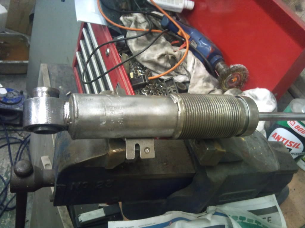

and here is a shock body after a good wire brushing
hope you enjoy, going to try to paint a shock tonight

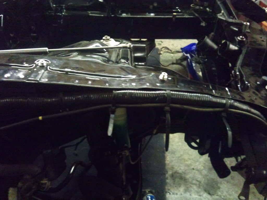

all ive been doing really is sorting out the wiring loom and cleaning up a load of brackets.

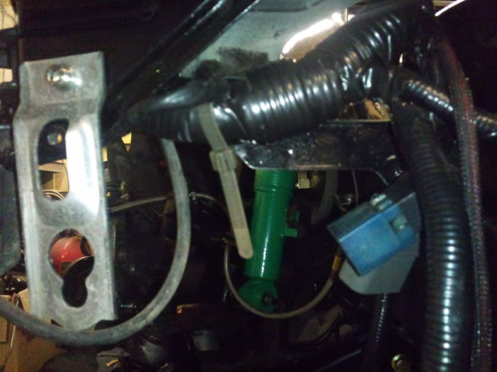

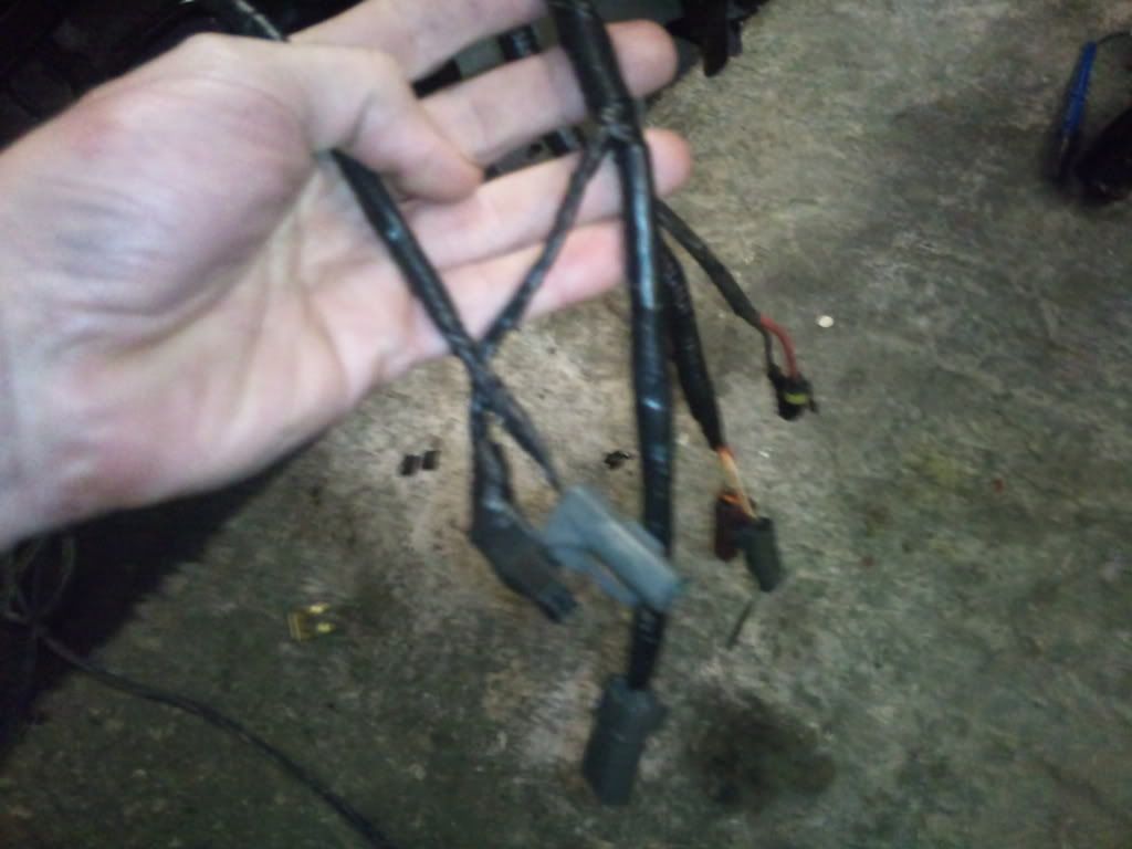

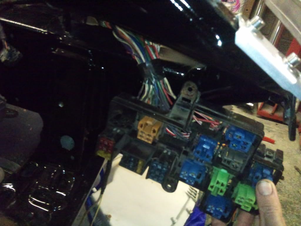

the wiring loom has taken quite a while as i dont want any wires in the bay. i have replaced all the conectors to the side lights etc as they were all hacked about, removed the hicas connections, moved the gearbox connections, hardwired in the hid connector, moved the fuse box down to the chassis rail under the nose pannel and relocated the pas pot connection. most of the wires are now bound up again and looks like new.

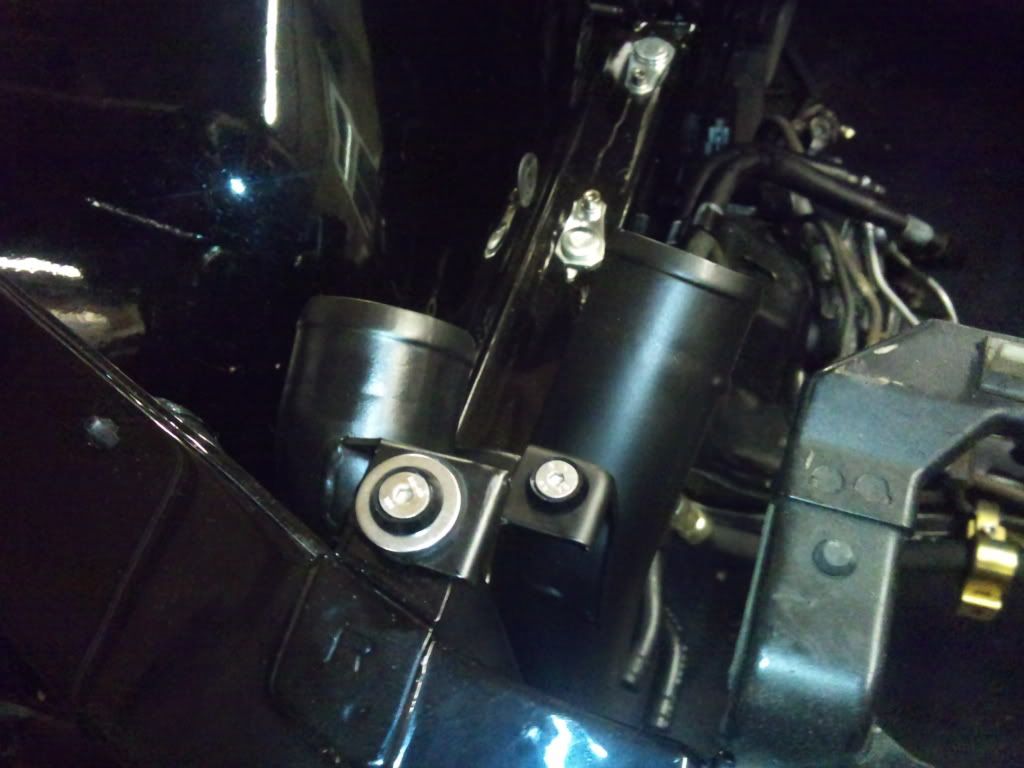

ive also repainted most of the intercooler pipes and had all the rubber mounting washers replated etc. going to replace the intercoolers at some point but std will do for now.

wiring loom re bound after rerouting lots of wires

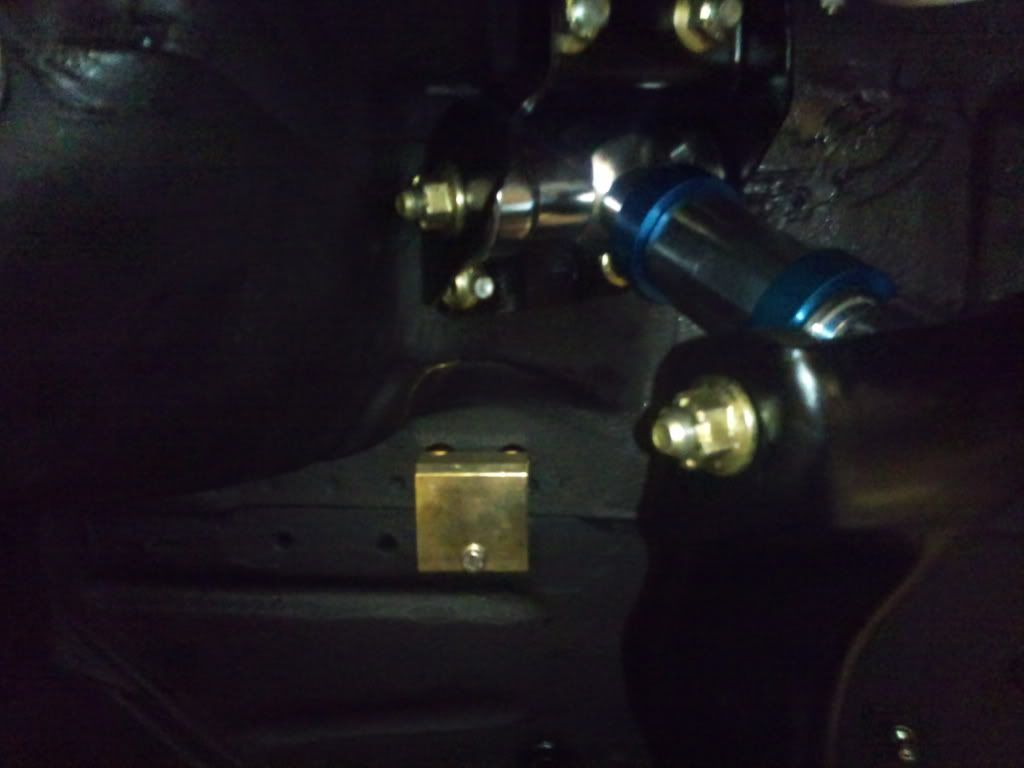

fuse box moved- i still need to tidy up the loom

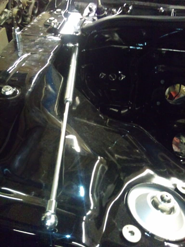

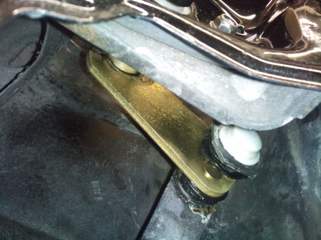

new bonnet prop
and various pipes and shiny fasteners
