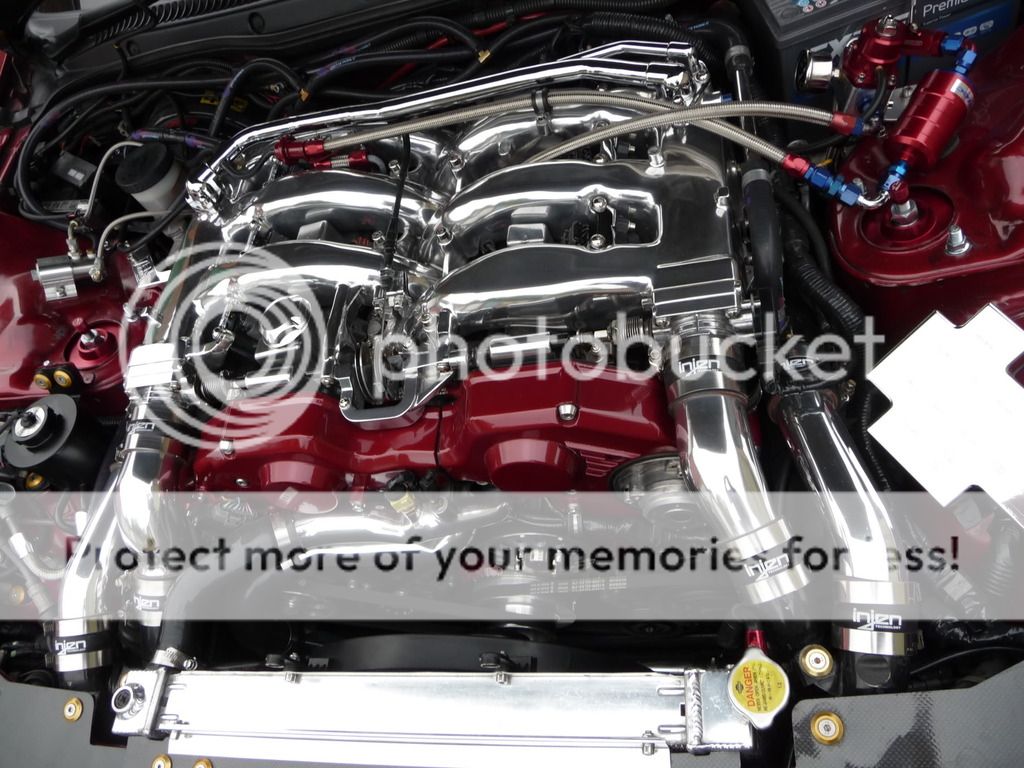

Yes it is!!
Here's a better picture.
This is an aeromotive copy. Had some good reviews by the Skyline boys running big power.
If your plan is to run bigger turbos and injectors later down the line, you will have a little more flexibility.
Nissan (Nismo) do an adjustable one for the 300zx so there is an argument that they feel it has an application (good enough for me!!)

However, Silverbullit had one and it failed! You can get more substantial pieces of kit for similar money.
Mine has been fine for about a year now and consistently keeps pressure. I've had the car on a rolling road and all seems healthy on the air/fuel ratio.
