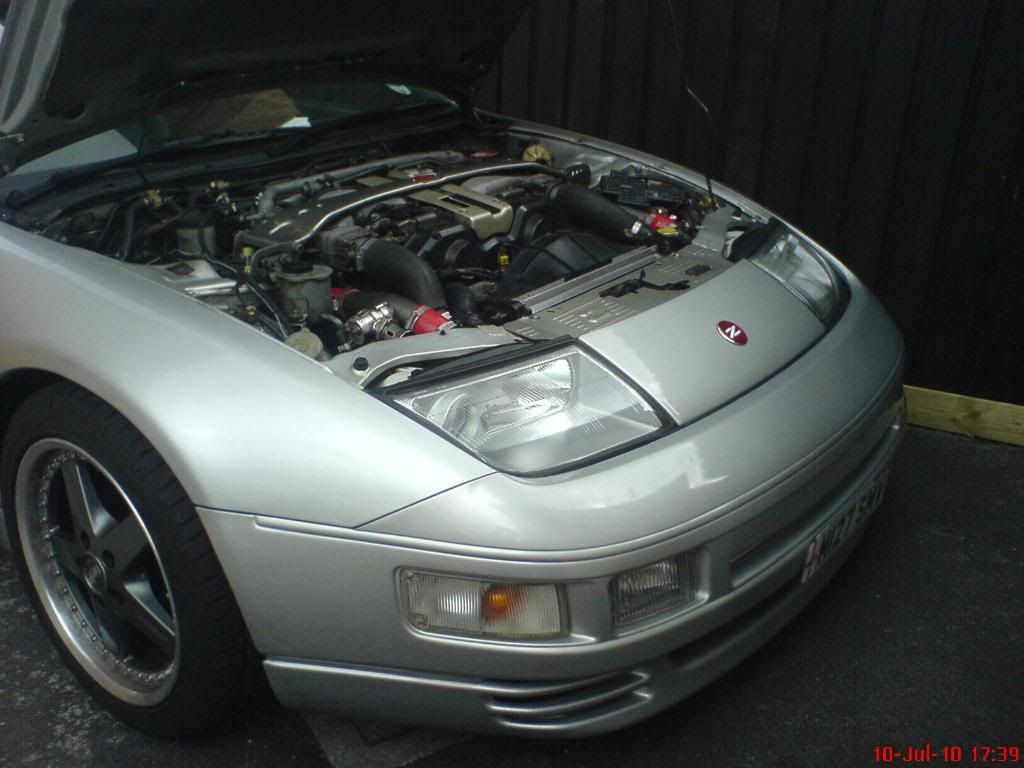

I used chrome fablon sticky plastic for mine, looks ok if you take your time, if you dont like the colour its not the end of the world to change it :detective:
Edited by daZvert

I did mine with a chrome rattle can spray, I think they are somewhere between silver and chrome
I wasn't sure I liked them at first but I am 100% happy :wink:

We're talking about the 99 inserts here, are we not? As opposed to the standard head light insides, of which the pictures posted have been? Personally I'd colour them 'see through'.... cos I can't quite see the point in 99 inserts... (IMHO)

I also thought the chrome looked crap but i have to admit, it looks kinda cool on Daz's car.
