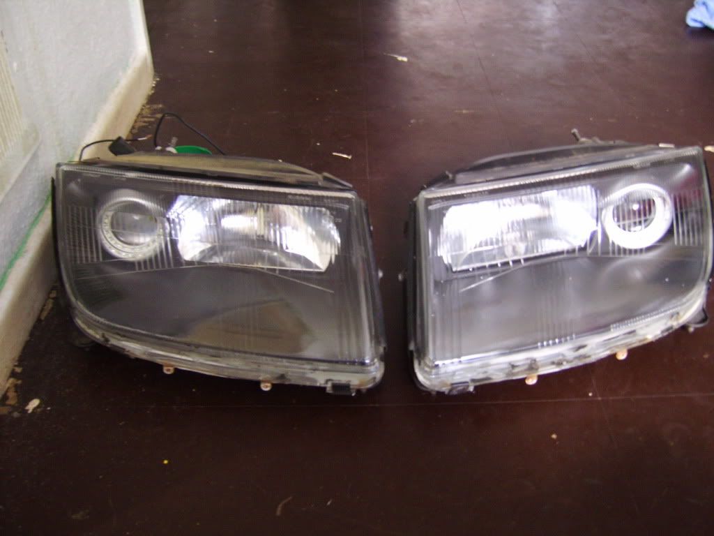

Just fitted my Halos, got some LED ones off of groover apart from having to extend the wire so they come out the back rather than having to drill holes in my housing, they are 70mm units so fit around the len's rather than around the out side housing. i was a bit dubious to start with, but now they are in they look quite good. just hope they look as good when wired up and on lol.
IMG_0015-3.jpg cant really see the Halos on the passenger side, but can on the drivers side.

should of waited to do it, but they look fecking good with the Len's housing silver.
Looking good mate. I would spray them black though. you can do it with one tin and only takes 5 min. It will give it a much deeper modern look :cool3:
As for a silver hand you should of used a latex glove :lol::lol:
The LEDs look sweet :cool:

lol yeah i found one after i had finished spraying them.. oh well Mrs thought i was waring nail vanish this morning cheeky git.
Im pleased with how the LED's look in there, didn't think they would suit the light, but once mounted and in, they look very good. just hope they work ok or im going to have to take the headlight apart and find out whats going on.
