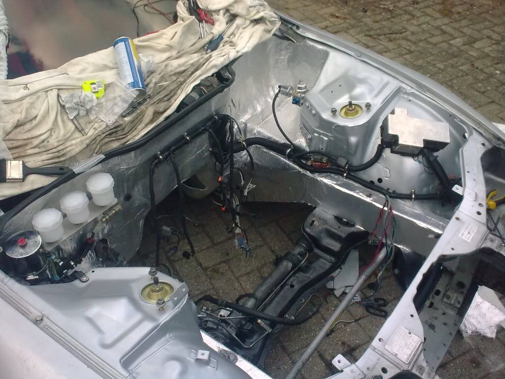

Just wondered if anyone has done the full works
so far i have
relocated battery to the boot
deleted aivs,egr, carbon canister and hicas
relocated fuse box to under nose pannel
going to relocate fuel filter to under wing
metal work wise im filling all holes, removed battery tray, smoothed strut tops/inner arches/chassis rails.
basically the only thing i want in the engine bay is the engine and brake servo.
has anyone done anything with the loom so it is simplified
was thinking of relocating ptu to under nose (should help keep it cooler)
temp sensor wires to come from under throttle cover
reroute the loom that runs along the sides of the engine.
has anyone relocated the small fuse box near the brake servo?
my aim is to make things as simple as possible/hide wires and make access alot better. obviously im going to have to cut/extend some wires but that will be good as i will basically make a new loom.

I,ve been trying to do something similar , smoothed the inner wings , relocated the fuel filter and the fuse box and using a different power steering pot sunk into the inner wing , engines now back in and i,m connecting everything up but it is difficult to keep it looking uncluttered as there,sa sooo much to connect !!

got a bit of a stealth plan for my pas pot

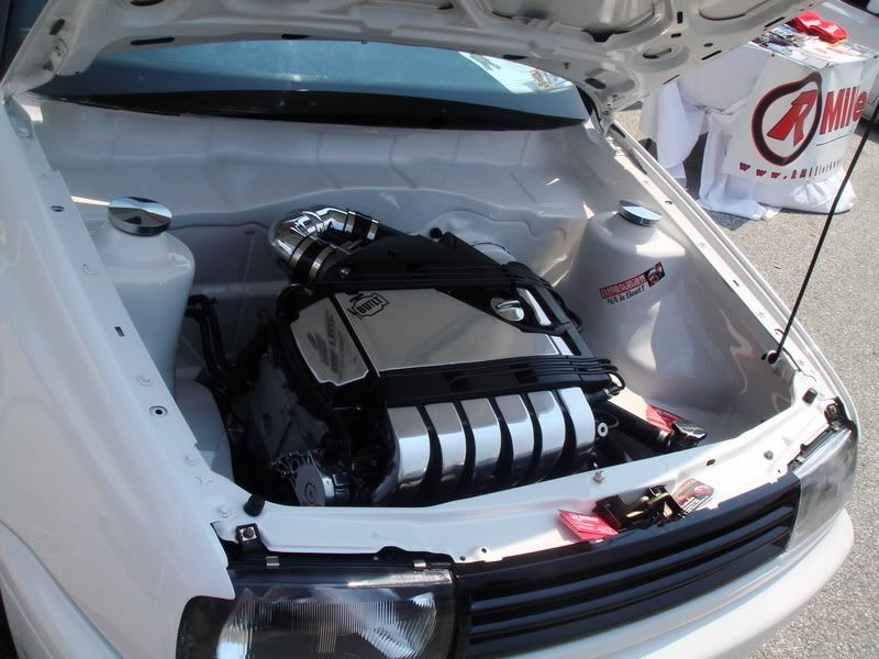

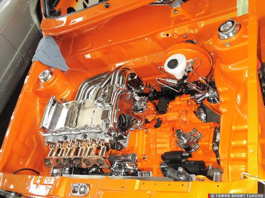

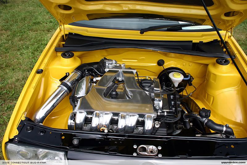

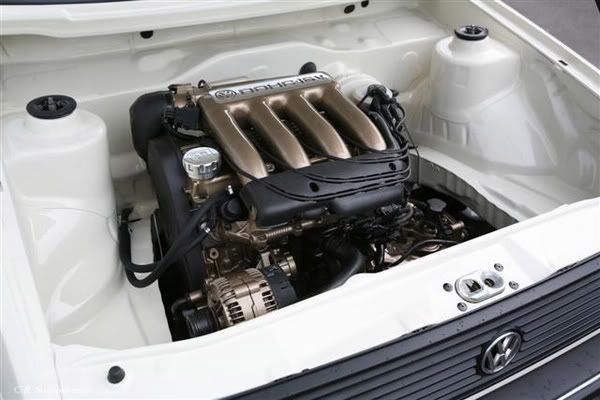

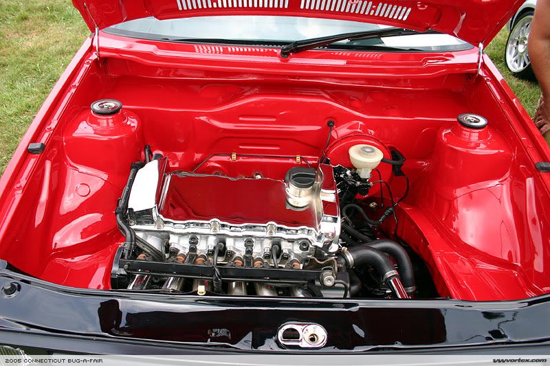

here are a few pic to show the look in after
ahhh, you're after the engine and fec all else look :D
do-able on a VW, and if you pull it off in a zed, my hat will come straight off to ya ;)
check out madmaxs engine bay im pretty sure thats about as tidy as possible
he still has pas pots and a few odds and sods going on. i would really like to try to go for this look. only problem is that the zed engine is a little on the big/complicated side.

I relocated as much as I could reasonably do on mine, but left the battery tray as I have a big audio build planned for the boot. Also because mechanically it was a big build I have a big rad etc and pipes for NOS etc.

i am trying to really push the boundries but im a bit stuck on the pas pot.
i was going to mount it low down with only the cap poking through where the washer bottle is on the lwb (mine is a shortie). however after thinking about it i think this will be lower than the pas pump and will end in the fluid leaking out so no good.
i might try to get it under the nose pannel but its going to be getting full under there with a large filter, fuse box, hid balasts, intercooler pipes etc.
its the rewiring under the plenum that i think will cause the most grief. i dont want any visible wires/trunking unless un avoidable.
plan still stands as only visible parts to be the engine/brake servo and clutch pot. but i might move those too

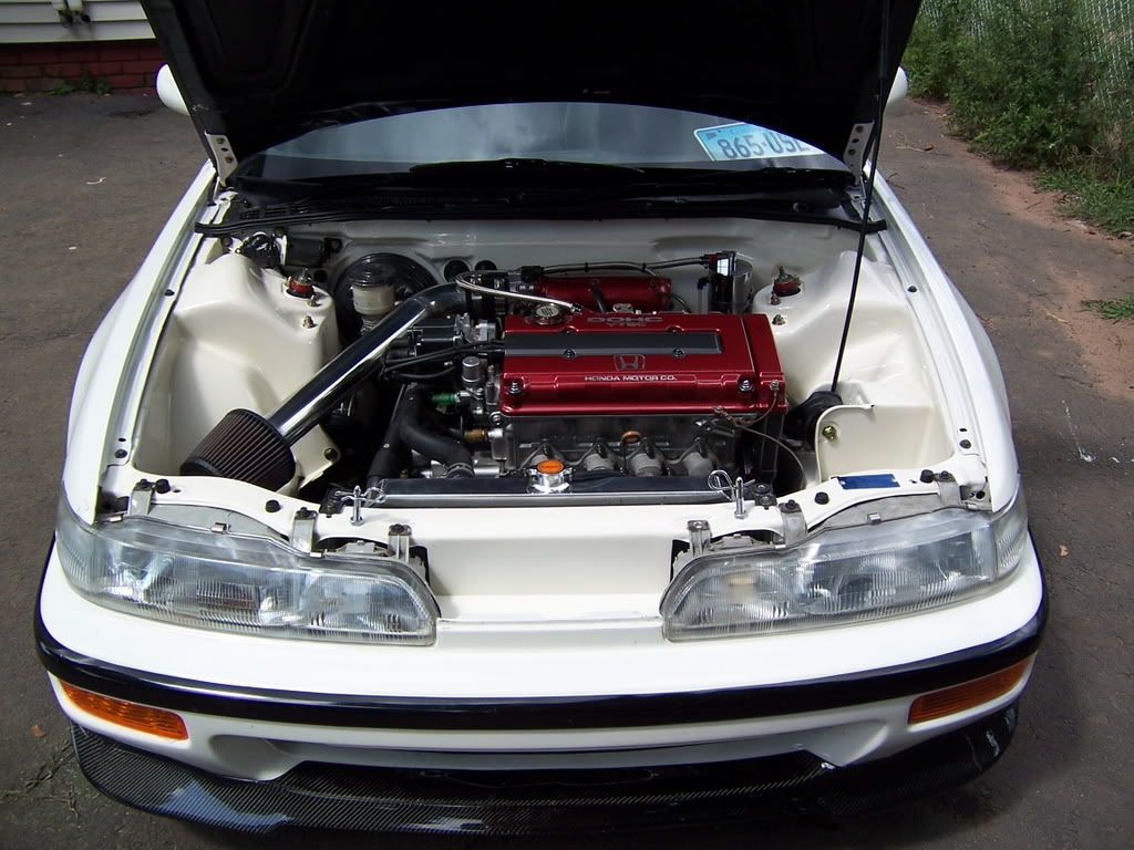

I,m just trying to get a cleanish uncluttered look like this one
love the plenum on that. i think its ceramic coated
