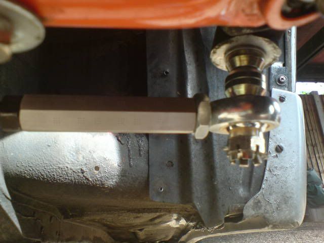

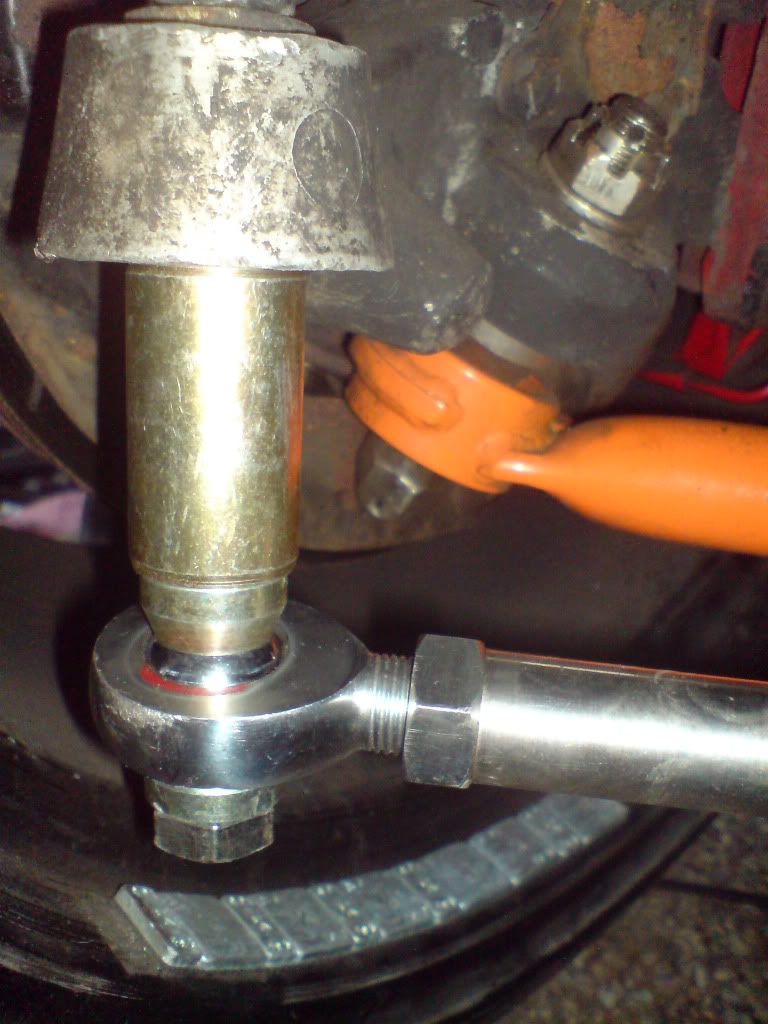

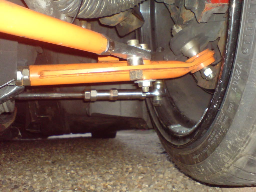

Heres what i have done. Still going through a few tests, the tracking is way out now so a full alignment will be needed, still haveent had it tracked since i fitted the lower arms i just lined it up best i could by eye.
Before spacing the rose joints:
notice the angle of the steering arms. WOW seriously out.
Heres what the setup looks like:
check out the corrected angle, much better:
I will take it for a few test drives just to make sure nothing bend/breaks or comes loose. I may have to change the size of the rod that attaches to the hub for more strength and safety but it may not need it.

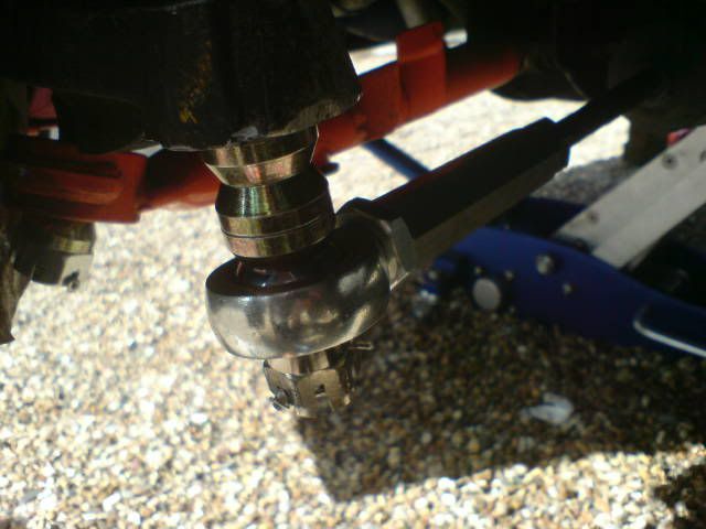

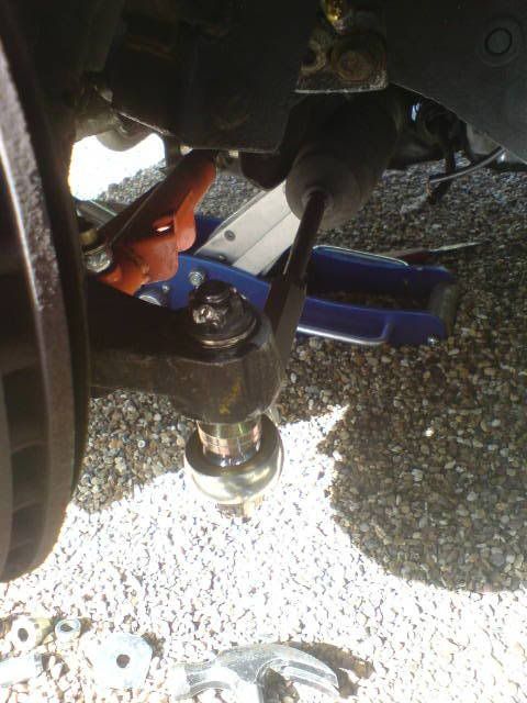

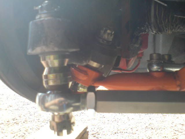

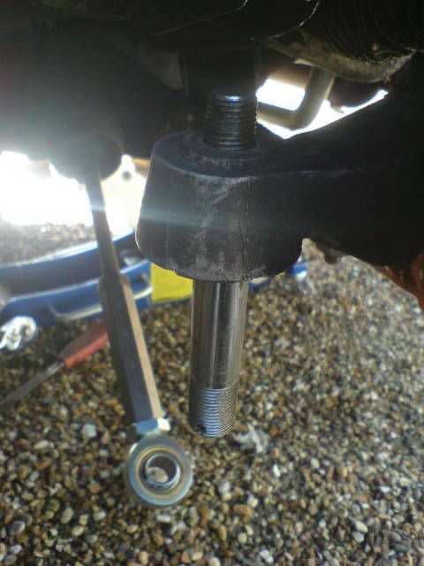

OK :)

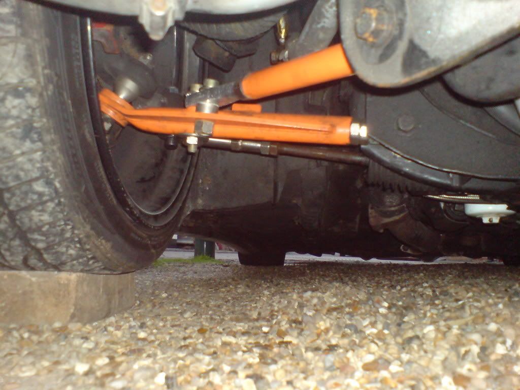

heres the changes.
Now using an m18 bolt which tapers into an m14, the rose joints are m18 along with the spacers, now using castle nuts with pins inside to prevent them loosening. Also have pins in the lower arm nuts :)
The steering rods and lower arms are as close to the same angle as possible by eye.
What we think now?
Next things to do are replacing the lower grade steel nuts on the lower arms with grade 8 or so which i have already just waiting to be fitted along with a stronger washer.
P.S the lower arm nuts are touching the brake guards but i can assure you they do not touch the disk EVER.
Edited by j1mmytt
nice work but you do realise that its the centres of the ball joints that you want to get in line, not the physical arm?
Your very wrong, the steering arm has to be the exact same angle as the lower arm. They must be parallel. You could not be more wrong lol.

Thats exactly what you dont want it to do. On a lowered zed thats what the suspension would be doing on compression due to the change of arm angles, so when turning right the left front wheel will turn outwards on compression meaning you have to turn the wheel more to get the right amount of turn you need then when the suspension decompresses you turn in too much meaning you have to keep adjusting the steering wheel, not ideal at all. Found myself constantly battling with the wheel to get it in the right direction. This mod should make a huge difference.
all im saying mate is dont assume that the centre line of the arm is parallel to the tube in the vertical plane because its not. its the centre line of the arm ie the theoretical line drawn between the centre of each ball joint that you want to be parallel to

I think the z32 has slight bumpsteer as stock and the lower the stock arms sit the more the angles become uneven, My steering arm angles were way out due to the aftermarket arms which sit at a completely different angle to stock, so mine was completely pissed causing unwanted steering on heavy cornering which was very noticable, Now the steering feels miles better and it turns in alot quicker, im going to have to add some toe in on the rear as i have too much oversteer now. Might even adjust my rear toe arms somehow to compensate with bumpsteer, but il have to work out what the rear is doing in terms of steering under compression, could end in disaster if i get it the wrong way round lol
