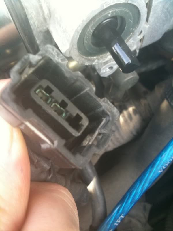

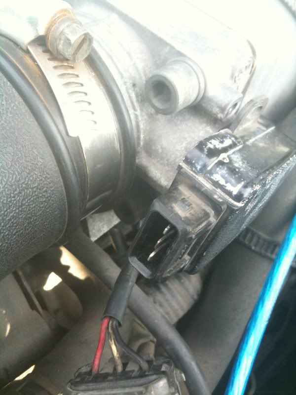

Just looking at my TPS sensor, just to see what it was doing.. is it wrong that i have only 2 wires going to the 3 pin connector? i dont understand why they would have 3 pins.. but 2 wires..?
I looked at the connector boot which has corroded through, and only 2 green wires are inside... which makes me think its always been this way.. but im just reporting on my slightly odd findings..
Also.. what are the procedures in a 'checking your tps - for dummies' sort of manner... I got 9.63 at min and 12 at max, which if you read in this guide..
http://www.zhome.com/ZCMnL/PICS/hesitation/hesitation.html
(you should look about 5/6 down the page and theres a picture heading the text of a tps with a green, yellow and red arrow)
says that 9-10v to 12v is often seen when looking at the idle.. but i read something else.. the erratic idle pdf, which says by connecting the middle pin to a multimeter and then the meter to ground, you should get 0.45ish at min and 4 at max...
(after reading again... I think I might have gotten the two plugs mixed up in my head, the plug in the photo above is for the idle, not tps, and the 3 pin plug also attached is the 'tps' side of things... i'll measure that again later...)

at a guess it could be that the TPS is used on other Nissan models and doesn't need 3 wires on a 300 hence the loom has 2 connectors. Can check my car tomorrow if it helps
I think I was just confused between the connectors, after reviewing a video of the TPS being pulled apart on the net (it was really good actually, all about z31 though http://www.youtube.com/user/LastHumansGarage#p/u/40/1Kn-2vu1IxQ) I could see that the one I thought was the TPS connector is the idle connector, thus only requiring the 2 wires.
