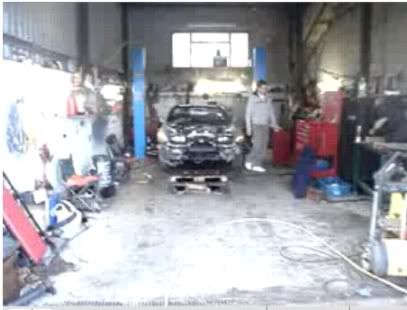

I used to run a business sharing a Unit next to SWZ Performance.
Edited by Yowser
Not surprised you got fed up then what a hole that was, still find it difficult to understand owners leaving cars at places like that, oh well onwards and upwards for you at least eh?
