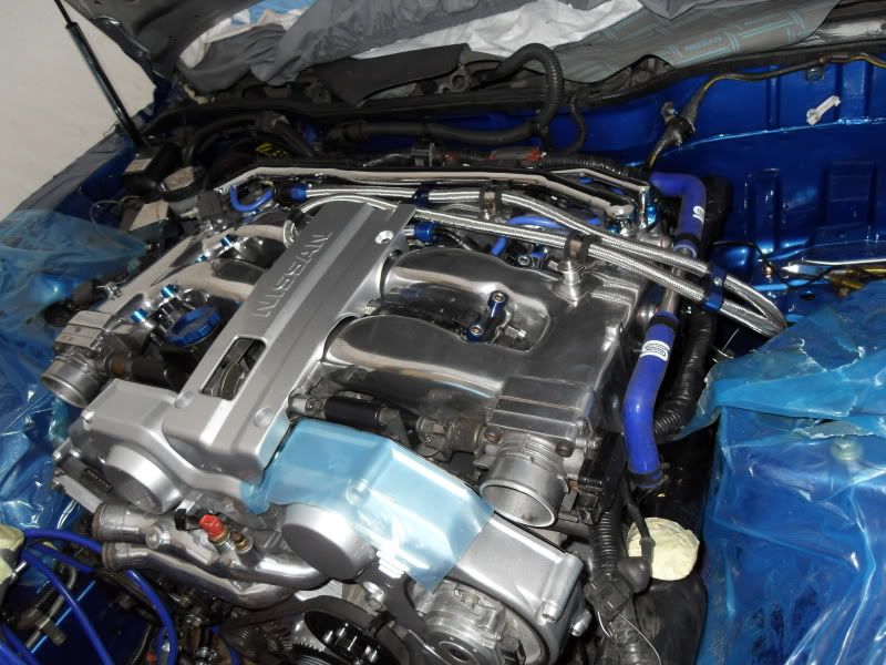

Finally got the engine bay painted and would you believe my neighbour looked over after i,d painted it and asked what colour i was having it :headvswal:headvswal:headvswal
I,ve deseamed the front section of the innerwings and modded the O/S to take a different P.S pot .
Gonna try and get the engine and box back in next weekend !!

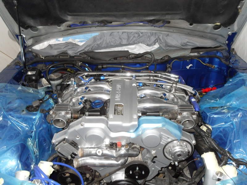

Well the lumps in i,m just trying to connect it all up and keep it tidy at the same time , got a bit to go before firing her up , once i know it runs ok i,ll get back to doing the bodywork :scared:
Do I spy an Earth strap on that first pic?:clown:
There,s no flys on you bud :thumbup:
