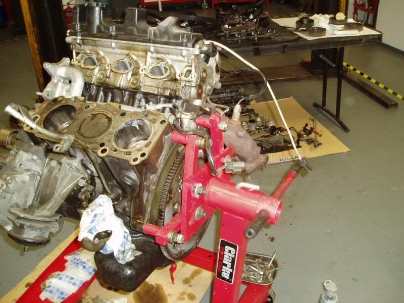

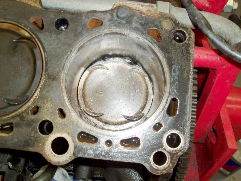

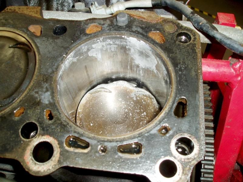

Misfiring, smoking heavily, and low on power, this zed had lost the end off the spark plug on No 6 cylinder, pulling the motor and stripping down showed the full extent of the damage, the turbo also had suffered damage too.
Overboost, detonation, fueling issues, any or all but my guess is detonation caused by over boosting, on what was a loverly engine just weeks before.
Jeff TT
You know why it was overboosting? Did it have boost jets or was the EBC set too high?
That looks more like running lean to me
EBC settings messed up :nono:
Jeff
so sorry looking. pity that people dont really care about z what they care is to show off or perhaps squeeze maximum and more from them motors ..((((
Gain was way too high then?
Settings made no sense, massive gain with low set made would have been pulsing like a bugger, reason I prefer to keep the boost solenoids connected and then at least when the det sensor operated the boost set and gain even out for a few seconds and hopefully save the engine.
