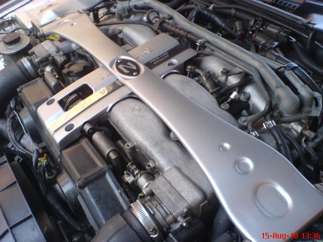

I think you said Daz that there was some slack in your throttle cable :confused1: certainly there was in mine, well today I took the cover off and tightened it up. Firstly I got the engine fully warm with the revs nice and settled at 800rpm, then tightened the nuts as far as they would go without it lifting the revs. Perfect now :clap:
At the same time I cleaned and silver sprayed the throttle cover, re glued the chrome cover, sprayed up the strut brace and the black Z in the centre :thumbup:
All looks a million dollars but the tight throttle cable is the most pleasing :biggrin:
that looks really ncie mate!!
where did you get the stut brace from?
LOL
From the STUT,STUT, STUTTER SHOP :clap::clap::clap::clap:
i have not got the foggiest :taz: wish i knew.
it was on the car when i got it.
it was just a little rust bubbly in places - in need of just a little TLC. :cool3:
