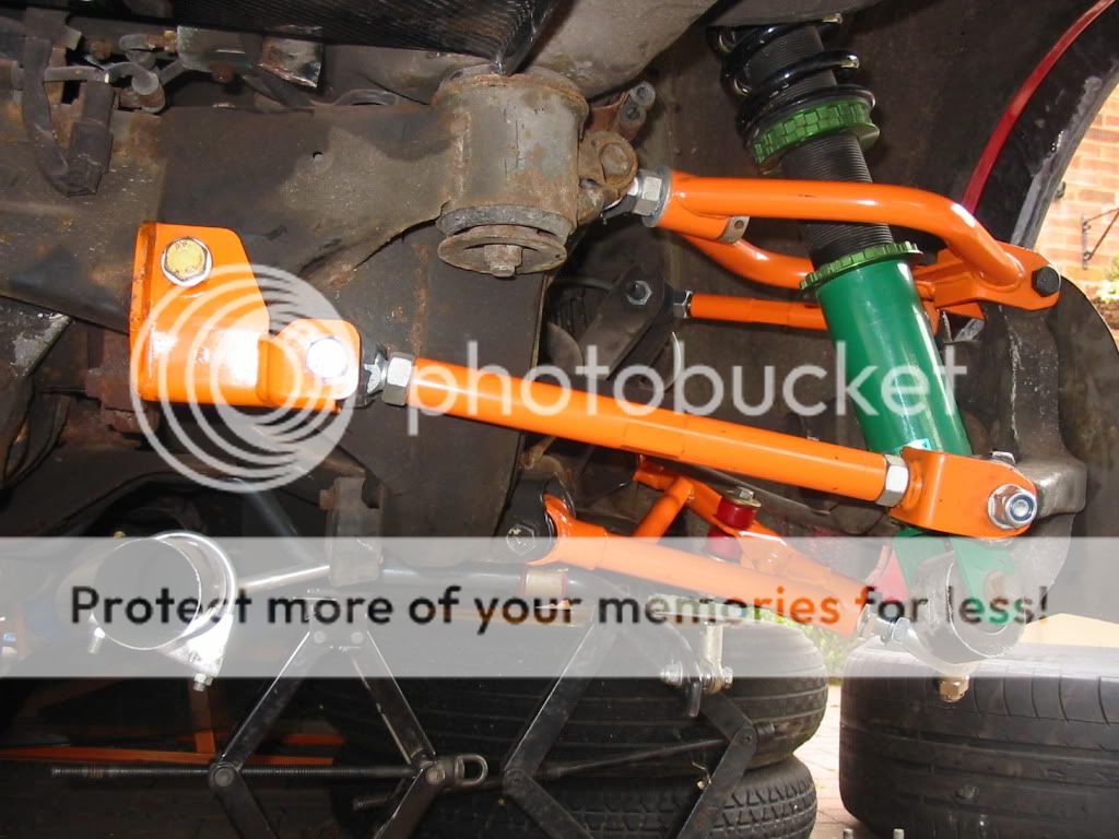

The underside of my 'Z' looks like an advert for 'ORANGE MOBILE PHONES' at the moment
Now running with :
- DRIFTWORKS FRONT LOWER ARMS
- DRIFTWORKS FRONT UPPER CAMBER ARMS
- DRIFTWORKS TENSION ARMS
- DRIFTWORKS REAR LOWER ARMS
- DRIFTWORKS REAR UPPER CAMBER ARMS
- DRIFTWORKS TRACTION ARMS
- DRIFTWORKS HICAS REPLACEMENT KIT
I basically bought and fitted every component from DRIFTWORKS that can fitted to a Z32
DRIFTWORKS FTW! :punk:
That isnt a standard camber arm its aftermarket and so adjustable. Its just old! I have a standard one at home I can photograph for you, that came of my car on monday.
Fronts = no (thats not stock in pic)
Rear = yes...some adjustment. The bolts use an offset eccentric bolt head, and is a common oem fitment in many vehicles.

on the stock upper arms some people use spacer plates that sit behind the bracket to space them out to get a mild adjustment in camber. but i personally went with the full adjustable jobby as in the pic. but mine are coated in a smear of grease to stop them looking like they were just taken off of the titanic!
That dirty old thing aint mine..
Ouch!! that "dirty old thing" is mine and I posted it to someone because I need a new one.... and as it's been poited out they are not STD. poo, what to do...
