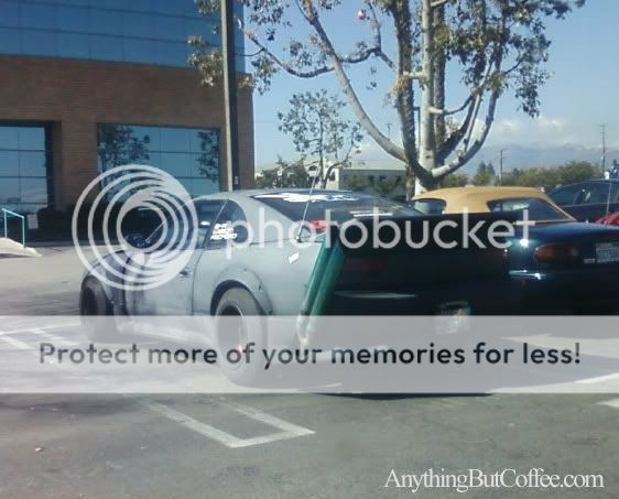

Some guys in the States are running chopped steel side pipes on a variety of rides and are running sub 8 second quarters????
