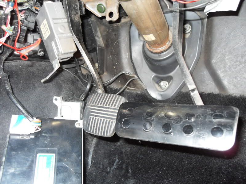

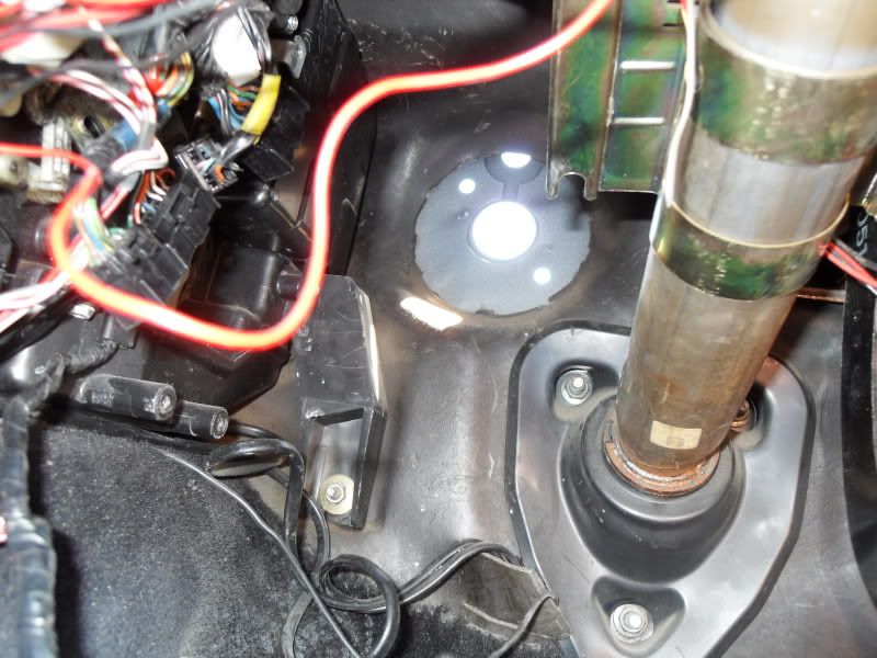

Not to bad to do without removing the dash , just need to remove the lower trim panel and the air ducting under the dash , i had to drop the control unit on the side of the matrix to give a bit more room , if you look up under the dash there is an electrical box of some sort that is bolted into the threaded hole the clutch pedal uses , so drop that out of the way .
The clutch pedal ready to go in , took a bit of shoe horning but it went in quite easy !
I cut down the auto brake pedal to the manual size

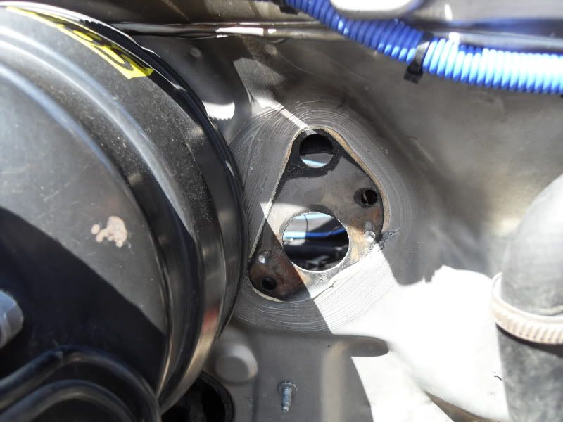

Ftted the master cylinder and re-fitted all the gubbins and bobs ya uncle , quite an easy job , no need to take the dash out.
