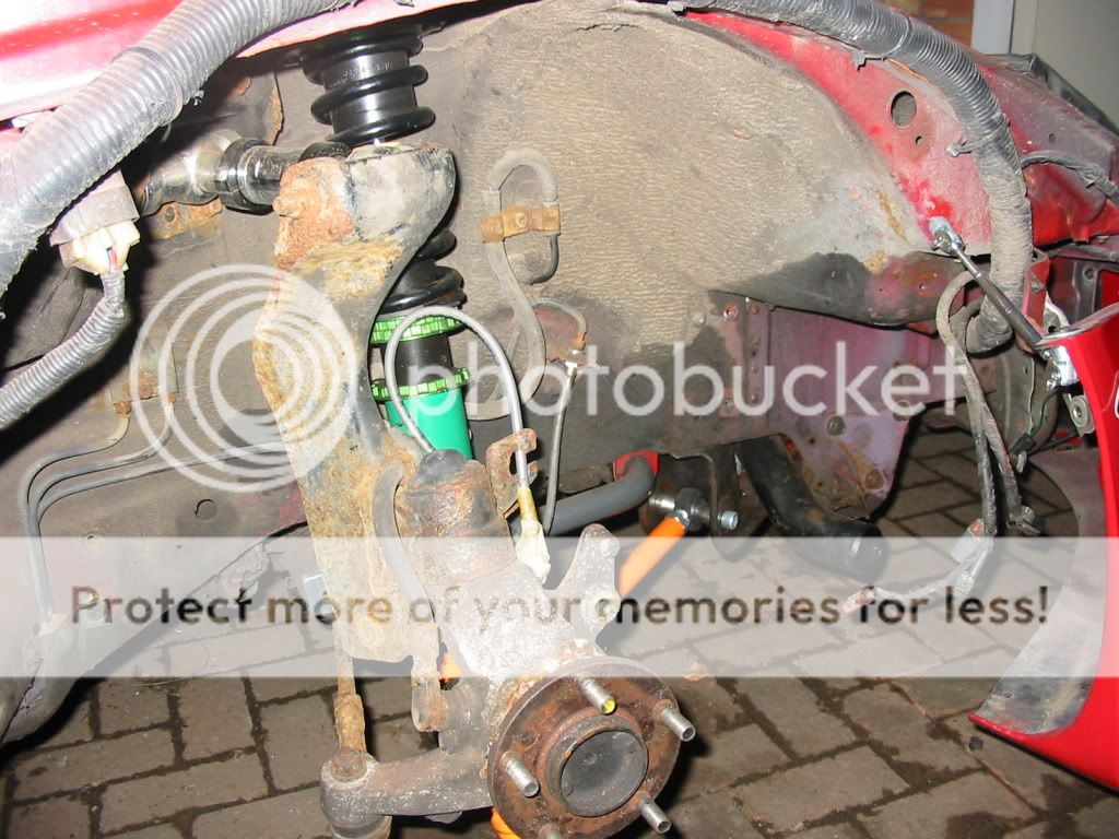

-all steering/supension has been replaced with upgraded after market parts from TEIN/STILLEN/WHITELINE/DRIFTWORKS

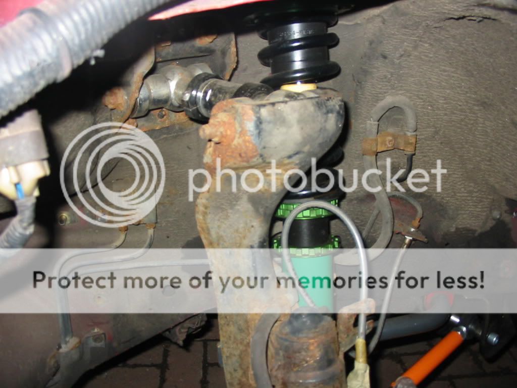

Loads of DRIFTWORKS goodies, TEIN TYPE FLEX coilovers (with EDFC), STILLEN anti roll bars, CZP & WHITELINE droplinks

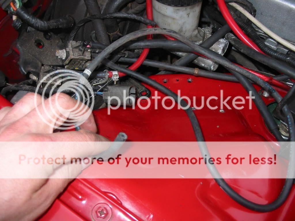

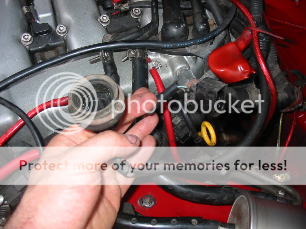

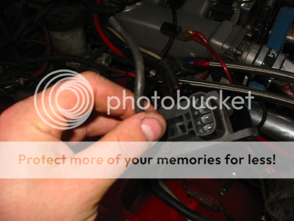

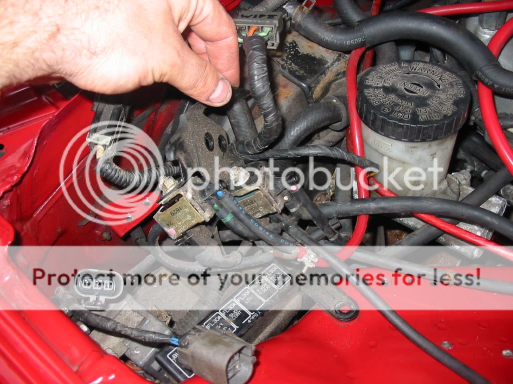

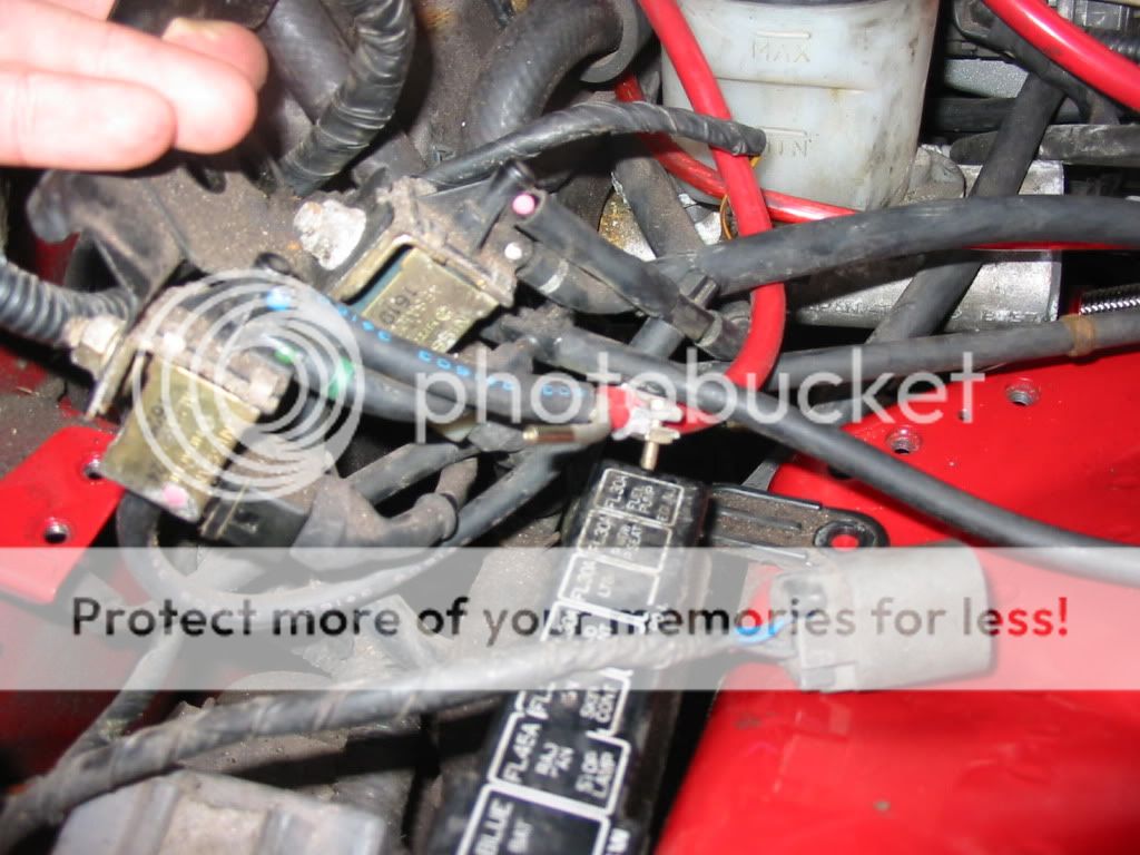

Has anybody documented (with pics) a comprehensive list of exactly what excess piping etc can be removed from the Z32 engine bay?
Robo`s site has just exactly that
http://s95014253.onlinehome.us/63104/13202.html
Or look at MADMAX`s site he has done alot of removing bits and relocating bits
Marty
Useful link, thanks mate
though, with the Z in the pics being a left hooker, it does add an eliment of complication
I had the laptop sat on top of the plenum using it as a reference.

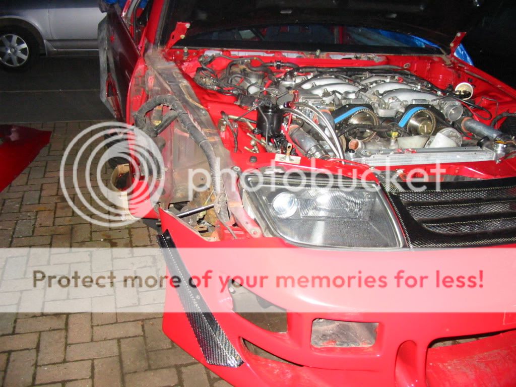

After plenty of back and forth for confirmation, I think I've tied down where most of the pipes lead.
Every pipe, solenoid and cable that is not required is coming out over the next few weeks
I have to determine now whether all of the parts that are no longer required (EGR etc), can be removed with the engine still in situe?
more research required
yes ecu doesnt mind at all if you delete all unnecesary hardware .. it only senses erors from main soleniods..
Rgr
this could take some time but it all needs doing
any pipework that stays (big or small) is gonna be replaced with SAMCO anyway, as it's all knocking on for 20 years old
I'll take pics

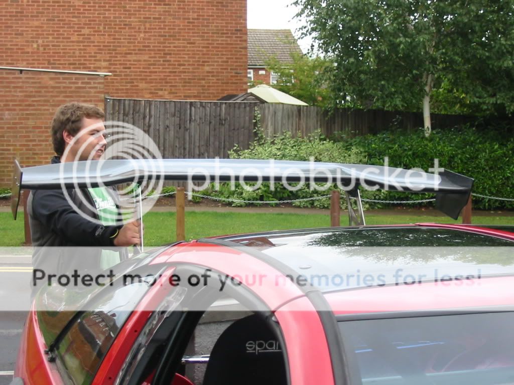

Just an update on the 'Z's progress.
Well, let's see.....
first off I decided that I wasn't entirely happy with the look of the replacement carbon wing that I imported from the US back in January.
There was nothing wrong with it, but it I missed the old JDM drift look (despite previous attempts to convince myself otherwise)
So, having decided that the 4th wing on this particular 'Z' wasn't right I was on the look out for a suitable replacement.

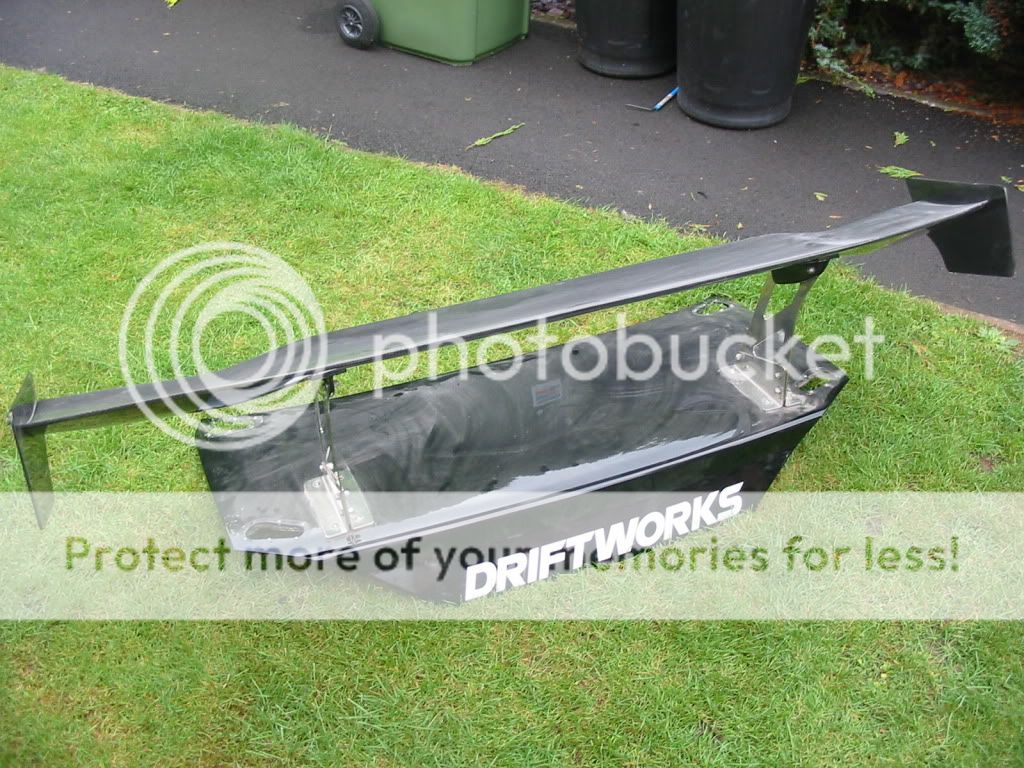

It wasn't long before I spotted that Phil Morrison (owner of DRIFTWORKS) was selling the HUGE carbon wing off the DW S15.
Now this was a serious piece of kit!
It was a genuine ORIGIN carbon fibre wing and was top quality, so I figured that it was an oppertunity that I couldn't pass up
I soon realised that to import one of these would cost in excess of a grand!!!
I contacted Phil and eventually agreed on a price.
The following day (Thursday) I took a slow drive up to DRIFTWORKS new premises to take ownership of my new wing.
The DW S15 boot lid was also thrown in for good measure; which will be sold on shortly to a 'drift pureist' to re-coup some of the cost.

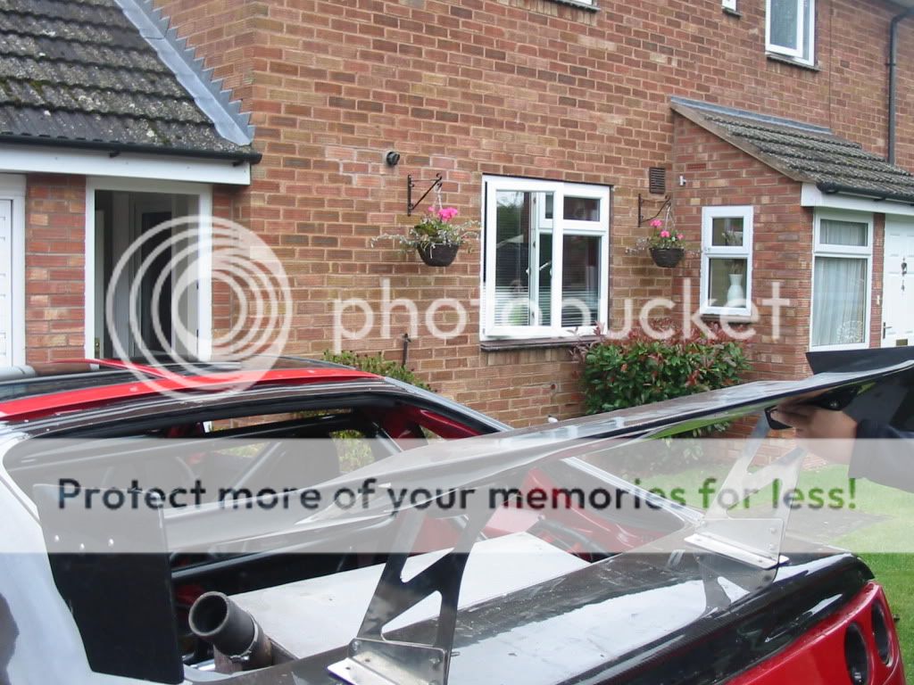

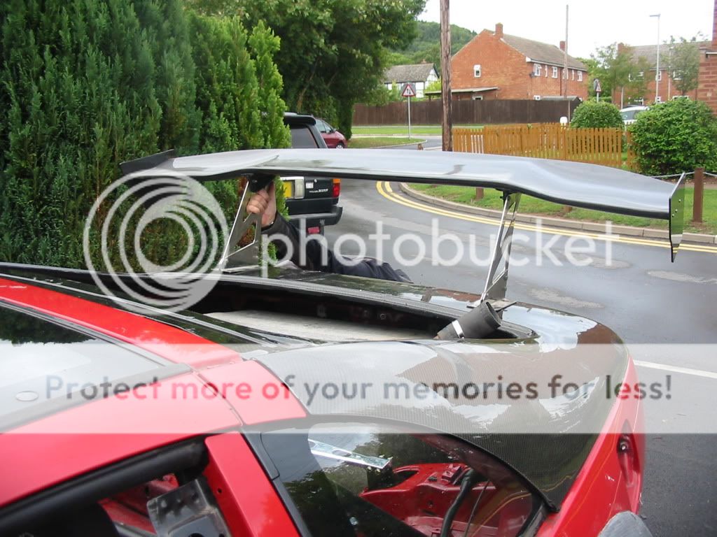

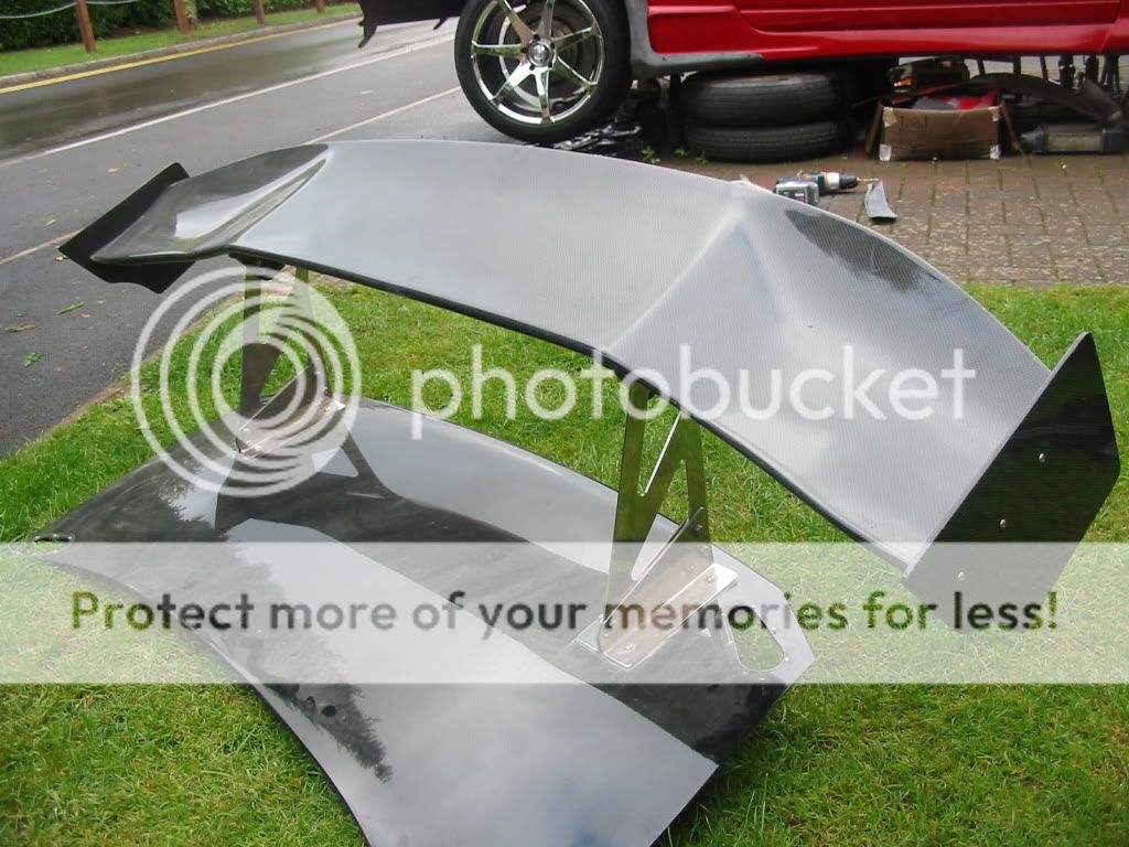

A mate of mine, 'Ted' (another DRIFTWORKS regular) popped over to my place this afternoon and helped me to remove the old wing and test fit the new ORIGIN wing.
**I put an idea to Ted, that I'd had reference the fuel cell's fuel filler neck. It was agreed that when the Lexan rear window go's in shortly, the fuel cell's fuel filler neck/cap will be located in the lower left (passenger side) corner of the screen; which is actually easier than fabricating a new filler neck to be able to use the stock fuel door**

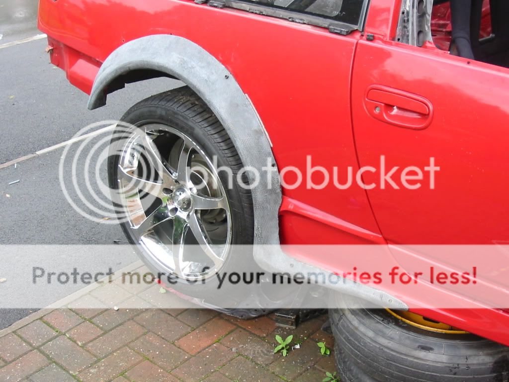

After test fitting the new wing we set about cutting the carbon overfenders to fit around the STILLEN side skirt and rear arch.
(These obviously aren't finished yet, but they are looking a hell of a lot better than they were)
This had to be done as the overfenders initially extended 80mm beyond the stock arch.
Which obviously would have required a rediculously deep dish and negative offset.
They now sit approx 40mm wider.

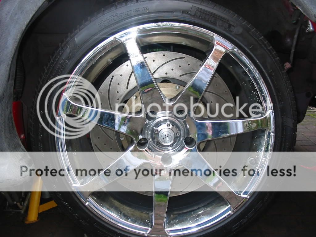

As it turned out, the set of 18" RAYS that I picked up from Jeff at ZEDWORLD; shortly after leaving DRIFTWORKS, fitted just nicely.
These rims were without doubt the biggest bargain buy of this entire build.
An awesome deal from Jeff with a few pints heading his way.
A full set of 18" RAYS (9.5J & 8.5J) fitted with 275 and 235 Pirellis, that fill the arches and fit nicely over the 380mm & 356mm discs
These will eventually go for a refurb and get painted (most likely in white) ready for track
*I'll be trying out a new colour scheme shortly to see if I can pull it off, but we'll see how that go's* :yes:
I'm not a chrome kind of person but I must admit that they did catch the sun quite nicely in the rain, which looked stunning (very much like Gram Lights)

Woah thats one big wing - I did spy it for sale on DW :thumbup1:
Glad those wheels from Jeff went to a good home, damn good price :bow:
You're right mate, they were an awesome price
It was good to eventually be able to get up to ZEDWORLD and meet Jeff in person
as we all know, he's a very genuine guy and went out of his way to stay behind and talk through my 'Z' issues
as for the wing, it really is top quality and I'm really impressed with it (though my wife is adament that it isn't sharing the bed with us for a second night running!)
It weighs only a 3rd of the previous wing (and I thought that wing was light!)

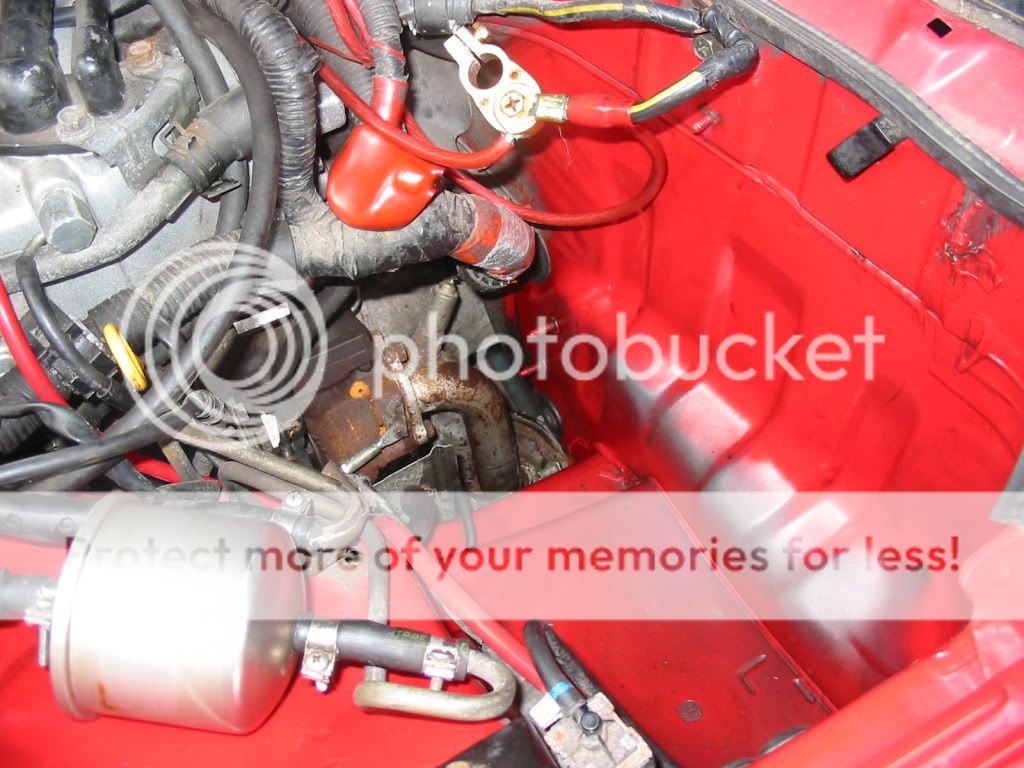

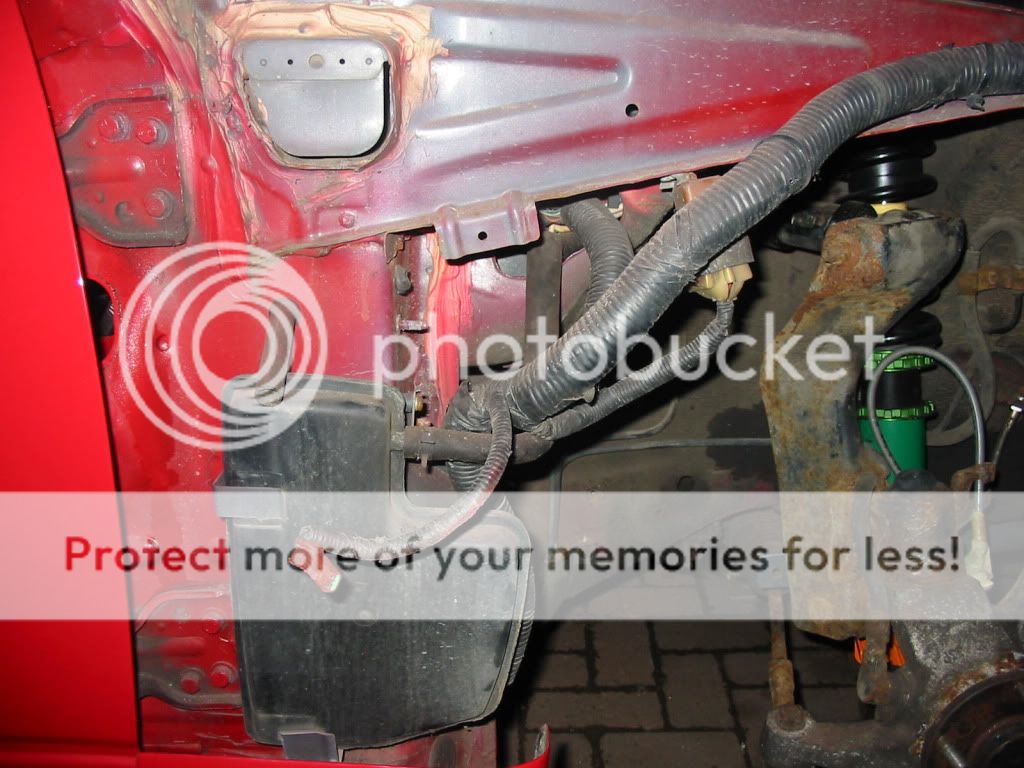

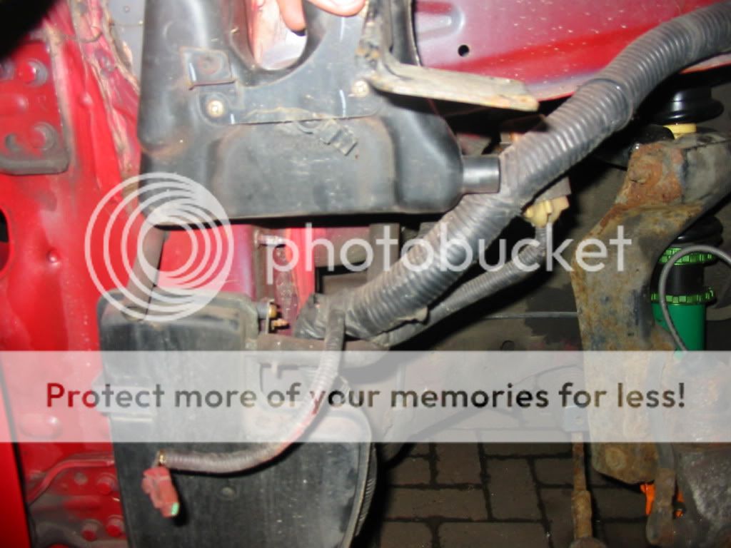

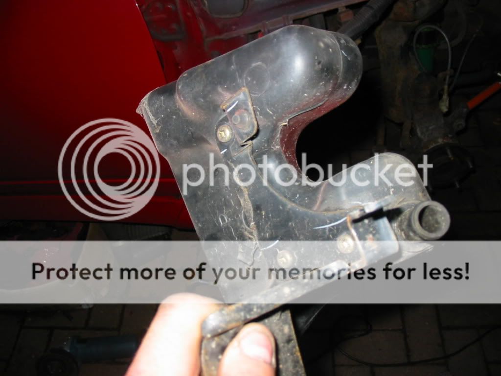

As the battery is being re-located to the rear of the passenger seat I've continued to de-clutter the engine bay, this time with the removal of the battery housing.
I'm considering using this space to relocate the right hand air filter, enabling a shorter air path to the intake for the right hand turbo.

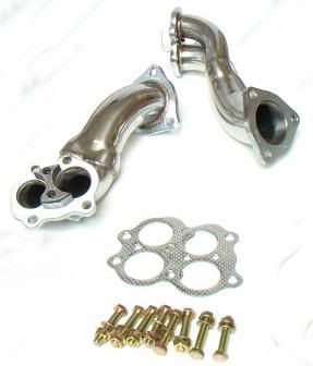

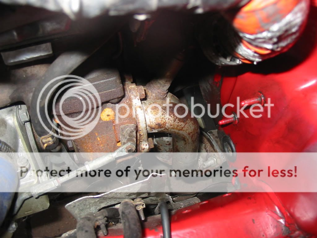

I noticed before that the Labree down pipes are looking a bit tatty (I didn't think that they would accumulate surface rust?), so they will both be removed in the near future, cleaned up, both sensors will be replaced with the Bosch UEGO sensors ready for connecting to the AEM AFR's and then each down pipe will be heat wrapped along with the custom side exits.

Hey up matey, thanks for the kind words and the wheels look good in place! looking at your down pipes might worth a look at these below, look very similar and nice and shiney too!! Janspeed is the make and very competitive price too, just might be quicker than cleaning yours up.
Jeff
Cheers Jeff, I'll take a closer look on their website this evening.

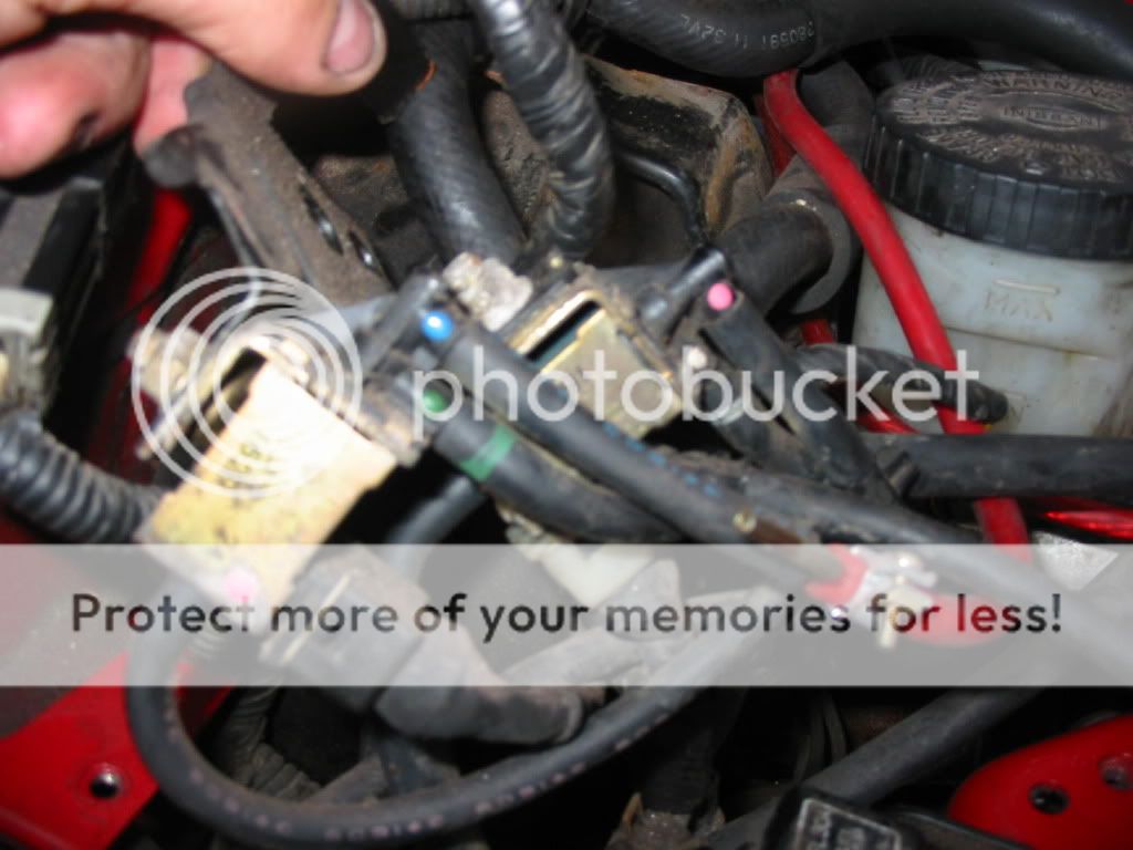

Just working my way through a load of obsolete pipes and connectors, trying to work out what's what, and what needs to stay.
There just seems to be a hell of a lot of random vacuum pipes that don't seem to be running anywhere and pipes with bolts plugging up the ends.
the 300zx on line manual is fine up to a point but doesn't go into that much detail (not to mention the diagram is of a LHD) just to add to the confusion.
I'm of the mind that if it doesn't need to be there then it needs to be removed.
I'm quite envious of the drift lads 'S' body engine bays, where there appears to be minimal clutter
Cheers mate, that looks a hell of a lot simpler
I've been offered a set of 20mm wider vented fenders from a guy in Japan so might take him up on the offer.
In the meantime I've removed the stock fenders to get better access to the inner arch.
I want to clean up some of the light surface rust and take the opportunity to get rid of some of the excess crap and pipework.
This for example wasn't connected up to anything and was serving no purpose as far as I could see; and to be fair it was bolted to a fairly heavy metal bracket so fits my criteria nicely of 'excess crap'!
Edited by jap.slapper
Just been checking thats your clutch vacuum assist tank not sure if its needed but should then connect to clutch diaphragm i would say.
The tank that I've removed sat above that I'm sure?
though could be wrong (anybody???)
Oh right yeah i just saw one pic it was there then another with a bit in your hand. That is part of the aiv`s then IIRC and can be binned :)
thats the clutch booster tank isnt it? Acts as a reservoir for the clutch servo :)
Yeah gotcha', I've updated the previous post to include the extra pic to save confusion.
you dont need clutch boosters cheif, I never ran one on mine, bin the lot :tank:
That sounds good to me bud
Will I need to blank off anything inside the engine bay to finish the job?
hmm, tbh bud its so long since i've seen a std set up i an't remember - my car was originally built in 2001 so it hasn't had one since then - but i'd think not, just remove it from the system, should be able to see as you rip it all out...? not much help that I know :whistling:
I'll take it out tomorrow.
