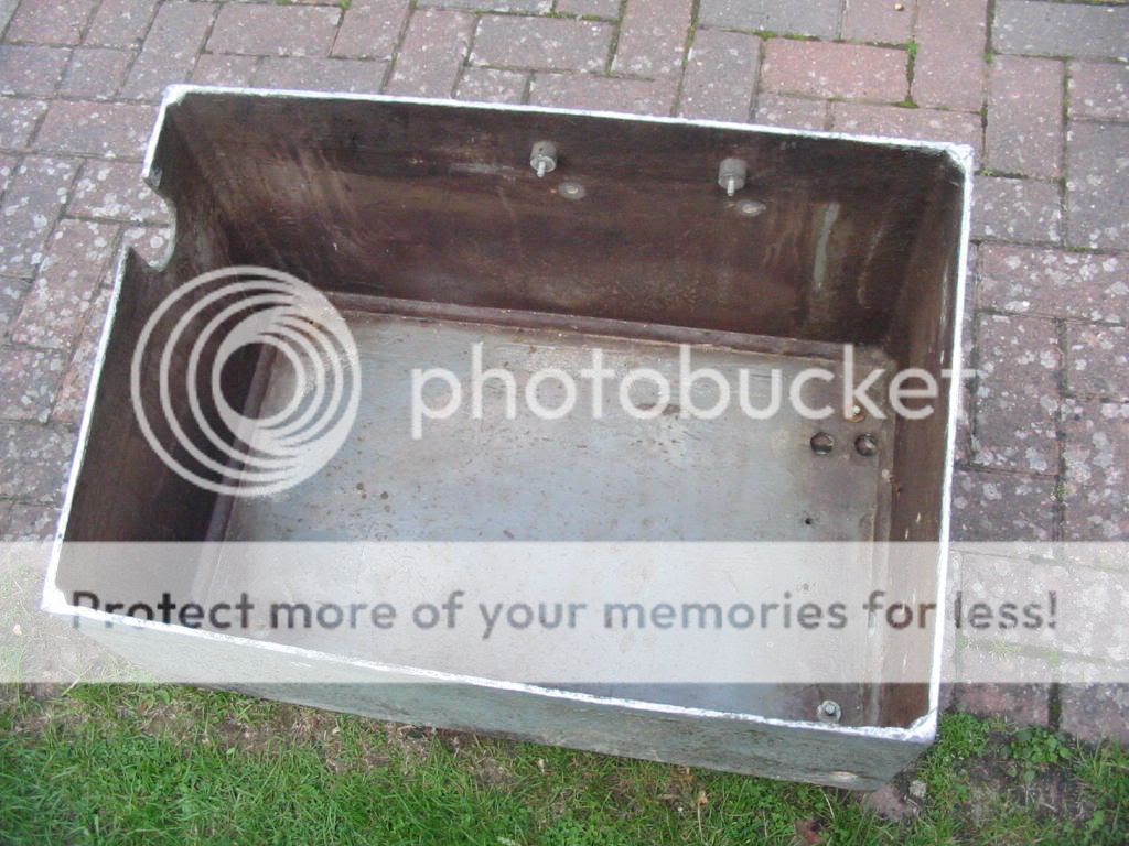

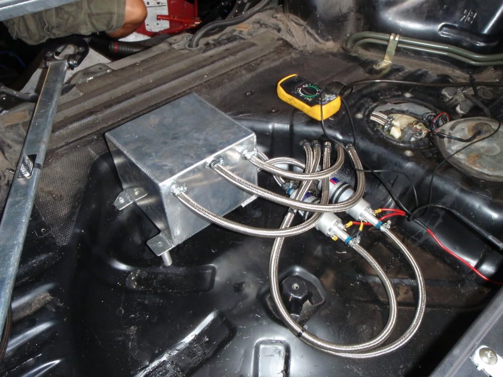

-Fuel system is currently being replaced with a 22 gallon US imported FUAL SAFE fuel cell with built in cut off & fire extinguisher system
-complete fuel system rebuild, twin 044 Bosch pumps utilising AEM EMS/fuel components, upgrading the NISMO 740's for larger injectors

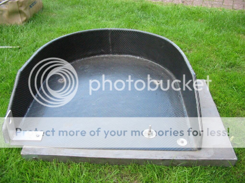

Carbon fibre overfender just tacked on to cut and prepare mould for custom carbon kit.

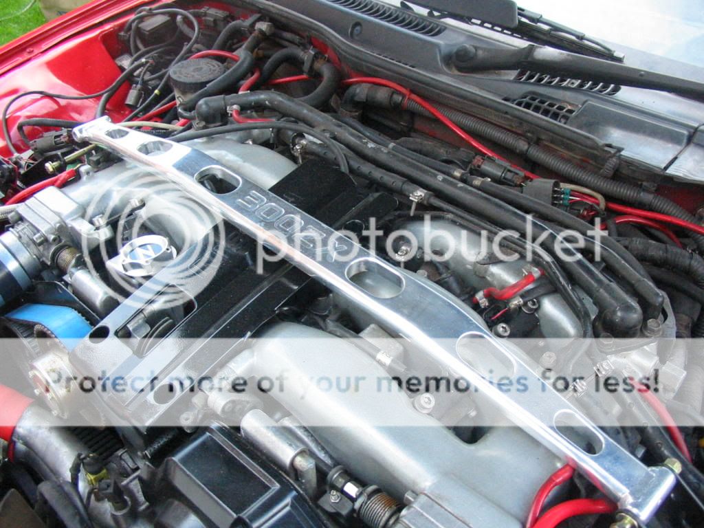

surely if the parts are advertised as NISSAN MOTORSPORTS parts, the customer is going to assume that the parts are genuine NISMO parts, so as you say, it's mis leading and surely isn't right.
Especially when you consider that the NISSAN MOTORSPORTS products are actually the most expensive that they offer at:
Though I can see your confusion, does it really matter? Genuine NISMO braces would set you back a damned site more than those prices I'm fairly certain. If it doesn't say NISMO on the page they wont be held accountable either, no matter how similar the labelling appears or refers to the genuine company. But more to the point, if it's a genuine motorsport branch which tunes NISSANS soley, be it third party or whatever, you're going to be getting a good product :yes: and the prices you're listing aren't that expensive for good parts.. try them out and see what you reckon before sending em back bro :thumbup:
I won't be sending them back mate (I imported them from the US way back in September '08 after all), it's just taken fookin' years and a shed load of cash to get my 'Z' back on track and be able to start work on it again.
This is just one of many costly f**k up's as far as the last 2 cars have been concerned.
I'm just a bit pissed off that they aren't what I thought I'd paid for.
To be honest in the wider scheme of things, this strut brace issue isn't really even an issue and they're probably the cheapest part of the whole build; just a kick in the swingers that I could have done without that's all.
Though I'm sure that they are well up to the job as they are still genuine Nissan parts
Here's a couple of pics of the braces:

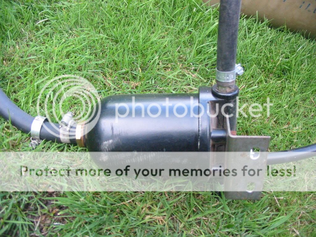

Barry had just removed it from his company Cosworth rally car and included some useful little extras in the sale.
Really nice bloke.
Simple plug and play

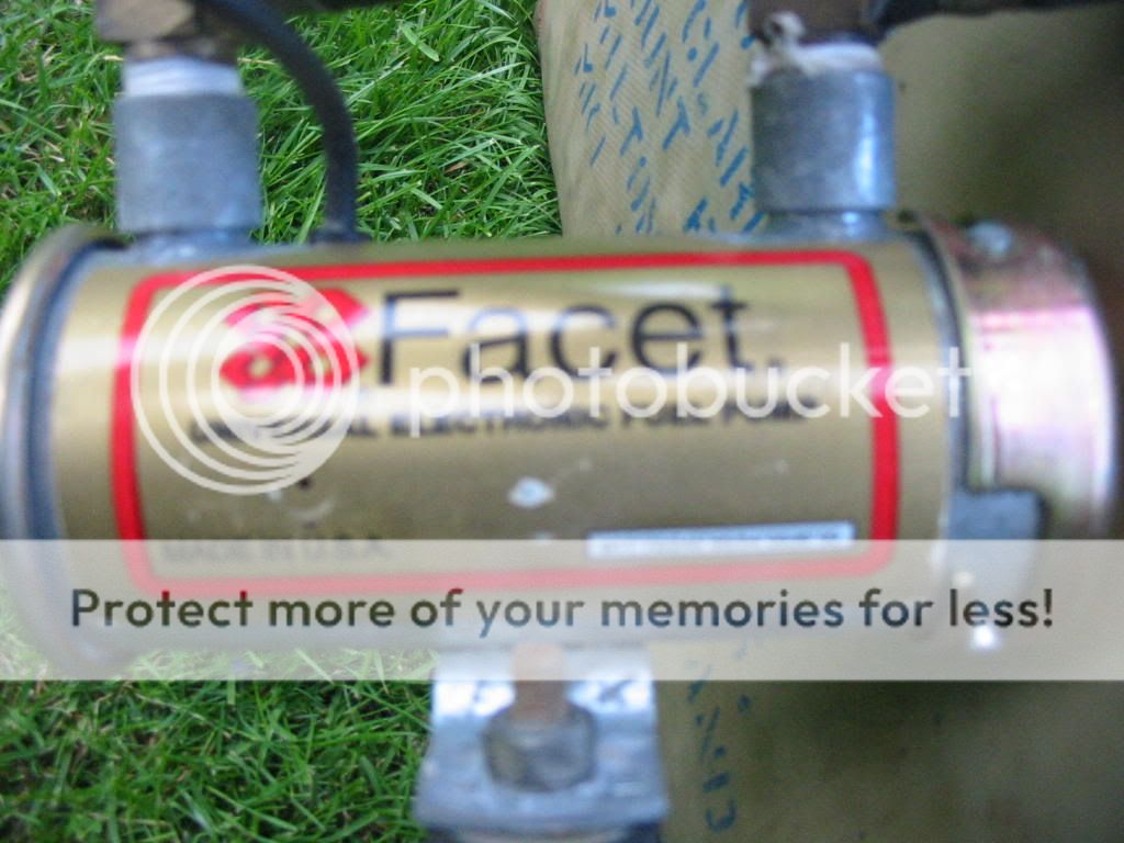

All I need to do now is source a new one way valve, a second FACET pump and fit a BOSCH 044 fuel pump....job done!
Looking at the strut braces - They are definatly more "Show" rather than "Go". Mainly becuase they use hinged bolts, which act as a pivot point.
They certainly look a lot sturdier than the majority of ebay and cheaper braces though, but inferior to a proper 1-piece solid Brace.
doesn't matter once it's caged up anyway as that will add more rigidity than any strut brace.

Ref the strut braces, even though when the cage is all welded in it shouldn't really matter, I'm gonna drop the company in the States an e-mail and whether I can get a decent discount on my next order (Carbing or similar maybe)

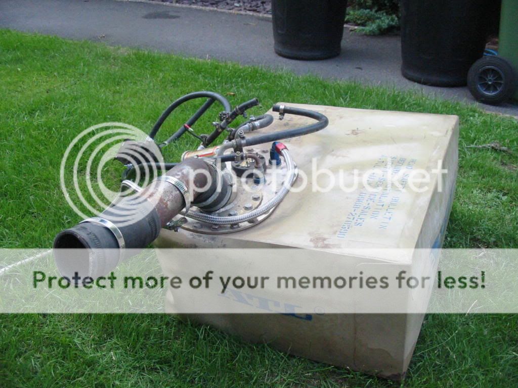

and with regards to the connectors etc on the fuel tank, anything that needs changing will naturally be changed, though the guy who ran it in his Rally car didn't report any problems.
I'll see what the guys in work have got on the shelf that can be adapted (at the end of the day if the hoses and connectors that they fit can survive an IED blast I'm sure it can handle a bit of fuel pressure and rough track time)

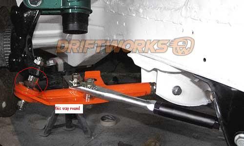

Hi unique zed, i have replyed to your thread on the aus forum, I have been reading alot bout your slot car and it has inspired me in many ways. :)
japslapper i have all these DW arms, I have to tell you something bout this lower arm, where the ball joint meets the hub you have to retain the little cone from your old arms ball joint you can press it off or just hammer it off. You fit it back in the hub, the cone on the dw arm must be turned the other way round so the flat surface is flush with the hub now that it has the oem cone in it. This way its a secure fit. The same goes with the front arms whatever you do dont go driving it with it the wrong way round as the ball joint will not have enough room to swing and you will damage the arm or maybe crash.
see pic below of front arm same applys with rear (couldtn find pic of rear):
Anyway i cant believe i have not spotted this thread yet, very impressive and costly project here :) we should all meet on the track soon :) im looking to book another trackday at bedford autodrome soon if your interested let me know, same goes with you monster :) you can bring the skyline alone for testing.
Edited by j1mmytt

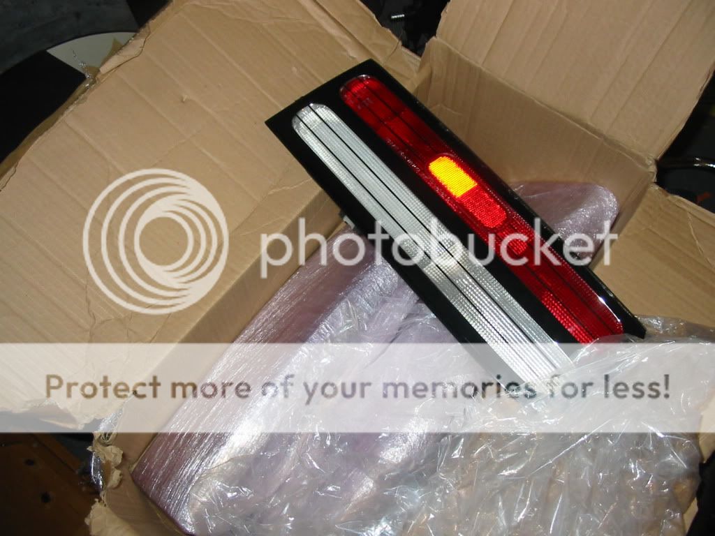

Not much to report in the way of progress other than, the 99 spec rear lights that were kindly supplied by ZEE a few weeks back, will be fitted very shortly.
These will replace the ZCENTRE lights currently fitted

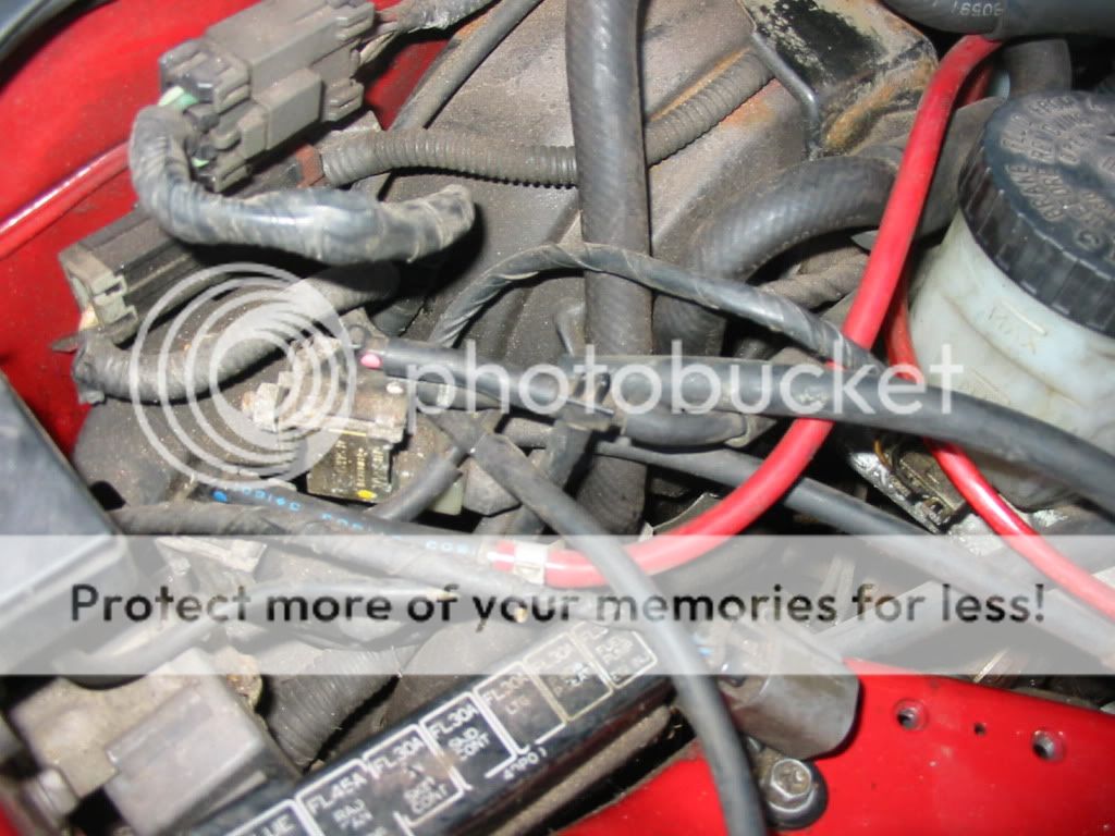

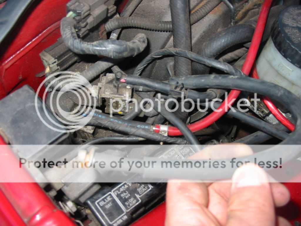

and I've been working my way through the mass of seemingly endless pipework in the engine bay.
A lot of it either isn't connected to anything or has simply been plugged with a bolt?
any suggestions on what's what?
